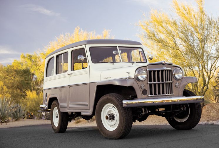

  1. I remember back in the late 50's my favorite Aunt had one of these wagons. Her and my Uncle were big into fox and raccoon hunting and they would pack about 8 hound dogs in the back and stay out all night long just listening to the dogs chase them. They could name each dog by its' bark from 1/4 mile away. Always amazed me. My Aunt also had a beautiful two-tone Blue '56 Coupe deVille with factory air. I loved that car, but it seemed like every time she would pick me up she would be driving the Willys:(. The kingpins were TOTALLY shot and on dirt or gravel country roads that wagon would bounce around like an over-inflated basketball! CC177-FEAT1-01.jpg

    Willys 4x4 as well as other straight axle 4x4's do not have king pins . the have tapered roller bearings on the spindle ears so the drive axle can pass through.Worn or out of adjustment bearings usually cause the dreaded death wobble...

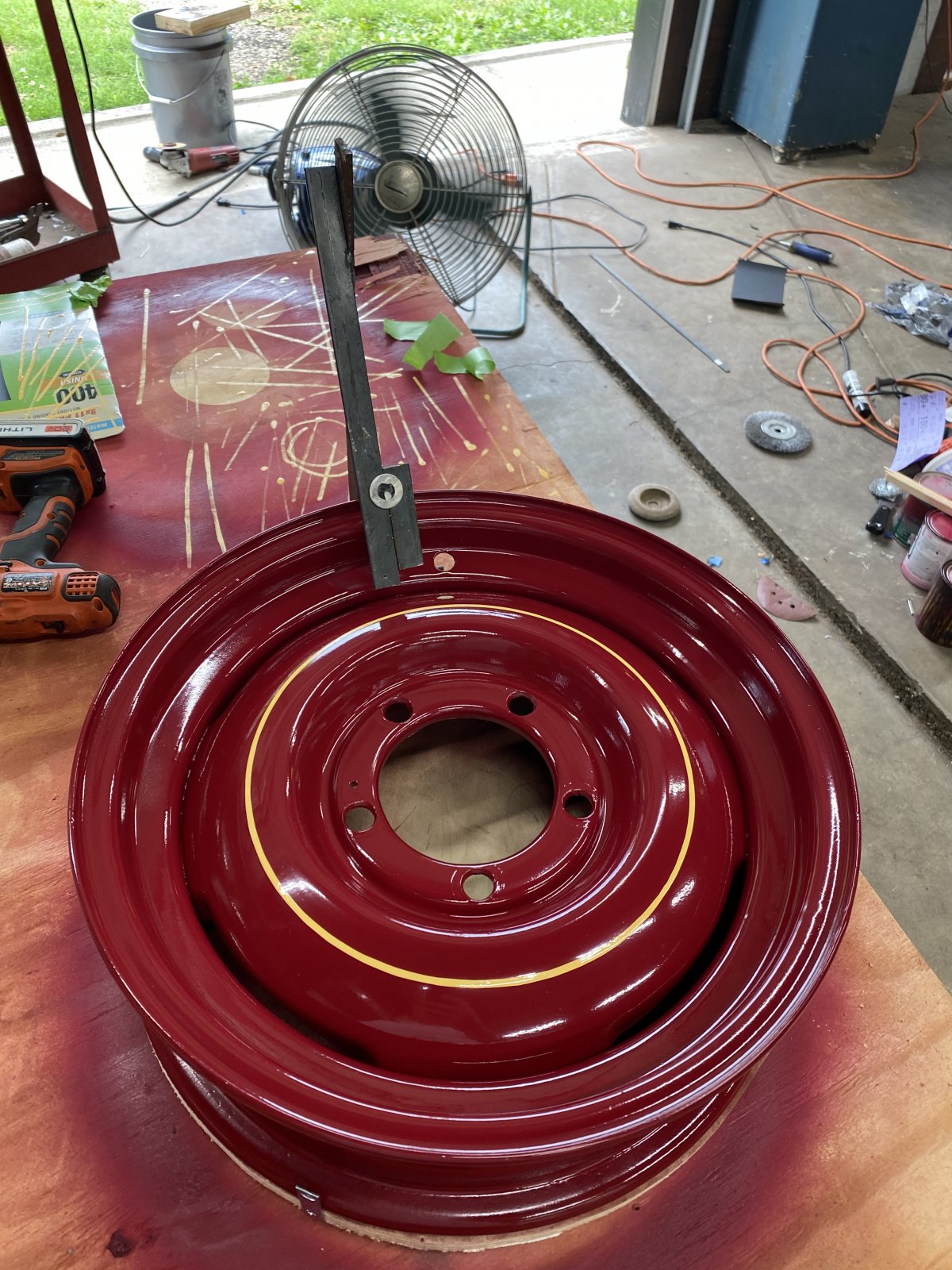

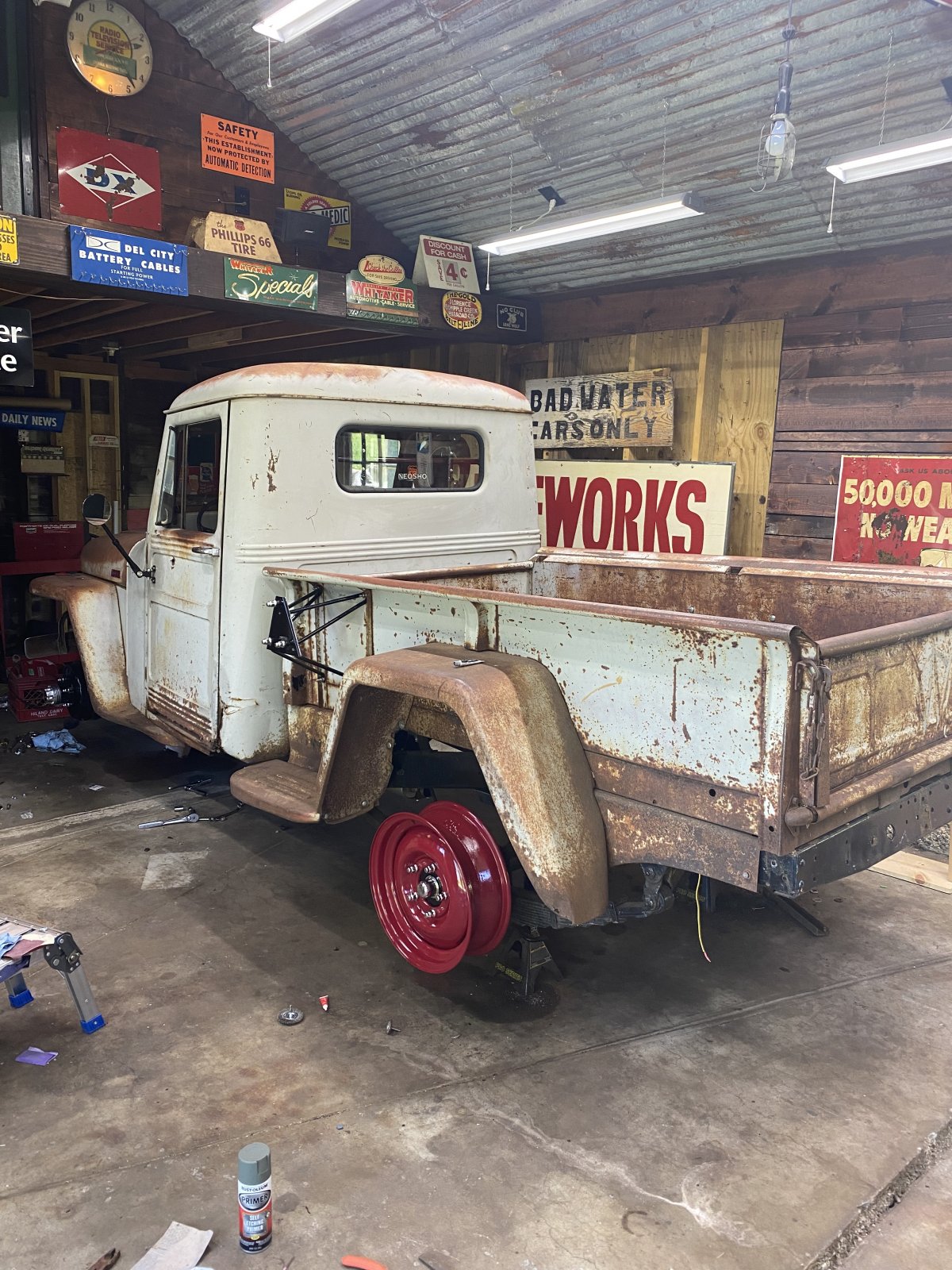

    Mine in progress. Getting it useable. F8F0E106-D3E9-4E82-BC34-B0B43B30460A.jpeg 60287D89-B827-4855-8E46-EA9B3BF980E2.jpeg 09F7D5E7-D735-4395-BC06-AABF2F6B0737.jpeg

    @CAL , those wheels with the extra little hole are for the military, so says my M38 book. Story goes that the hole was drilled to make it easier to tell the army wheels from the civy wheels. The military wheel also has safety ridges to hold a low tire on the wheel, and according to the book the civy wheel did not have them. The book also shows that during the production of M38's, the pickups and wagons were built on a line next to the M38. 1950-52 is M38 production, not sure what went on at WO after that. I just mounted new NDT tires on my M38 with those wheels, and mounted them tubeless. No leakers so far. nice pickup !

    Thank you, and that’s very interesting about the extra hole. All four wheels off the truck had them, and I bought one off eBay for a spare which also has it.

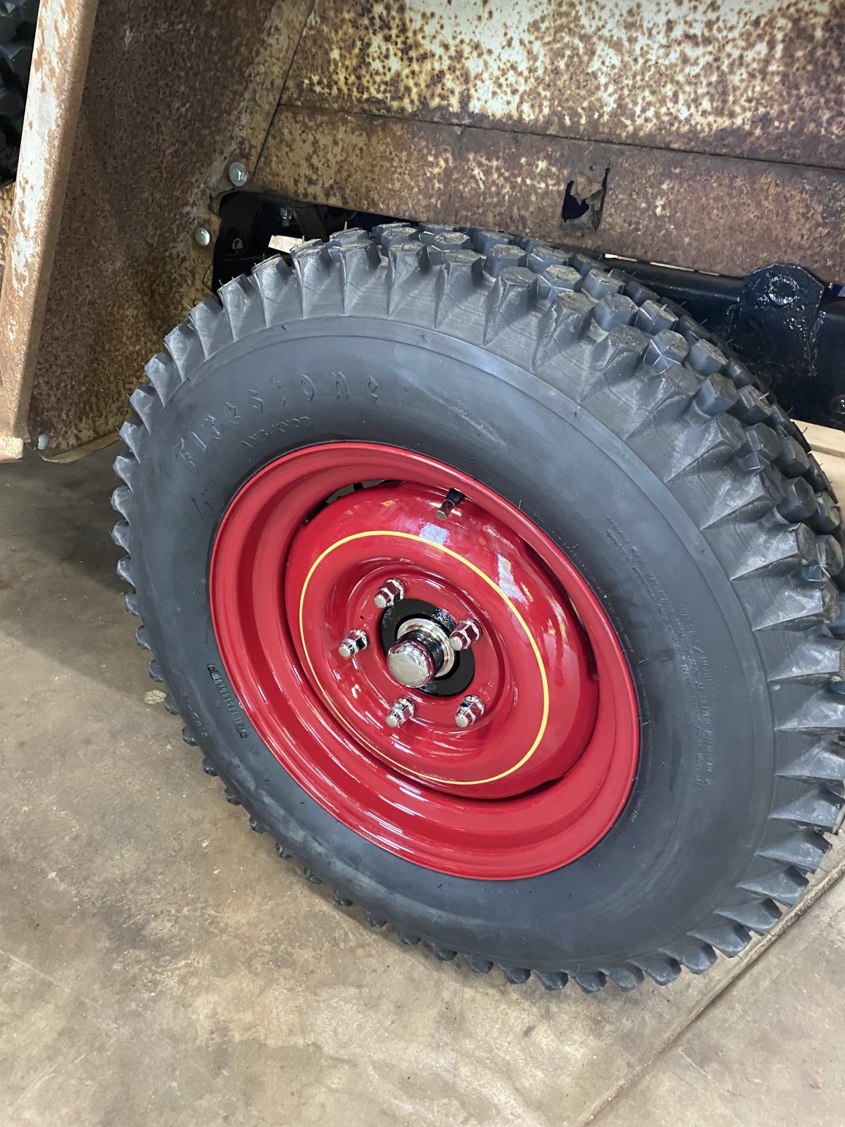

    Got the new tires mounted. Starting to get there.
  10. rusty valley
    Joined: Oct 25, 2014
    Posts: 3,885
    rusty valley
    thats a good looking aggressive tire! did you go tubeless?
  11. CAL
    Joined: May 5, 2005
    Posts: 396
    CAL
    from Neosho Mo.
    Thanks! I went with tubes.
