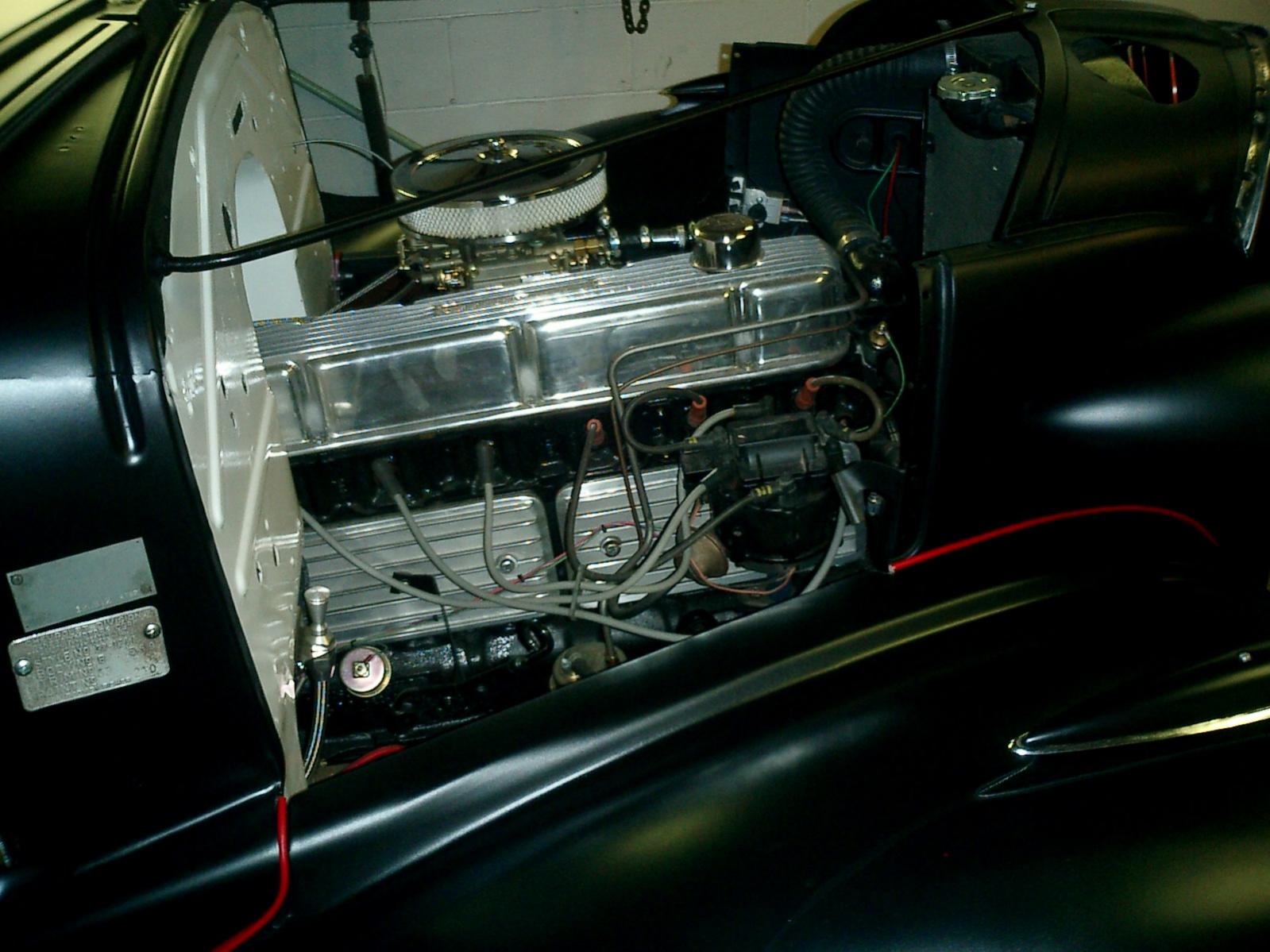

    292 in a 37 chevy. recessed the firewall and running an electric fan. it's easier to put one in a 49-54
