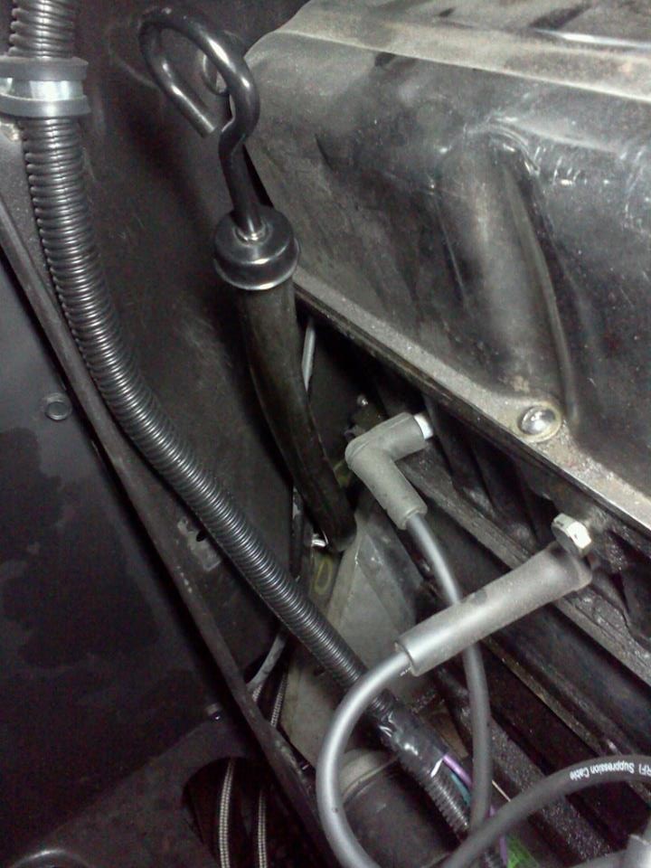

    I have another question regarding my 235 to 350 sbc swap in my 54 Bel Air.
    Currently I still have the 235 in my car, but I mated a TH350 to the motor via a Stovebolt adapter plate on the back, going to an open driveline, to an S10 rearend.
    The motor is sitting on its original motor mounts. However, I had to have a custom transmission cross member and mount made to accommodate the TH350, as well as enlarge the transmission hump.
    Upon closer inspection I noticed that where the 235/adapter plate mate with the TH350 seems to be pretty far back in the firewall.
    As you can see in the pic, the adapter basically is in the same shape as the back of a V8 so that the TH350 will bolt to it.
    I do realize I will have to cut out the ribs on the front of the firewall, which is no big deal and that a V8 is considerably shorter and will sit lower than an inline 6.
    My question is this, will I need to bring the TH350 further forward in order to mate up to the back of a V8?
    Any info would be greatly appreciated.

    How much MORE work do you really want to do? Why not just use one of the later style 194-215-230-250-292 six cylinder engines. More power than the 216-236-261 six, no firewall work needed, no need to move the parking brake, and with the right exhaust, it'll sound better than a V-8. The radiator will need to be moved to the front of the core support. It's hard to tell in the pic if the trans will need to go forward, or if a V-8 will fit into the space if you don't. I have't heard of anyone having to modify the floor hump. Butch/56sedandelivery.

    You will have to move the transmission forward. I recently did a SBC/700R4 combo, in a '50, and managed to get it completely under the stock floor with only a hole in the inspection cover, for the shifter. You should be able to get the TH350 under the stock floor, too. The radiator is in the stock position.

    i just got fininshed with v8 5 speed install and had to move the transmission forward . i had the 235 5 speed to a s10 rear. thought i could bolt motor to transmission and be good. found out it hit the firewall. i moved everything forward . measured where the mounts go for engine and found out the transmission was sitting back to far.
    measure where your mounts go for engine then measure how far back to bellhousing on trans. that should tell you where the trans will set.
  5. It's a lot easier to saw off those ribs than it is to mess around moving the radiator ahead - it's easy to get about an inch with one by sliding it in on the front side of the cradle fins, more than that and you run into clearance issues.
    As for moving the trans, it depends on where it is now, which isn't that clear from the photo. If the front of it is ahead of the middle recess, then no, if it's behind the flat portion of the firewall, then yes. When I put a 350/700R4 in mine, it cleared everything but was a tight fit at the firewall.
