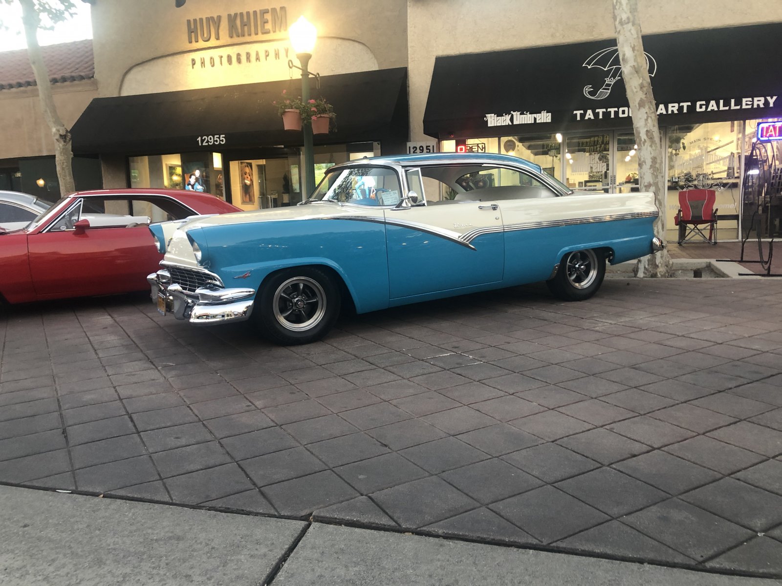

    artooks…the 56 in the photo has American Torque Thrust D’s 15x6 with their standard 3.66” back spacing front and rear. Tires are 215-75’s in the rear and 205-75 in the front. AeroStars are in the front.
    American TQ’s 7” wide have a 3.76” back space. That’s 1/10 of an inch on the back so the rest 9/10’s of an inch on the front.
    The rear end is an 8.8 cut to stock width with drum brakes. There is room to remove the rear tire IF THE BODY IS JACKED UP. I carry a scissor jack for the axle and the stock bumper jack to get the body up. The problem is the widest place on the tire clearing the inner fender opening lip to the brake drum. I WILL NOT CUT the inner lip for a tire.
    There are NO rear lowering blocks. If I had discs on the rear I’m sure 7” rims or wider tire could be used. It also has the exhaust thru the bumper which swing over by the tire.
    When it’s on a tire or lube rack the shackles will reverse and if I’m going to where one is I bring 2 pri bars to use when the lower the car. NO ONE has any idea what to do and I need to be there to do it or show them.
    I’m a rolling resistance guy . . . .skinnier is better so that why the 75’s E64A1336-A834-4265-B248-80A54A0ACCC5.jpeg

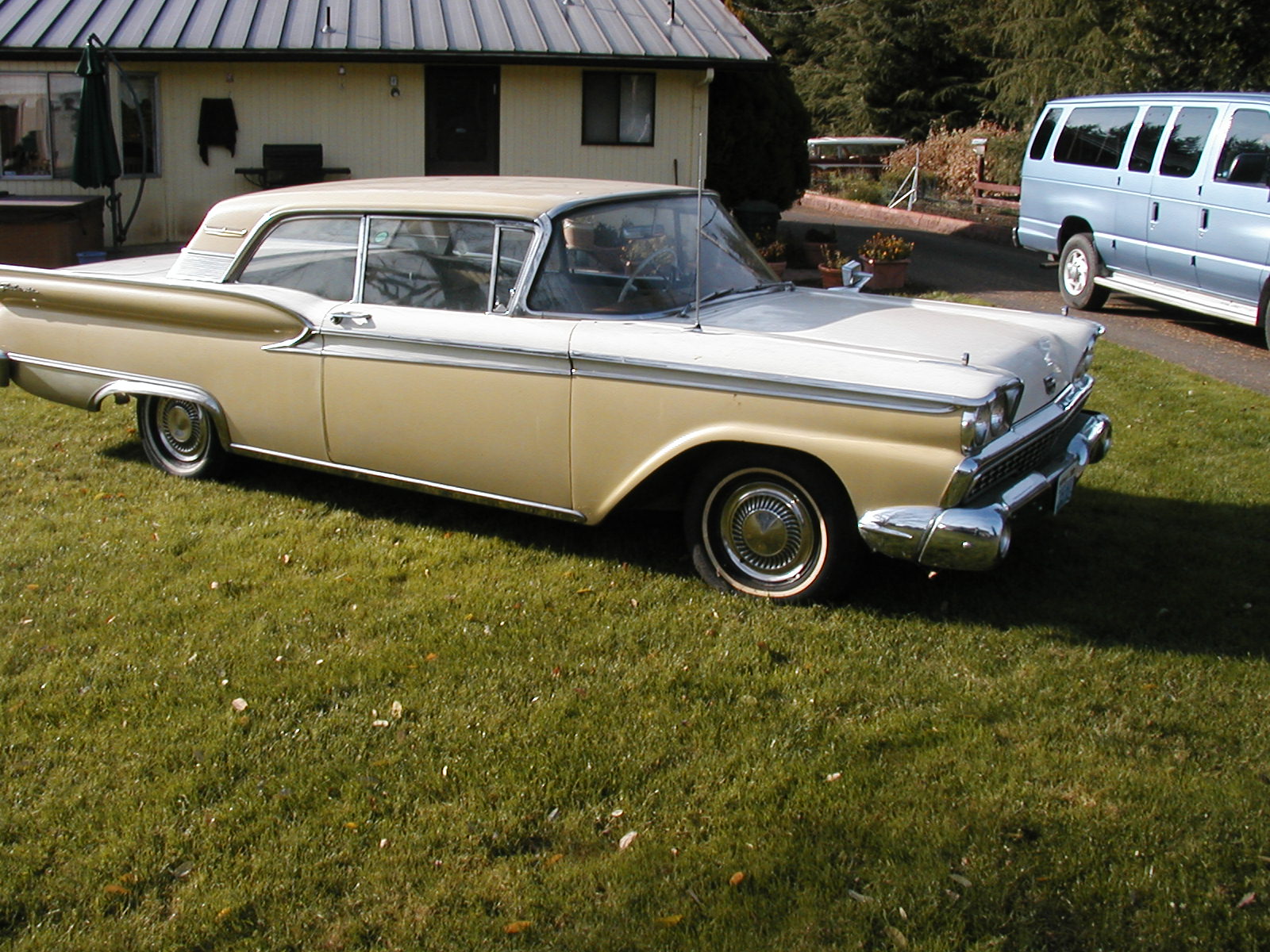

  16. As Steve said and why I say get out a Tape measure. Axle width is just one part. I have found as much as 1/2" width variations in wheelhouse space as well as 3/8" off set from Center of wheelhouse in these Cars. When messing with 1/4" space you must know that the tire is on center on Both sides of the car. My Virgin never been apart or bumped 59 Ford has the Body 7/16" closer to the Axle flange on the Driver side and the passenger side wheelhouse is 1/4" narrower overall than the Drive side. I don't think it's all that uncommon. That will really Screw you up if your working with a 1/4" space.
