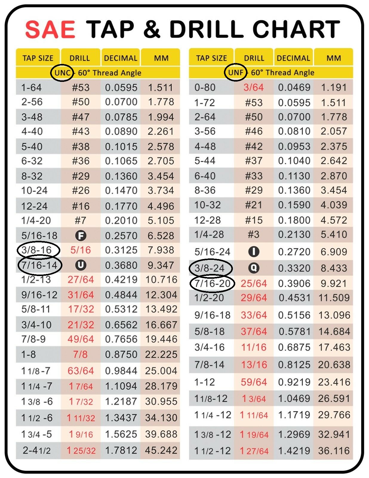

    Simply taking the bolts that do thread in freely and trying them in the holes that don't screw freely tells you if there is a problem. Threads do get grit and rust in them as well as getting deformed. Running the correct size tap tru them should clean it out. BUT.......it is possible that someone didn't have the right bolts on hand or mistakenly ran a metric tap thru the hole. I would try a metric bolt and see if it does work, just to see if someone screwed (pun intended) it up. At that point you have to decide whether to stay metric or attempt to return to American Standard threads. Either choice may not have sufficient metal left to hold a bolt. You can only try it to see what happens. If its weak or stripped at that point move up to a 7/16-14(coarse thread) (Fine thread is 7/16-20. Use coarse. Drill to appropriate size before tapping with the larger tap. Probably need to enlarge bellhousing holes. Also, don't forget to check bellhousing alignment. Its much easier to do while the block is on a table rather than installed in the car. Simply put the cran in using old main bearings and bolt the housing in place. Then indicate it and see if you need to change to offset dowel pins. And last, make sure the bore in the housing is the correct size for your transmissions front bearing retainer. Chevy had two different sizes and you "have to have" the correct size.
    Tow Truck Tom and Hellfish like this.
