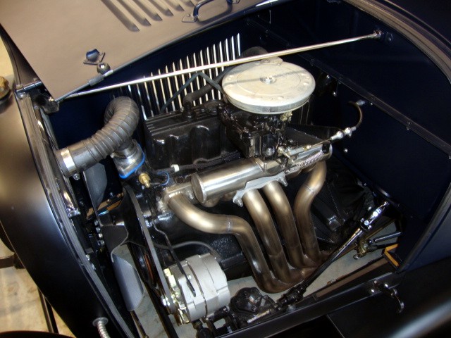

    Muffler is a stainless "turbo" style but a shorty. I swear it's getting louder every time I drive it ... that's why I'm now building an interior for it ;)
    Thanks for the compliments!!

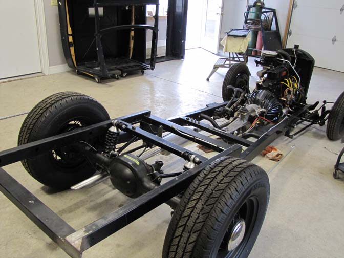

    I found a shot of the chassis, and if you look real close, you'll see the muffler. And yes, I have an S-10 5-speed behind it.
    kidcampbell71 likes this.

    as lance posted it is a 5 speed BW t5 from his old s10 chevy pickup. we had some problems with it being to long in the nose area. the TO bearing collar hit the disc.and input shaft locked in the crank shaft. , the input shaft splines didn't allow the disc to release,
    a few old timer tricks. i learned from working with the late pappy hough from the former gasoline alley in patterson nj. a grinder, dremel and some files and we got it to work with out a spacer plate.
    it wasn't hard but what we did and how to get the clutch to release took about a hours work, the tricks we did is up to lance to release

    The stock marine cam is still in my engine. It has specs of 204 duration @ .050 lift and a valve lift of .498 with the 1.75:1 ratio rocker arms. The listing in the Isky cam shaft web site, for the Nova 153 inch motor, shows this cam has specs right between Isky's first 2 street cams which have durations of 202 and 208.
    Right off the top of my head I don't know exactly where the RPM range of this cam is, but it's something like 1400-5500 optimally. It's got a nice subtle overlap and revs up quickly.
    I figured I couldn't hide the fact (noise wise) that it's a 4- banger and I sure didn't want it to sound like a TUNER, so the combination of cam and muffler worked out in my opinion.

    the stock marine cam is ground to provide horse power in a 1200 to 4800 rpm band and torque in the 1200 to roughly 3800 rpm band. they will rev out to 5500 with ease.
    with the gearing lance choose. trans and rear, on the street it seems to be dead on perfect. he doesn't need to give it a lot of gas to get rolling, meaning one can roll into the pedal like any normal every day car, but if banged on ,it breaks the tires loose at will.
    again here are the link from gm on the marine engines specs
    http://www.gm.com/vehicles/innovati...s/specialized/marine/REV_2011_3000_Marine.pdf,
    industrial model specs
    http://www.gm.com/vehicles/innovati...lized/industrial/REV_2011_3000_Industrial.pdf
    take note here, if one uses a fork lift,generater,field water pump ver. of this motor, the cam shaft is ground to provide it's power at a max of 2200 rpm. while it has a higher compression right from the factory, "9.2 and 10.5 "as it runs on propane or natural gas. it's high torque low rpm cam is worthless in useage in a street rod. one most change the cam to a marine grind and use rocker arms that don't push the valves into the pistons.
    i do know for a fact the true flat top pistons with 9.2 to 1 compression clear the valves. i used these in building lances engine and they are used in the volvo and 2 other brand marine engines .I DO NOT know if the 10.5 to 1 slugs allow the valves to clear the pistons when useing a higher lift marine camshaft just yet, as i have still not seen one of these pistons.
    the main advantage to a fork lift motor, either right out of a lift truck or as a crate motor is the use of factory stock cast iron manifolds that allow a one barrel carb to bolt right down and a simple old style single down pipe for the exhuast. if one finds one with a 6 port head the 2 and 4 barrel intakes from clifford fit the head.
    if one wants to make a header stahl headers makes the flange and header kit, beware it is costly.
    http://www.stahlheaders.com/Frame%20New%20OT.htm
