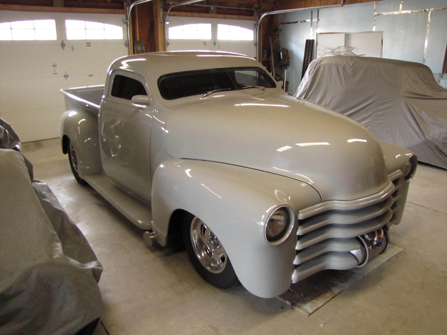

    Here are some shots of the '48, tucked away for the winter with the rest of the gang. Not great shots but you get the point.

    Thanks for the pics of the 48 truck. That is a radical chop!! Looks like a custom bed as well. I like the '37 Ford taillights. I am running them on my truck as well. The double lower grille bar is a neat custom touch. I have never seen that done before. What bezels did you use to french the headlights?

    The bezels/headlight rings are Chrysler Cordoba from the 70's. I believe Monte Carlos will work also. I used the entire guts of the Cordoba as well as the rings to make it work.
    Bed is flat stock with the rails slightly bowed and made from exhaust tubing. There's barely a square edge on the bed. Lots of work and it took the better part of a year to create. I'd love to take credit for it but I designed it but didn't build it. My friend Kenny Acheson is the master metal man there.
