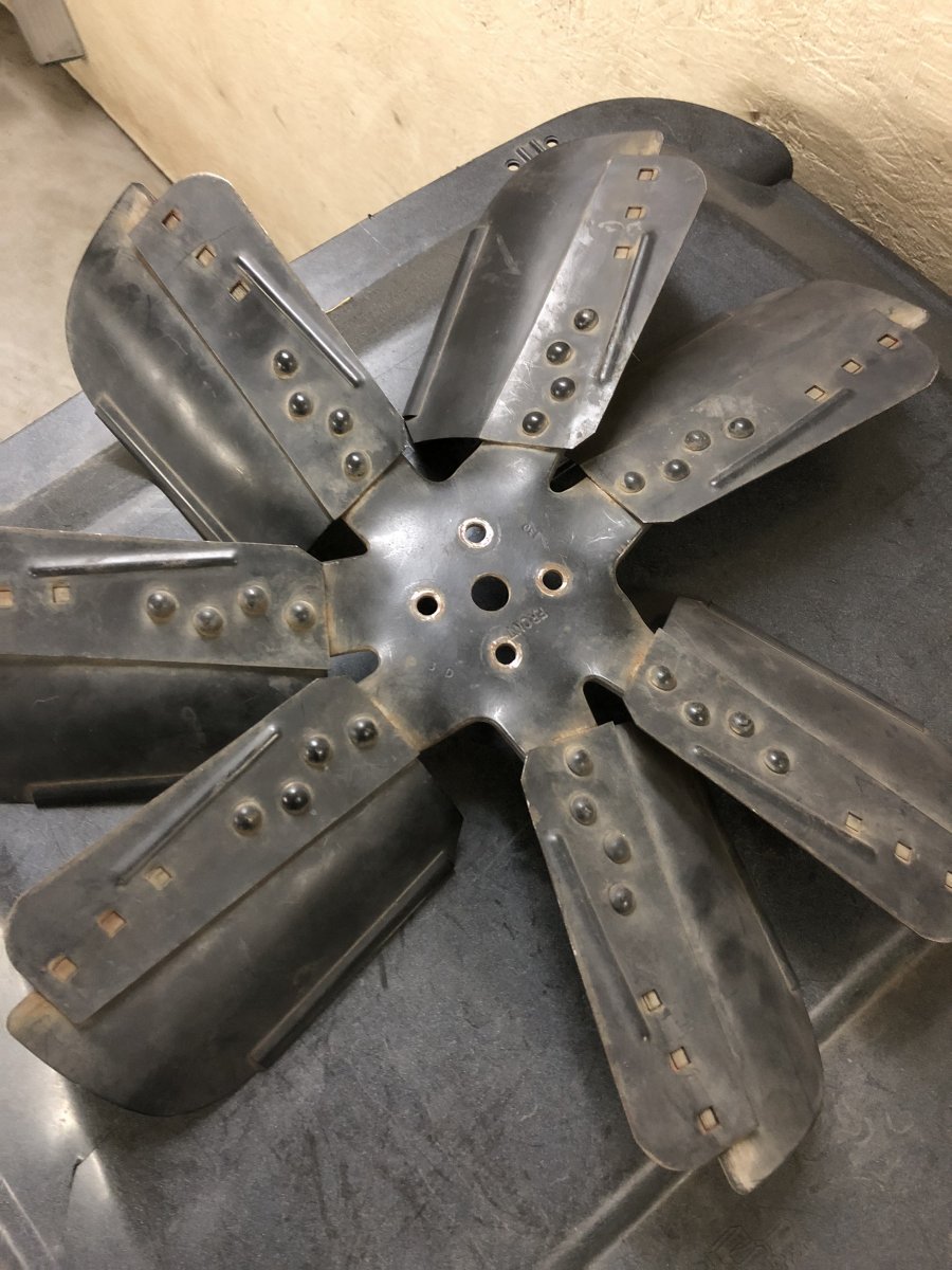

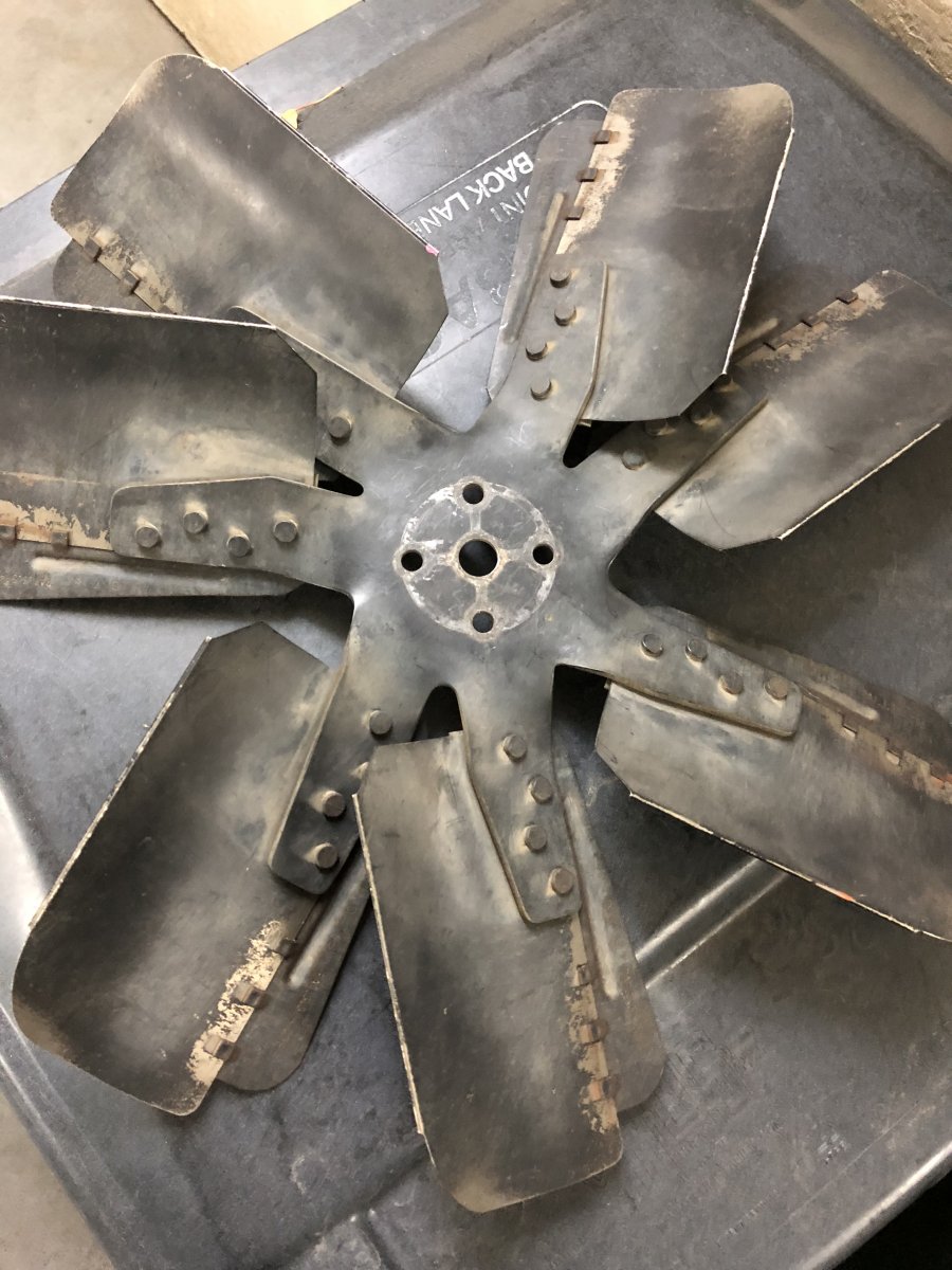

    7ECD3A62-9719-4EFB-8E8C-9536CD42B637.jpeg CA65CBB2-DD1F-409C-A8D6-CD8DF4DDF51D.jpeg I love this fan, its large and does a great job of cooling my sbc, but at low idle it clicks and snaps, which is super annoying.
    I tried another that is a 5 blade and same style, but it does the same thing!

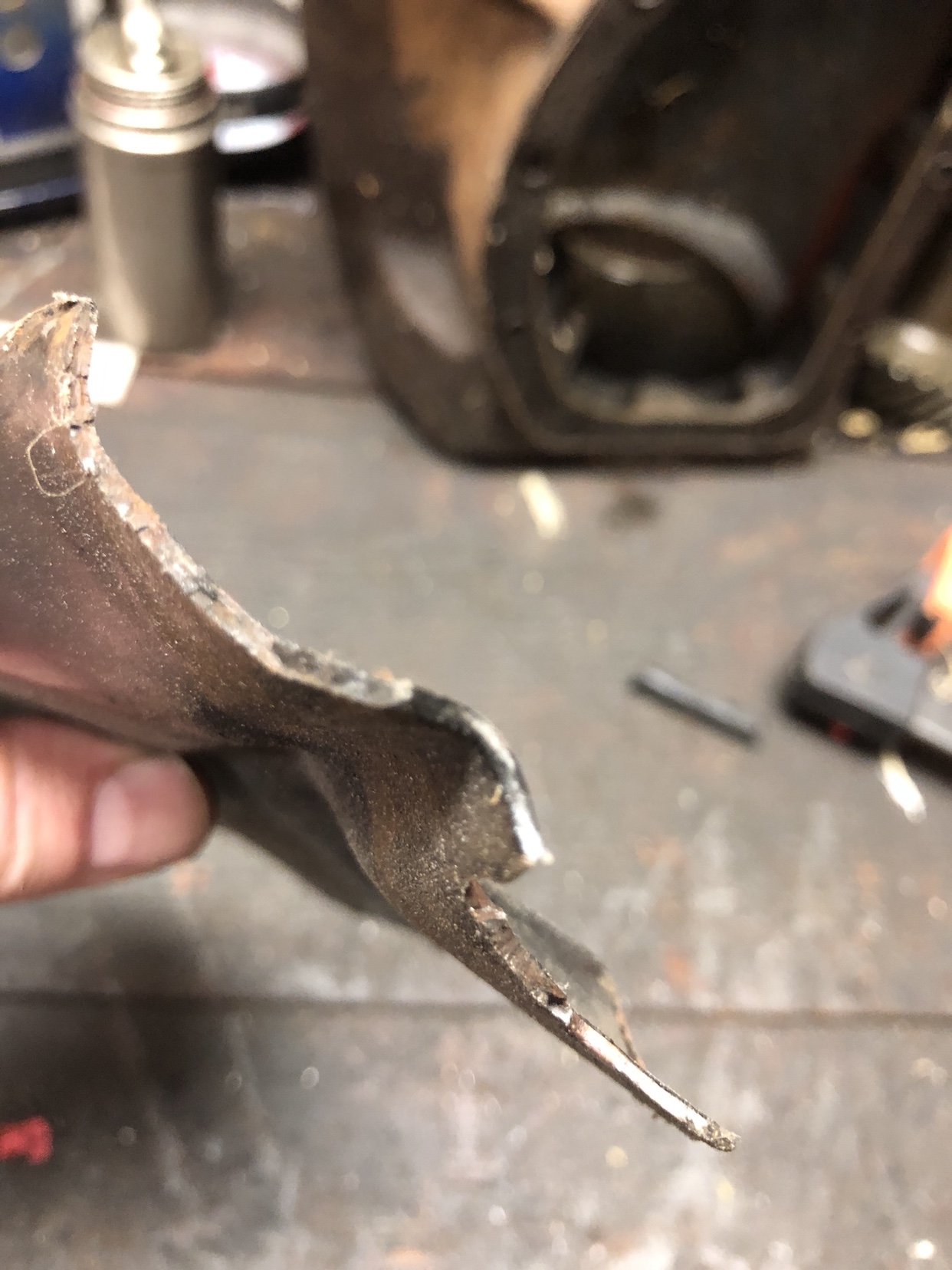

    It probably had some slight damage at one point, or was maybe just plain defective from the factory. Maybe a tiny crack in the stiffening rib, and the cyclical flexing of the blade due to changes in RPM caused it to expand that crack until centrifugal force overcame the integrity of the uncracked portion. Id like to see a close-up side view of that break immediately after the blade separated. It would likely tell the story. But the photo is six and a half years old so that forensic evidence is probably no longer visible.

    I just changed it to a 19” like the broken one pictured above.
    I didnt find anything visually wrong with the other two.
    They came off of 80’s chevy trucks, ive never heard others having problems with them.

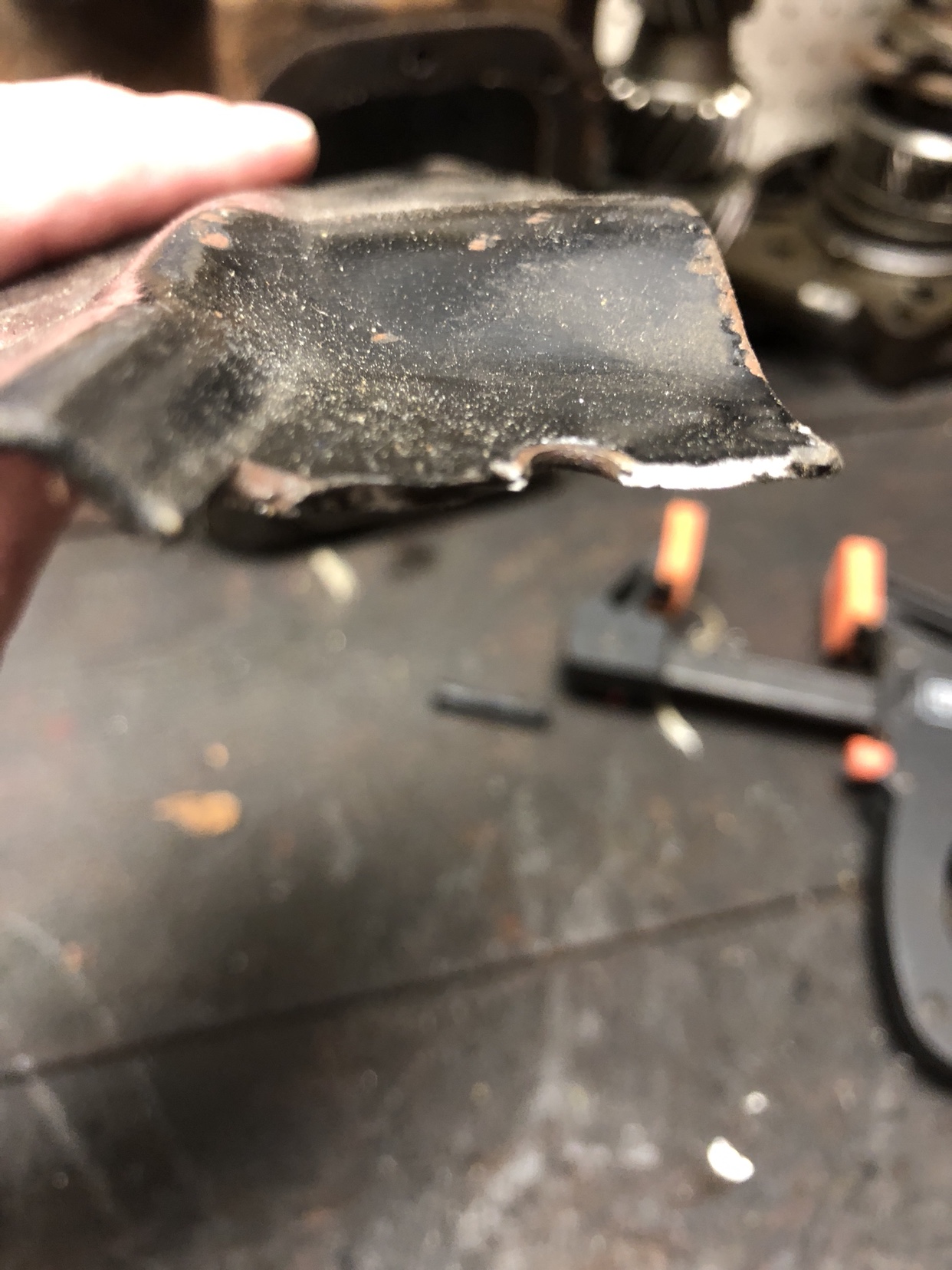

    After closer inspection it clearly started at one of the rivets, there was a small amount of rust in a section of the crack near the suspect rivet. None of them were loose though.
    Adam

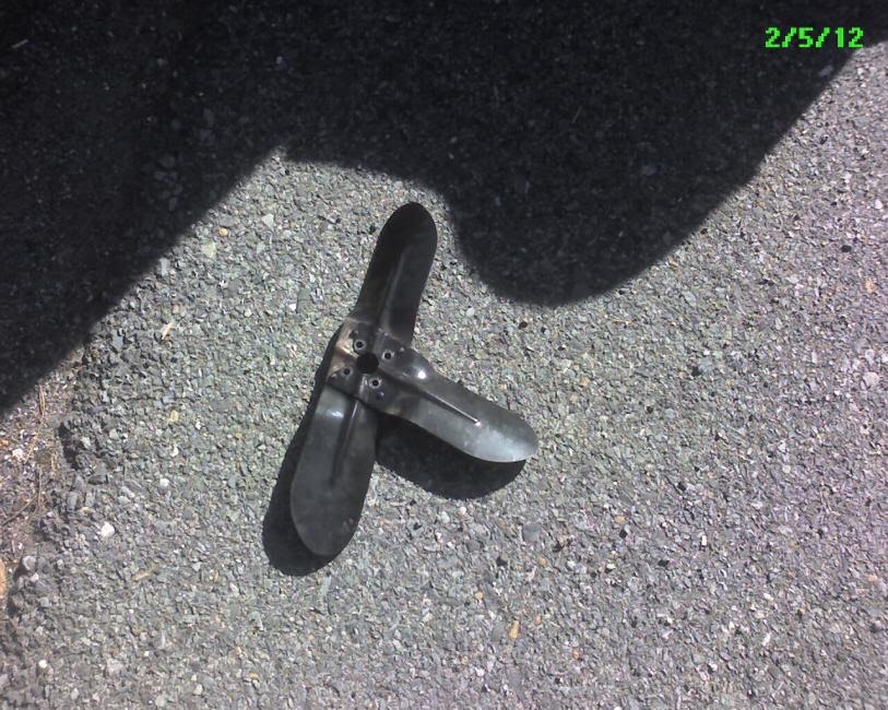

    Here you go. This thing let go at about 4000 rpm getting on the freeway. It made such a noise and of course vibration I thought my little flathead let go. I went back to get the piece and that’s all I have now.

    Were these pictures taken recently, or right after the fan broke? Parts of the break show rust on the crack, and other parts look shiny. It looks like the crack may have started right at a rivet hole.

    About an hour ago, 6 years after the break. Yes, it appeared to start at a rivet hole.
  28. oldrelics
    Joined: Apr 7, 2008
    Posts: 1,729
    oldrelics
    from Calgary
    no room
  29. oldrelics
    Joined: Apr 7, 2008
    Posts: 1,729
    oldrelics
    from Calgary
    the third non-flex is fine, no noise

    I had the same fan as "work in progress" had on my '65 impala, back in '72 (stock car) I was getting on to a highway, and I heard a load noise, and then a vibration. My fan had thrown a blade, and it stuck into the lower tank. I wiggled it out. The tank never leaked either. So it doesn't need to be a old one. Mine broke the same way.
    Pat
