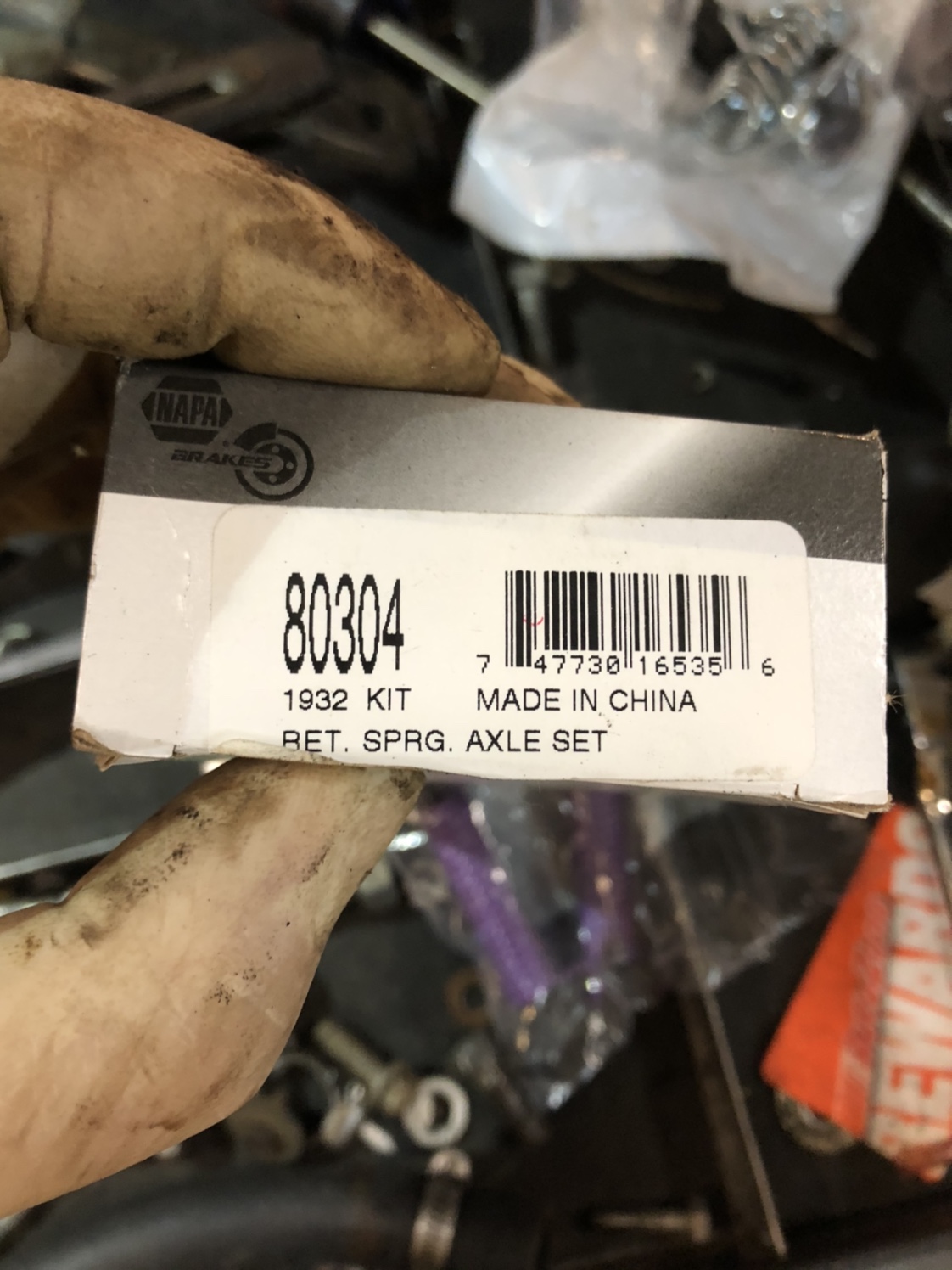

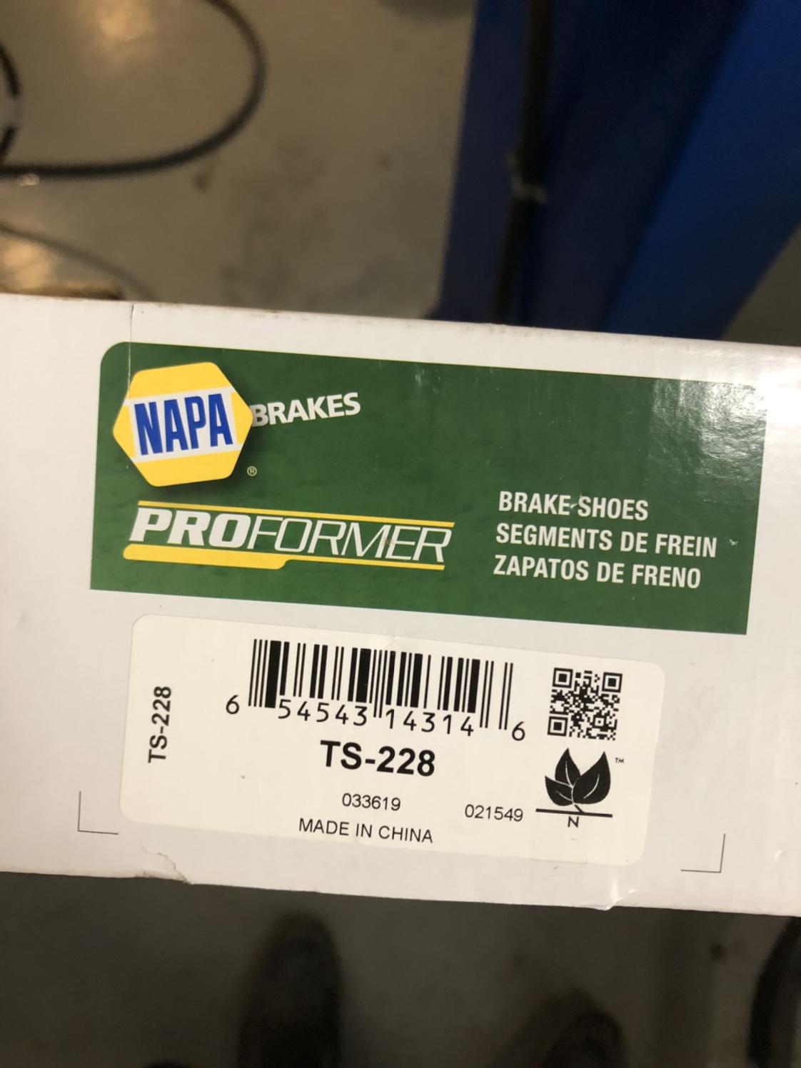

    So I got out in the shop and got the drums off. Like I said previously, the rear two wheel cylinders were totally wiped out. A call to my local Napa secured all of the parts I needed; wheel cylinders, shoes, hold down hardware and return springs. I’ll include pictures here of the part numbers if anyone needs them for reference.

    Everything else was cleaned and lubricated. The rear lines also snapped off when I went to remove the wheel cylinders, and were replaced with Nickel Copper lines.
    [​IMG] [​IMG]
    Today I bled them out and took it for a spin around the neighborhood, and the brakes seem to be working as they should. A great success, and a problem solved for $80 and a couple hours of work.

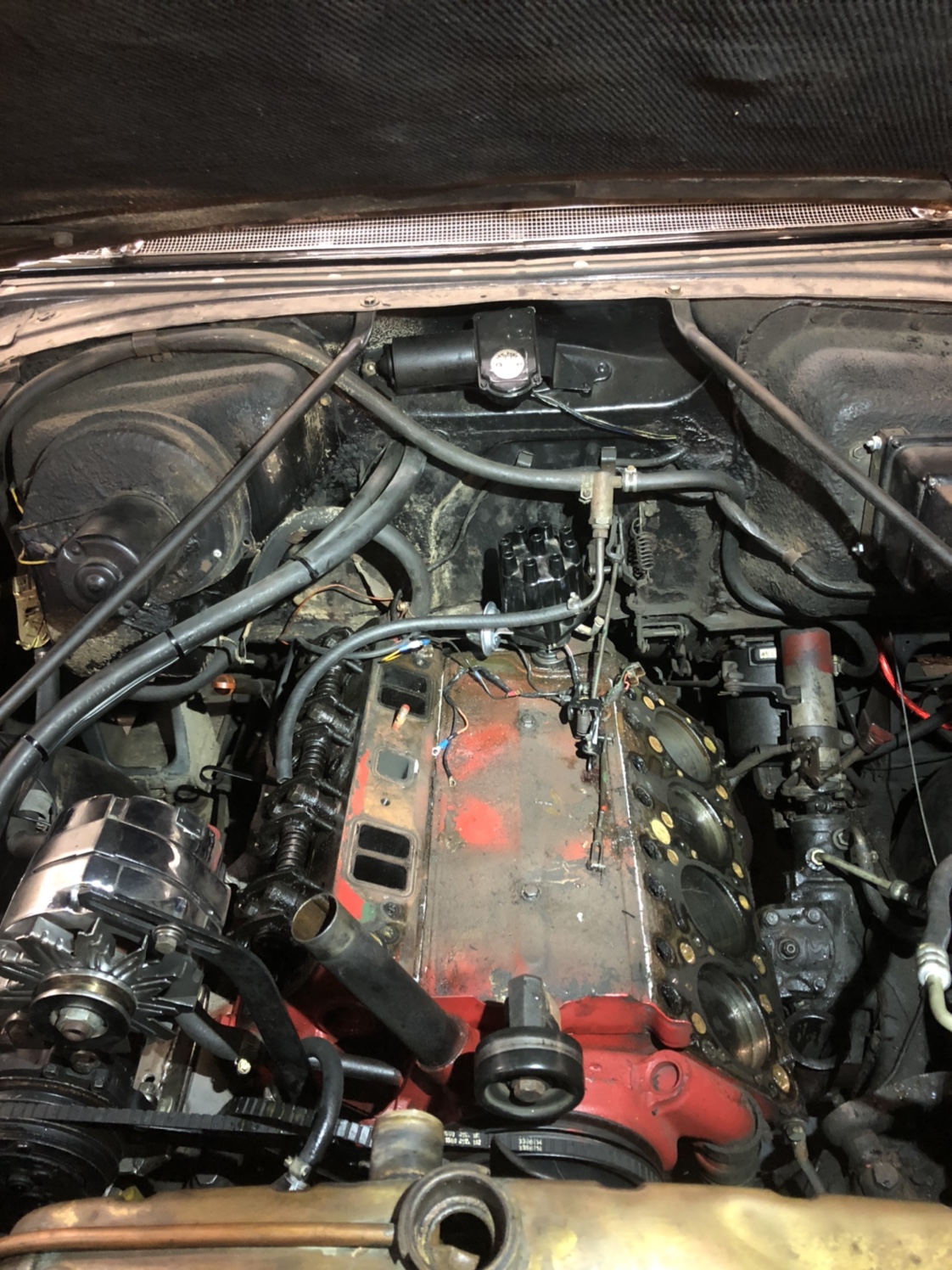

    After going through the basics of ignition and fuel system and still having the same persistent issues, I had posted a thread on here about the popping and occasional backfire. As usual, the H.A.M.B. was able to come through with sage advice. A vacuum test indicated a significant issue somewhere, and a compression test confirmed 0 compression in cylinder #7. An air chock to the cylinder indicated a stuck intake valve, , which though it would move, would not fully shut. Despite my best efforts to free it with the head on, I bucked up and pulled the offending head.
    While I was there, I noticed that 2 of the exhaust manifold bolts had sheared off, so now is as good a time as any to fix that.
    Here I’m shining a flashlight down the intake runner to #7, and you can see the light shining around the open valve.
    I’m honestly glad to see something obviously wrong, which leads me to believe I’m on the right track and not just pissing into the wind.
    I called Fusick and ordered a couple new valves, springs and retainers. Over the next couple nights I’ll work on putting this head back together and reassembling the car.
