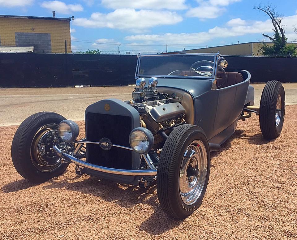

  4. Loose Ctrl
    Joined: Dec 21, 2014
    Posts: 43
    Loose Ctrl
    from Upstate,SC
    Damn thing is smiling at me. LOL
  5. Blues4U
    Joined: Oct 1, 2015
    Posts: 3,702
    Blues4U
    from So Cal
    Great looking car!

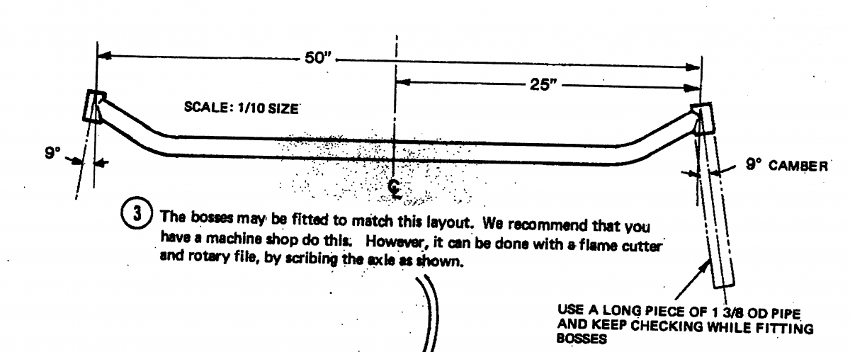

    1. MASSACHUSETTS HAMB
    This is in a scanned T-Bucket building book I obtained a long time ago. It's a scan of a printout with hand written notes and multiple holes visible from a 3 ring binder. It shows how to make a tube axle, frame, hairpins, & brackets (with patterns) in your shop with mostly simple tools, a roll of tape, and a couple boards. It does suggest a mandrel bender for the axle though.
    It shows how to mount a Jag rear end so that probably dates it.
