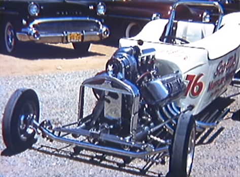

    It seems like Model T hot rods are more likely than not to have a tube front axle, something that is rare on a Model A or 32-34. So why are they so popular on T's? This seems to be so especially on T buckets, and especially Fad T's, but also on Track T's. Seeing as a tube axle has issues with hairpin mounts due to the lack of twist in a tube axle, yet this is the typical setup. What's up with that? Just curious why this is so common on T's, is there a historical context I'm unaware of.
    Some examples:

    The track t’s are likely using v860 axles which... maybe weigh less?

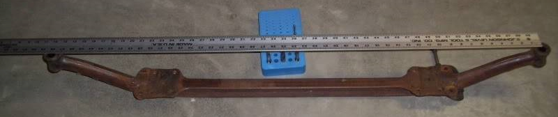

    But to throw a wrench into the matter, here is a photo from a HAMB reader from Ohio with an unusual axle.
    Ron Funkhouser and Blues4U like this.

    ^^^That axle gives me the 'Willys'! Oh, that's probably 'cuz it IS a Willys...

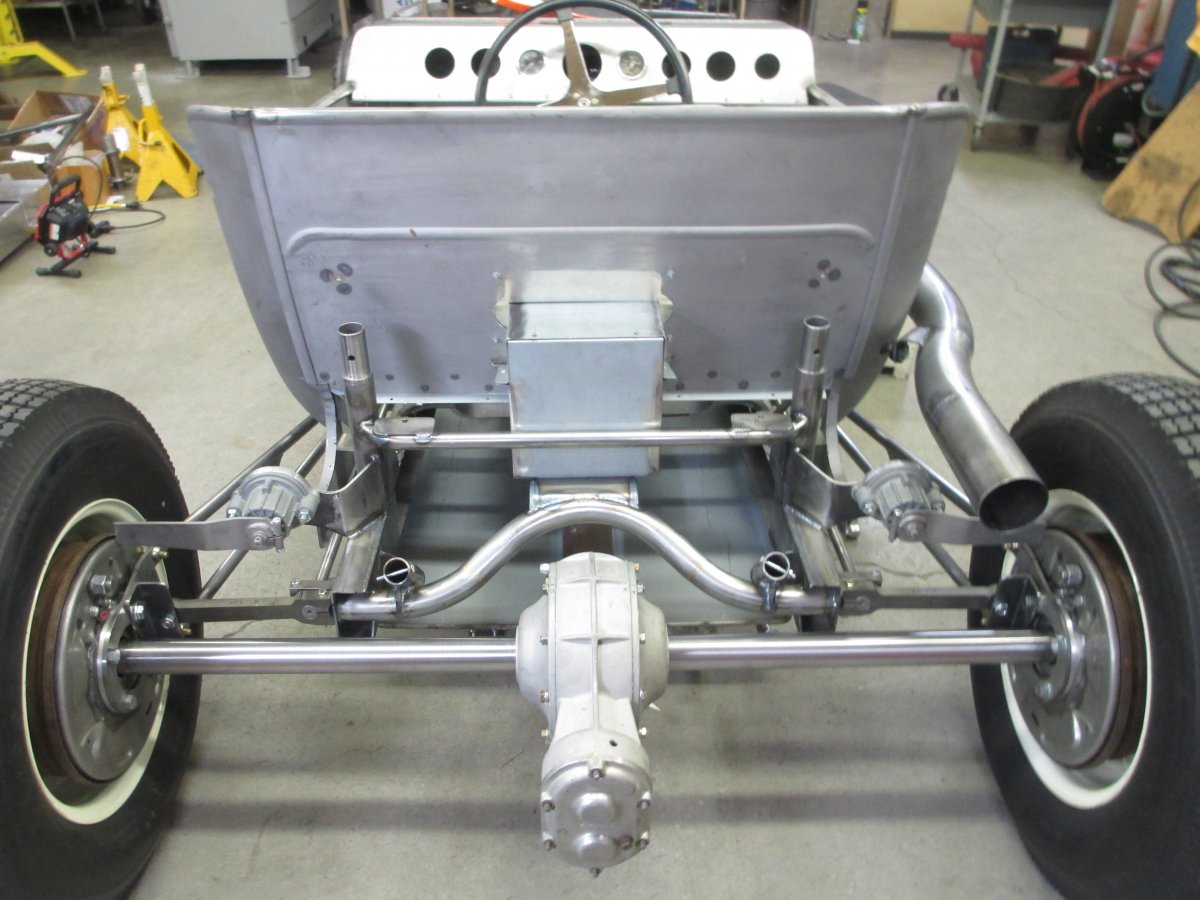

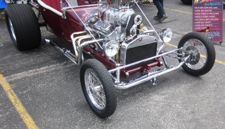

  28. Loose Ctrl
    Joined: Dec 21, 2014
    Posts: 43
    Loose Ctrl
    from Upstate,SC
    That is one spartan looking rear. I do like that torsion bar set up and those brackets for the pins. At least those look like hairpins.
