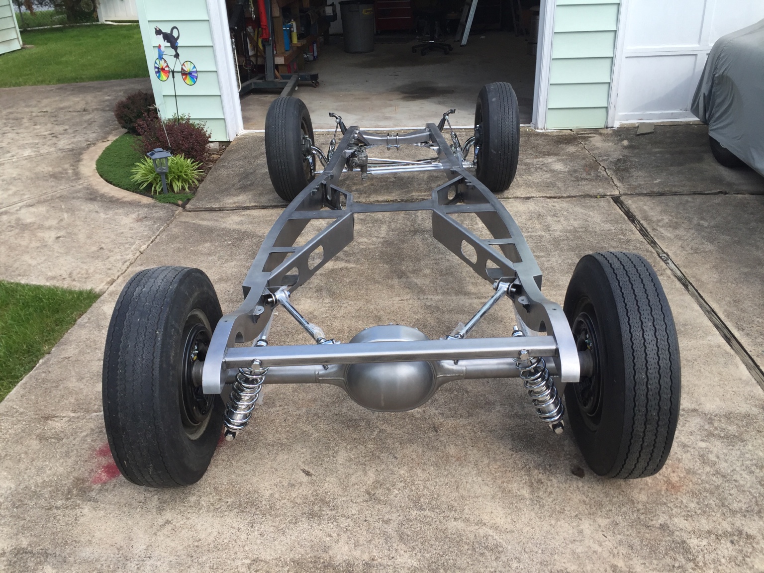

    Here's a triangulated 4 bar in a P&J '32 chassis
    SPark
    Do it Over likes this.

    Never understood the angled design. Raced GM factory design after stiffing up big soft rubber bushings. Try to explain: top angled bars move up & down away from each other but steel does not stretch so must depend on soft bushing before binds up. Would ask "wingman9" to remove temp steel/shock mounts & jack up rear to actually see how far it goes before binds & lifts frame. Hope this makes sense. Tks

    A properly designed triangulated 4 link shouldn't have any bind. Bushings may limit travel as they can't twist much, so a spherical ball or heim joint is better for a large range of movement.

    As has been mentioned, with proper design, there is no bind. This setup didn't depend on bushing flex to do this. There were spherical joints on all ends:
    Diagonal links remove the requirement for a fifth locating link. Better ride, and cheaper to make on the assembly line.

    Great explanation with swiveling rod ends- thanks much. Rod ens swivel believe proves my point of rubber bushings are where/what allows angled link to work. Looks like you have rod ends in both ends of top link bar so swivel allows tons of movement in rod & rear. Small rubber bushings not so much me thinks. Understand he is give harsh street ride. Building 4 link & panhard with heim at one end & bushing at other in hopes of movement with little quieter ride. Tks again

    Understand heim joins will allow/accept more movement. I am questioning design with bushings at both ends of upper links such as show above in Brookville and P&J's pictures when whole axle rises ( center section ) not just one wheel end. Think rough railroad crossing at speed. Loving discussion hope OK with other readers
