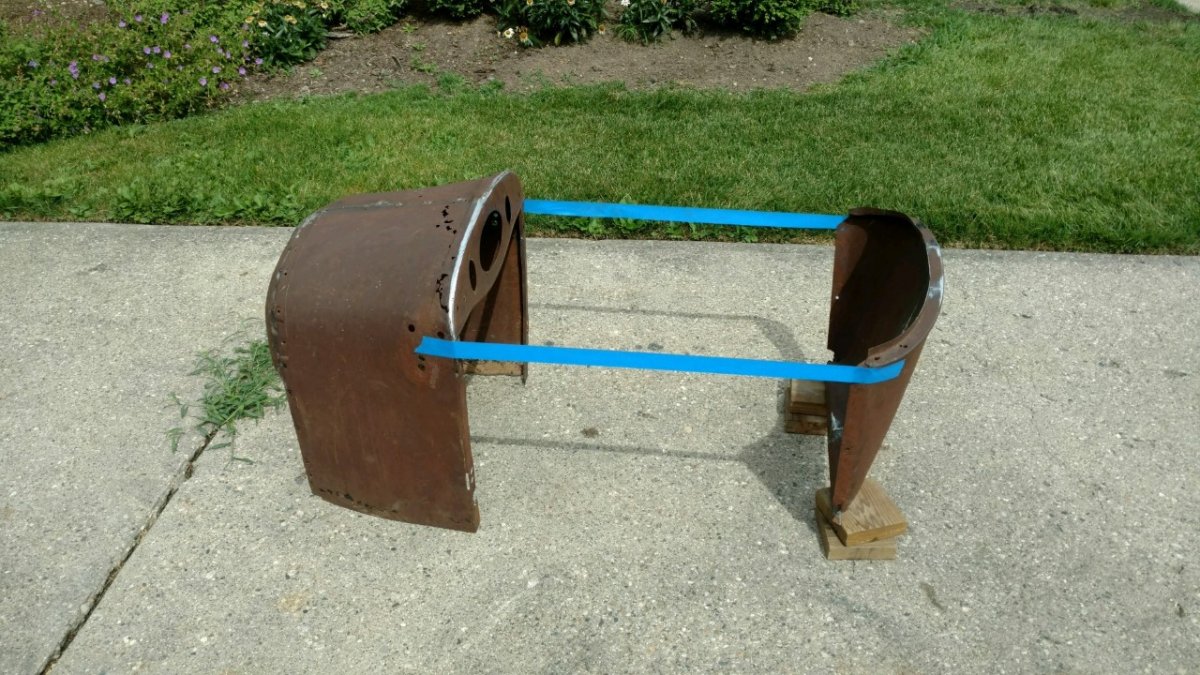

    I only have a 2 car garage. I have a '33 coupe and I'm building a 2 man modified. Had some leftovers, but to fit in the garage it needs to be small!
    Cheers,
    Stewart. thumbnail_IMG_20190718_162203012.jpg thumbnail_IMG_20190718_162059641.jpg thumbnail_IMG_20190718_162226920.jpg

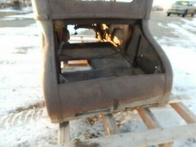

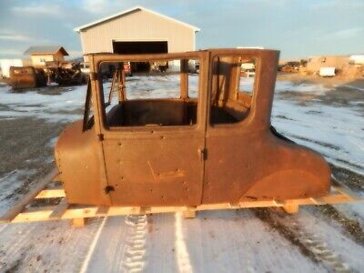

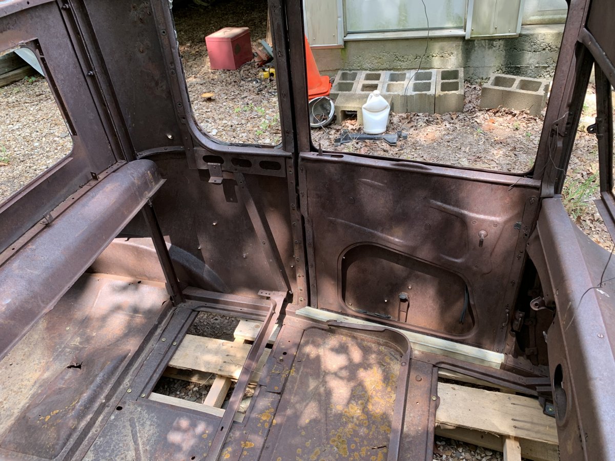

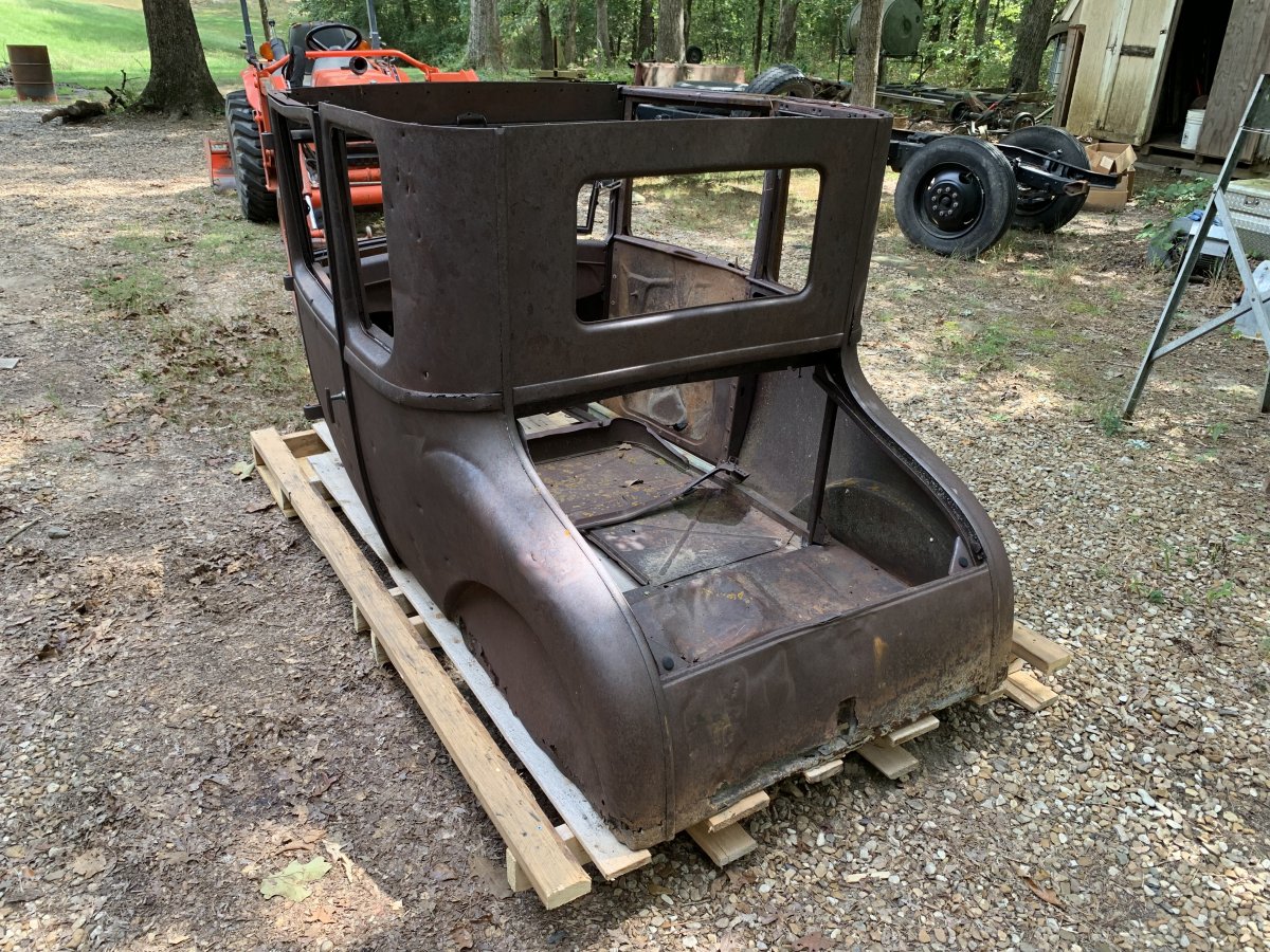

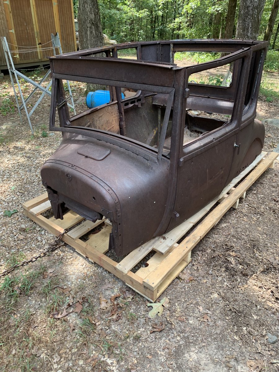

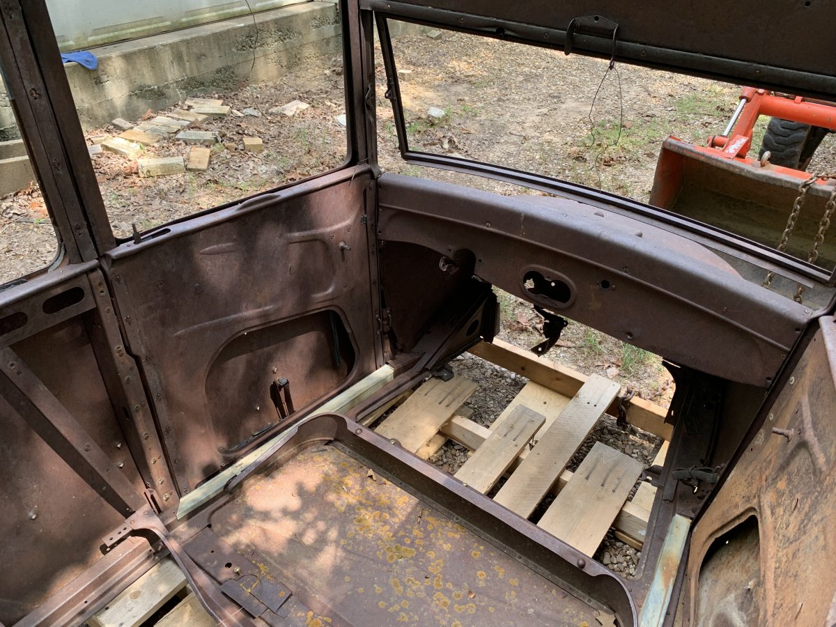

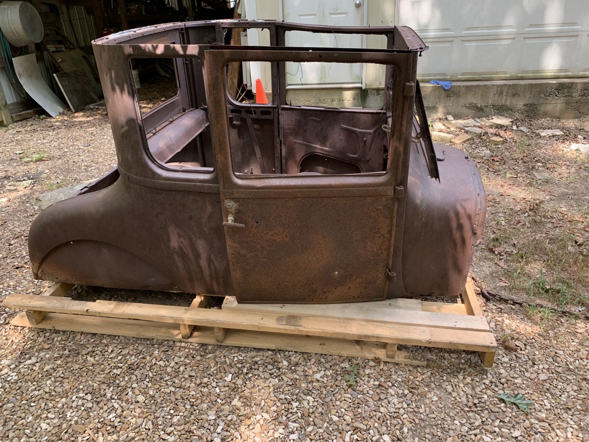

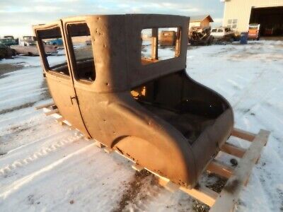

    Ok help me out here. I don’t know whether I have a 26 or a 27. I’m new to model Ts. From research thus far it seems there was actually more wood in the 27 coupe body than the 26. I’ve seen pics of other coupes that have an inner panel around the rear window with some large holes in it and then some like mine that don’t. Maybe mine did and it’s missing. I don’t know. Can you or anyone else tell me how to figure out whether I have a 26 or a 27? I don’t actually have it home yet it’s being shipped.
    By the way, I REALLY LIKE your roadster.

    I’ve heard there’s supposed to be a tag with a body serial number somewhere around the seat area? Did your T come from the states or was there a factory in NZ?

    There have been some threads about this and no one is really sure.
    But if i got it right the 27 had wood to mount the interior around the windows.
    The 26 got the the sheetpanel with holes.
    Another one is the top hinges for the windsheild. 26 supposed to have pianostyle
    and 27 c-clamps.

    I’ve also gathered that no one knows for sure, even the restorers.
    loudbang and 26 T Ford RPU like this.
  23. robert4005
    Joined: Jul 14, 2009
    Posts: 48
    robert4005
    I don’t have a frame just the body in the pics.

    Are the sill plates different on the coupes from 26-27? I know on the roadsters they are. 27 has a big one piece sill plate whereas 26 has a two piece.
  26. From what I can see it looks like a 27 by the back window.

    Really don't know the difference between '26 and '27. Mine has the wood around the quarter windows and I found a 1926 license plate so I registered it as a '26. From what little that we started with, what does it matter?

    The differences that I know or I think I know are;
    • Difference in headlight mounting. 1927 has the full headlight bar, while the 26 has the lights on pegs.
    • The 1926 has the metal around the rear and 1/4 windows
    • The 26 coupe has the finger hinges while the 27 has the hinges more like the Model A closed cab pickup.
    • Somewhere in between all that, there is also an additional variance with respect to coupe to hinges with some using more and less bolt holes and in some cases the top hinge has a 90 degree bend into the A pillar end.
    • Obviously other restoration and mechanical items that probably does not interest most of us.
    • A lot of folks don't realise that these T 's did not have water pumps...

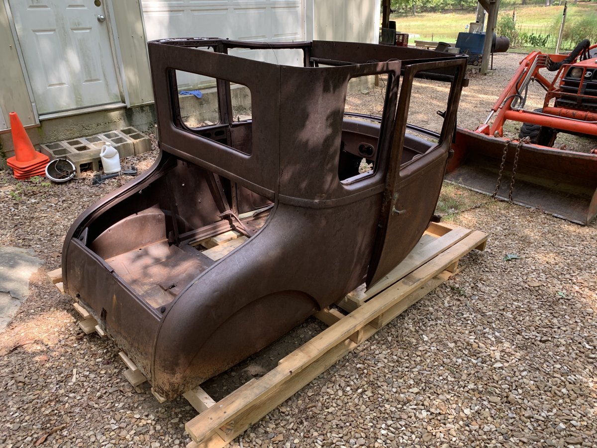

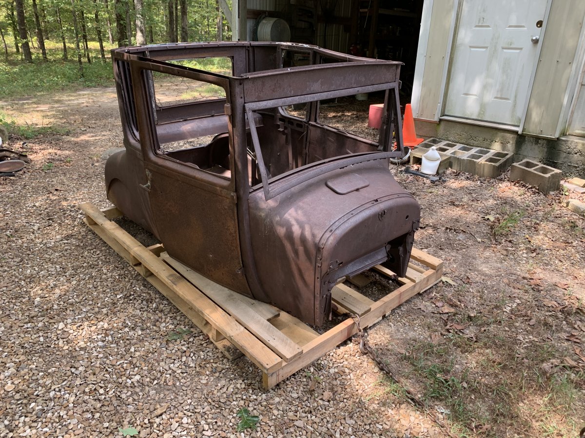

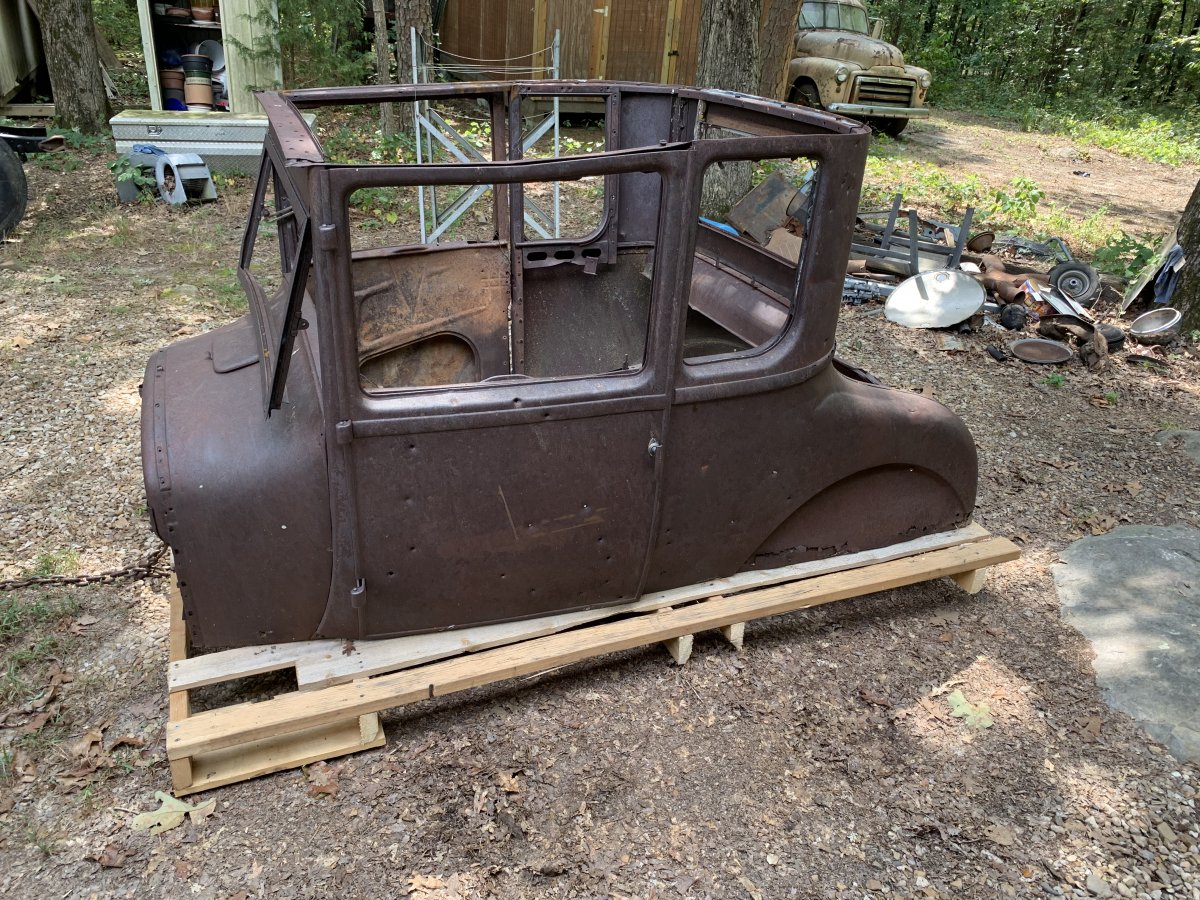

    Well it’s home finally. Now at least I have my own pics of it non my own place. A little rough but something I can work with and besides what original T body isn’t?
