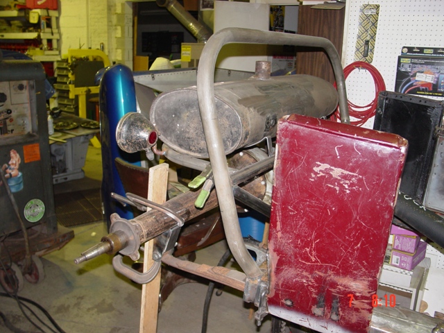

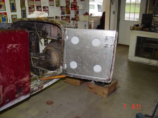

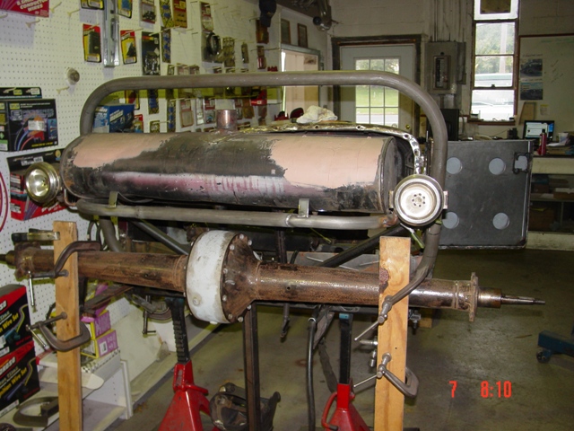

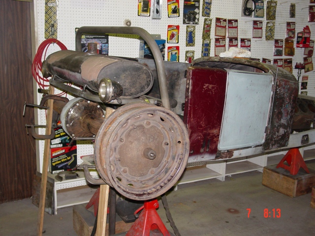

    Heres a few more shots of mine.
    I have the tank supports made, removed the filler neck and sending units (from where the skim coats are), relocated the filler and pondering the sending unit. The gas tank is early '30s chrysler i believe.
    I am near done with the passenger door - we have come to hate eacher other this past week - the recessed area for the latch looks wonky but it is just the angle of the picture.
    I used the cowl lights of a truck for my taillights. I cut pieces of the original bracket and added it to the gastank safety surround. I'm not sure how i'll dress out the light for stop/turn, kinda want to keep it as stock appearing as possble.
    I am kinda re-engineering my rear suspension stuff so i will have about another inch of clearance inside at the seat area, i might have to completely redo the seat section but i am trying to weld in a piece and salvage existing work - it probably won't work but we'll see. Anyway, that will be in the next set of pics.

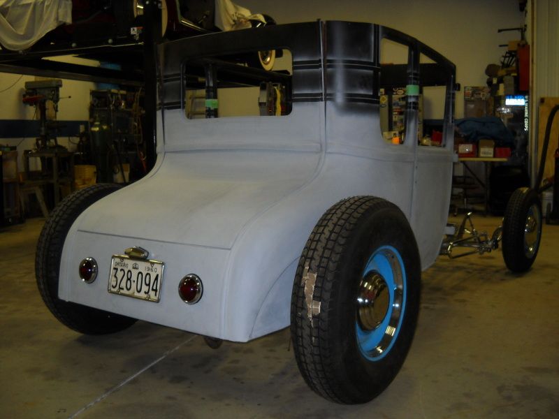

    Started whacking the roof today - I didn't want to cut through the "T" strips separate the rear panel from the quarter panels so we unbolted them and drilled out the rivets, bending them back slightly to make room for the saw to get in there. Once the chop is complete we'll just hack off whatever sticks up too high. A little less body work. It'll give me a chance to get in there and clean up the area in behind the "T" strips too.

    Worked on the chop most of the day today with the help of my buddy Al. Here's some pics. It's all done except for a little finish welding and grinding and some fill'n and paint. After sitting on the seats I'm planning to use we decided to limit the chop to 4.5 inches - not a lot for a T but I'm real happy with it and I'll be able to climb in and out with out breaking my back.

    Nice!! I did the same thing... left the T beads long and cut them to match the chop. Have you gotten to the doors yet? I had to widen mine 3/8" to match up after the chop.

    Yep! Doors are fit. I didn't need to lengthen them but it took a little finnagleing - Is that a real word? Still need to make the new header for above the windshield.

    The chop looks really good. I like this all steel roof from post 739 a lot.

    Thats a great looking chop! Did you take the same amout off all the way around?

    Yes, 4.5 " everywhere. BTW - I obviously like the drilled axle too. Thanx
