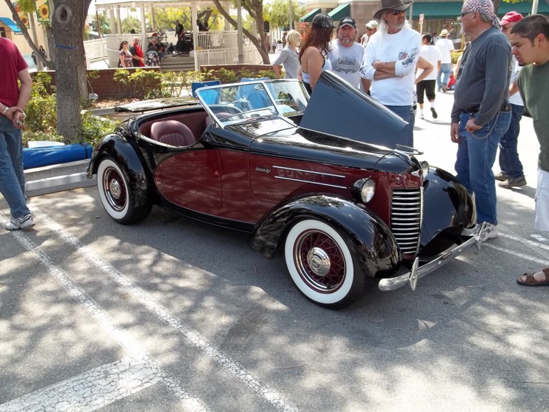

    Actually, the T-Bucket I have seen is black, Don't have any pictures of it, but here are a couple of pictures of another V8-60 car I do have, a beautiful installation in a stock Austin Bantam Roadster.

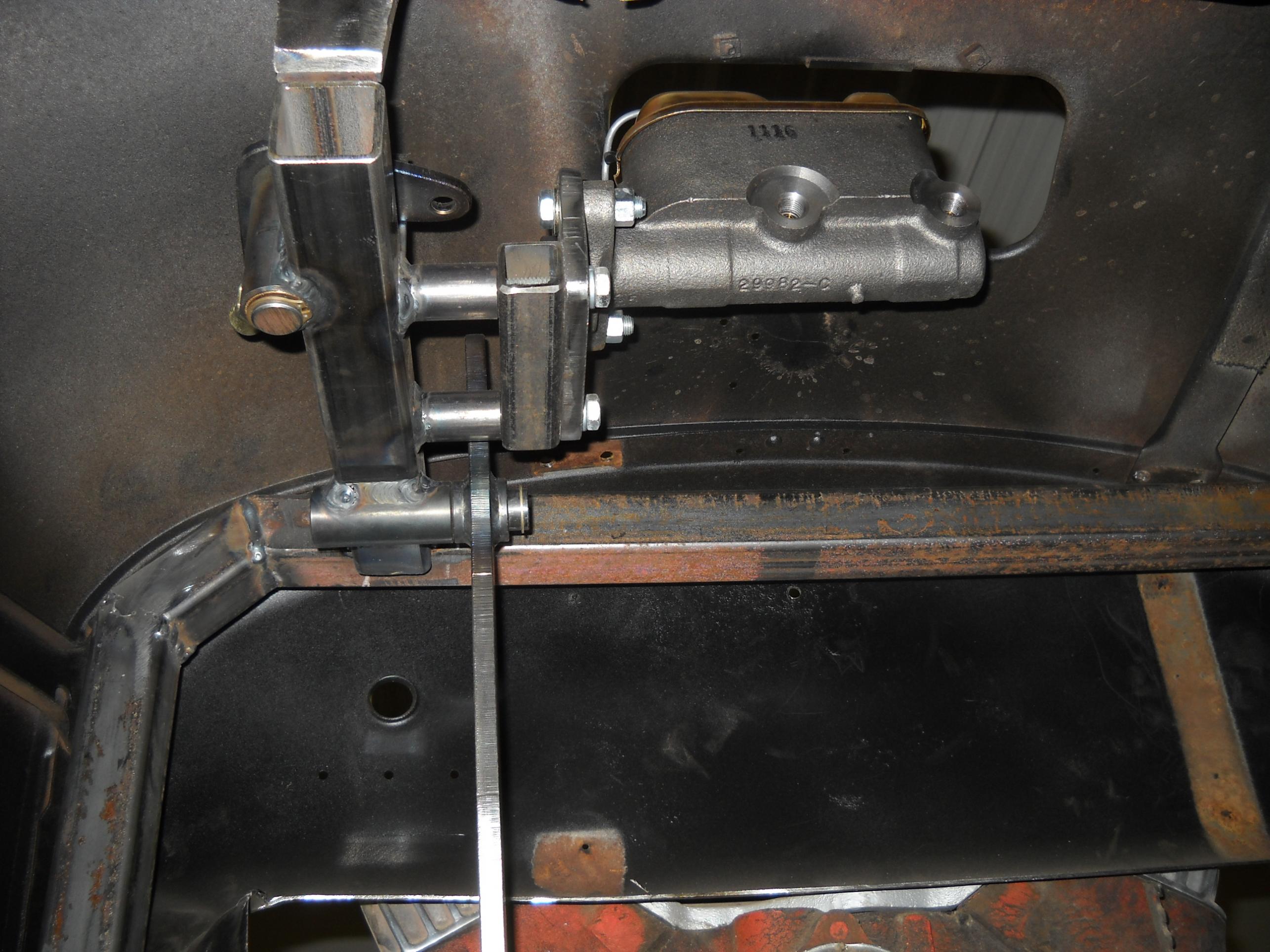

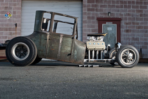

    Haven't accomplished a lot lately with my wife being sick and I had the worst frigg'n cold of my life but I thought I'd send a few pics of where my ride is. I got the motor mounts in, the deuce shell chopped, installed the brake pedal (it'll need to be offset a bit when the steering column is made). I used some 1.5 in. tubing to support the hanging pedal/master cylinder mount with a piece of flat bar mounted to the A post to support the back of the pedal assy and also eventually, the steering column. When I'm done, there will be a triangulated brace tucked up in behind the kick panels as well. The engine in it is just for mock up - it'll actually be a tripower intake but the dual quads look cool and gave me something to set my level on.

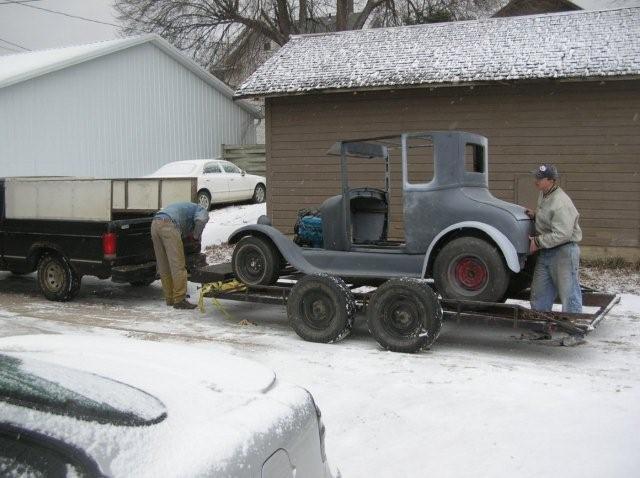

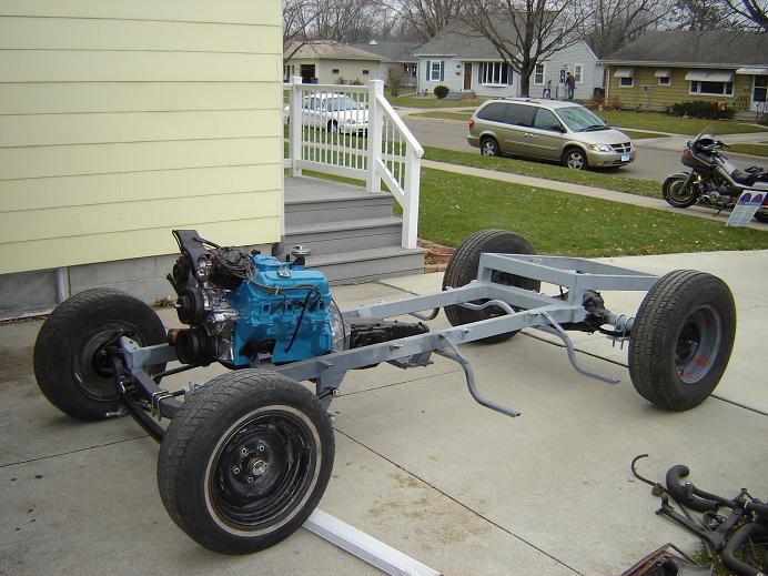

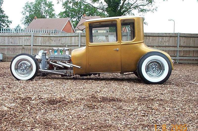

    Guess I'll have to jump in here too. Lost interest in the coupe with son getting married and now having three more grandchildren, finishing the basement, playing around with a stock T... selling it and lots of time on the motorcycle.... you all know the same old story of putting it off. I think this thread is going to do the trick.
    The pictures show what's the coupe has looked like these past three years or so.
    First thing I've got to do is to pull the 4 speed and put in a 350 I have laying around some where. My left knee has problems and having a clutch will only make it worst. And then hook up steering, plumming and be done.. ya right. Anyway that's the plan.
    Thanks for the inspiration guys!!!!
