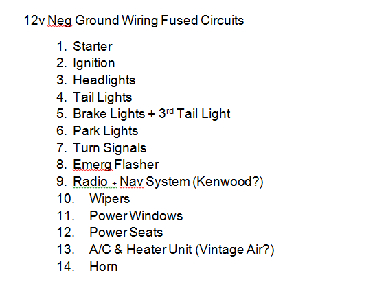

    Update of "Probable Circuits" for Hot Rod
    Separated the Turn Signals and Emergency Flasher.
    Added;
    Horn
    Wipers
    Will the Vintage Air require 2 circuits; 1) for the blower, 1) for the compressor's electric clutch ?
    Any additions or corrections?
    The '40 Chrysler that I'm working on was originally 6v Positive Ground.
    Even if I use a 12v to 6v reducer, will the change to Negative Ground affect the fuel gauge/sender unit?

    Lighting will depend on what headlight switch you are using-tail and park lights can go on same fuse, headlights may have a circuit breaker built into the switch.
    A modern radio needs 2 feeds, constant 12v and key switched accessory.
    Emergency flashers can be added to the brake light fuse (if you are using a modern turn signal switch).
    Every vintage air I've wired only required 2 feeds-constant 12v with circuit breaker that they supply and a key on (ignition, fused) source.

    I use to hate wiring but over the years it's gotten to be one of my better chores. If it's a simple car (t bucket or so) I'll wire from scratch, once there is A/c, radios, electric fans ect I'll use a kit. I've used a lot of different kits over the years, they all work pretty much as they should I feel. One thing I learned is to remove ALL of the wire ties they provide a separate out the wires that aren't fused. I guess to make it more "kit" like they bundle everything to the fuse box. I don't see why they do that, only wires that need to go to the fuse box are the fused wires! Makes routing easier and neater when all wire don't run to the fuse box and back.
