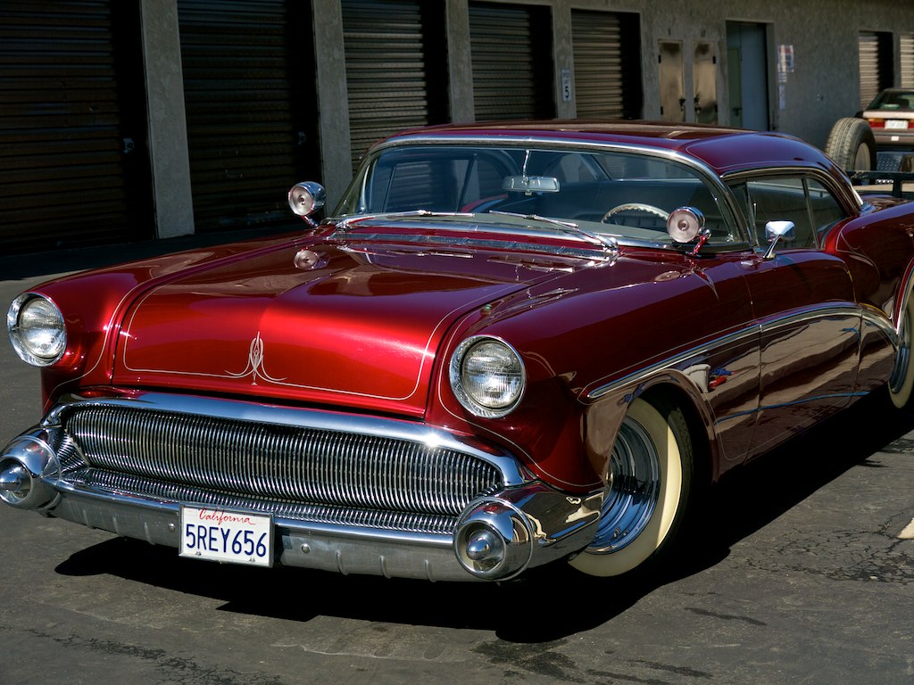

    I met a guy who bought this Rich Zocchi 57 Buick. When he got it, the windshield was cracked. He said they broke 2 more before they got one good. Expensive.
