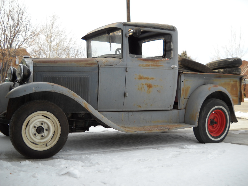

    With a set of Kelsey Hayes bent spoke 16's will I need the wire wheel support rings for fitting on my all original 31 A truck?

    If you have original drums, you won't need the extra rings. The drums have the support risers on them already.
    Just make sure somebody didn't grind the supports off already. I see in your pic the truck has latemodel wheels on it. The nubs may not be there anymore.

    If you have juice brake drums you need the support rings.
