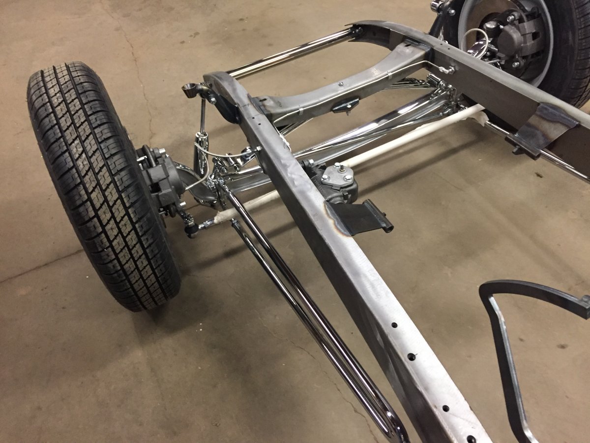

    I used one for my frame build, and there isn’t much room between the radiator and the top of the crossmember, I thought I would use flat top model A u-bolts but they do not fit. The bottom plate is not wide enough either. What are people doing for ubolts? I really don’t like the type that weld to the crossmember, I would prefer something more stockish.

    A photo would help, what is the drop gained with the Shadow crossmember? Bob

    Over the years I've used 100's of the weld on front spring clamp from P&J's on customer chassis with no problems.

    Shorter than stock that weld to the boxing plates? Bob

    This style is the Pete and Jakes he mentioned.

    It’s a dropped model A style so you get the 1” plus about 3/8 -1/2 more besides. Not totally flattened.

    I made a fixture today to heat, straighten and reform the flat top model A u-bolts to a little wider profile, then I’ll just need to make a new bottom plate with a little wider spacing. We’ll see how that goes.
