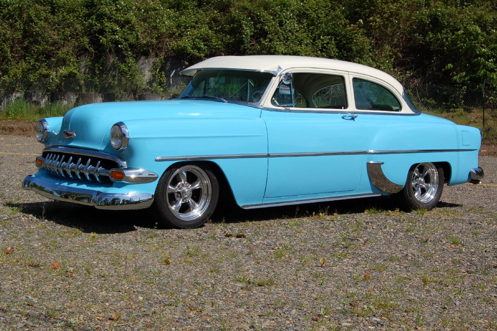

    Used Fatman's dropped uprights on my 54 in 98 when I built it. Also cut 1 coil while I was at it. They are stout pieces and worked great...good ride and still working for that matter.

    your 54 looks cool, did you use their steering arms too?

    Thanks. Yes, the dropped steering arms are the way to go for no bump steer.
