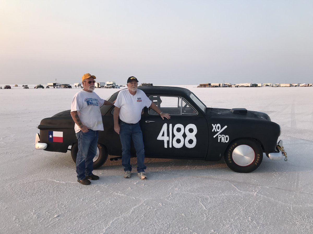

    I was 35 when I first ran my car on the salt. Only sorry I didn't do it sooner. Good luck with the sponsors. You have been following the
    XO/PP Bonneville project thread I guess?

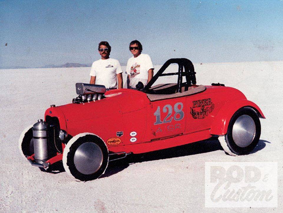

  23. Here's one of my father's snapshots of Tony & Pete's Roadster at Bonneville Speed Week '85:

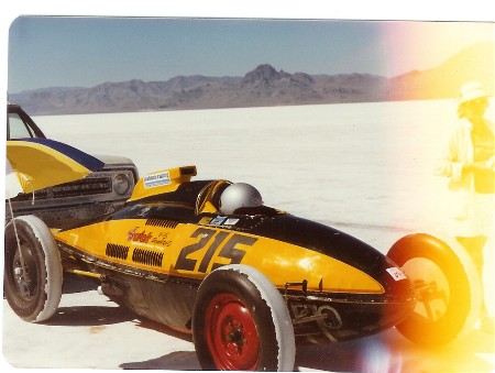

  25. Ran this one in 1962. If you want to run one of these 200, you better have the aero right. We didn't, and I am still paying for that mistake.
    HEMI32, wicarnut, jnaki and 2 others like this.
  26. This is what happens when the aero ain't right. They fly good, but the landing is a bitch.

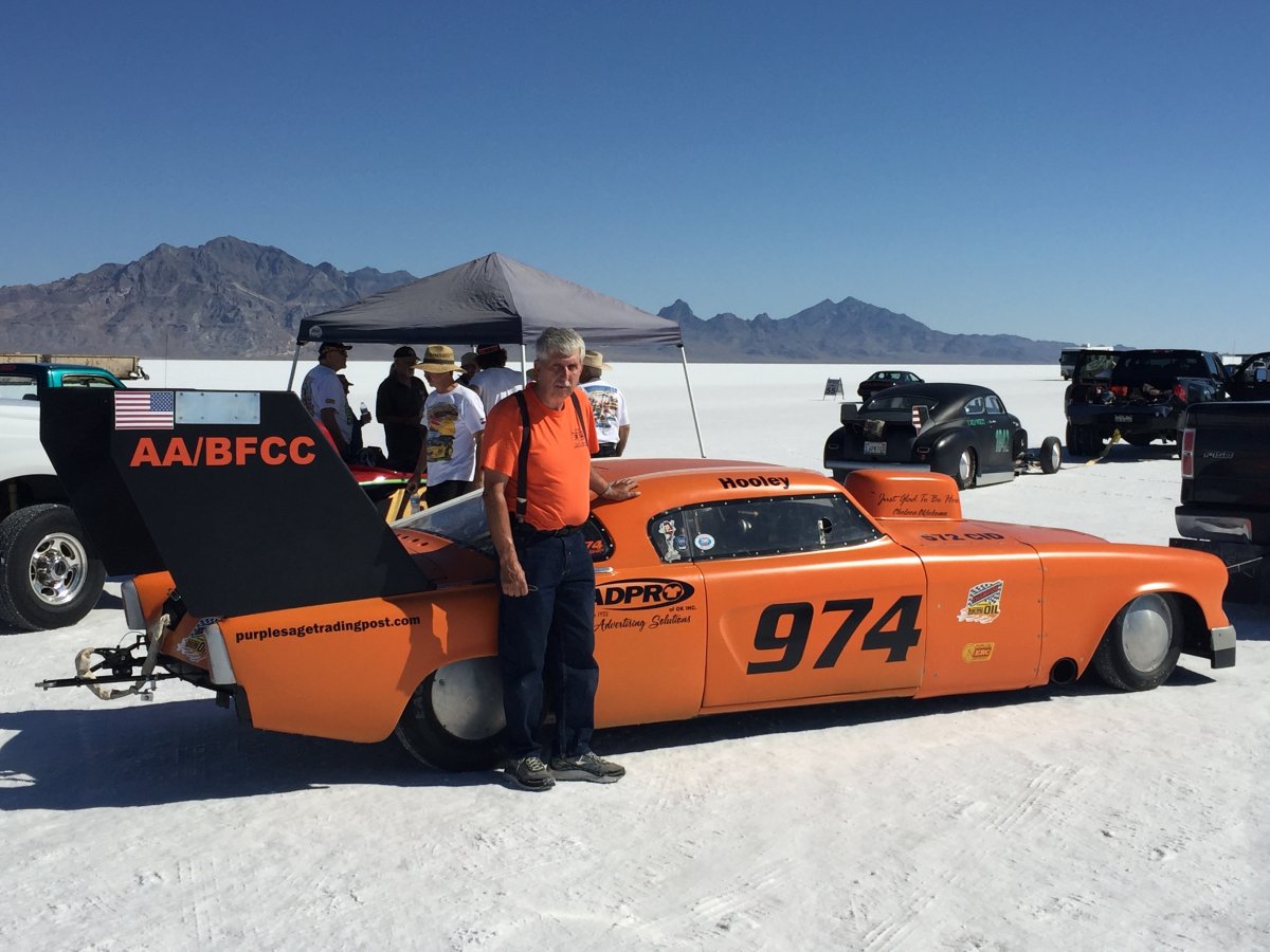

    IMG_3005.jpeg Here I am with the car that I was crew chief. My friend Hooley and I built this car. He plans to run it at the Arkansas Mile this summer. It held records at Bonneville, and currently has records at the Texas and Ohio Mile events. Bonneville was the experience of a lifetime for me.
    I have also been a part of the Flatcad racing team. I believe it will return to the dry lakes soon.
    Note, the rules for racing on the dry lakes sure make for some unusual looking vehicles. That huge wing is not there for looks. I have seen several cars airborne and I have been on the salt when men have died at high speed. As with other adventures, there can be great rewards, but there is great danger envolved.

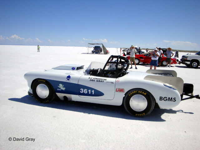

    I made the mistake of stopping by Bonneville in 2010 to visit Speed Week
    and when I returned to Pennsylvania, I Immediately started on my 1956
    Corvette. We ran in BGMS for the next 3 years and our goal was to run over
    200 mph. We accomplished this in 2013 with a run of 200 and 206. It is
    an experience that I will never forget.
