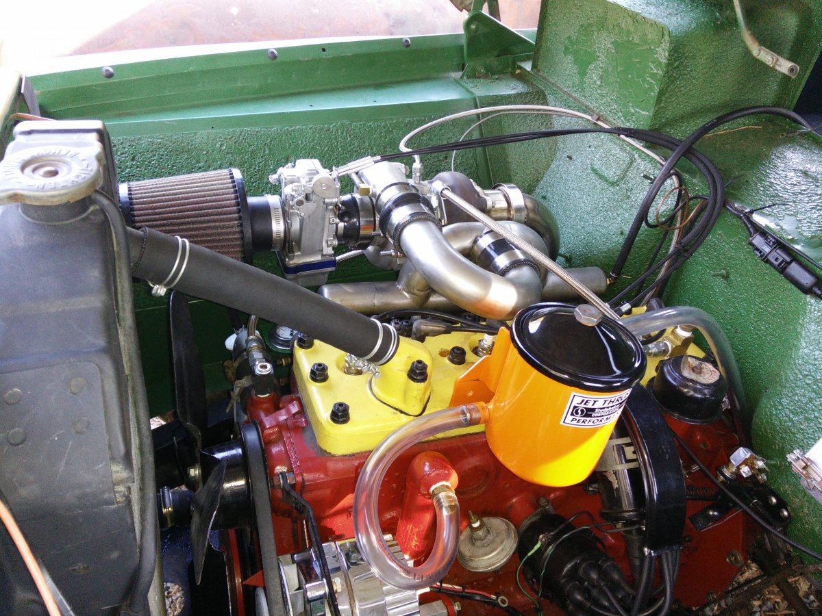

    Here is my Turbocharged Studebaker Champion 170ci

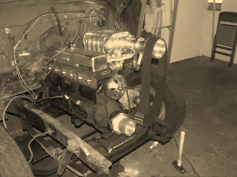

    Putting a 258 AMC engine in the K series International. Later I will add the Eaton supercharger and straight pipes. IMG_20150808_093737815.jpg

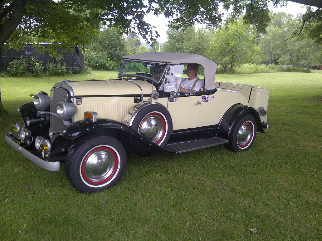

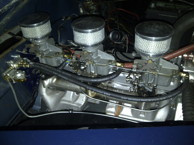

    My car would be a 1949 Plymouth business coupe, that my great aunt bought new in 1949. Its a Canadian car so already had the 25 1/2" Canadian big block in it. It left the family in 1960 but arrived back a half a dozen years ago, with still under 15,000 original miles on it. We decided to make it go a little faster.. lol.. It sports a 1954 dodge truck 265, bore 120 thou, venola top fuel pistons, plasma moly rings, our own cam design and grind which has 446 of lift. It turns 6500 rpm, thanks in part to 3 highly modified carter ball and ball truck carbs with almost 1300 cfm of carburation afixed to our own designed and created AoK manifold.Yes it is quite a rev for a motor who stock stroke was 4 3/4", so hey, we gave it just a little more stroke! It has a 1956 Plymouth overdrive, with 1940 gear set giving it a fast 2nd gear. Brakes were upgraded to 1949 Chrysler 12" brakes, a bored and sleeved master cylinder and a 354 gear set (pumpkin) from the same 49 Chrysler. The net effect, is it is certainly faster than your average Echo!

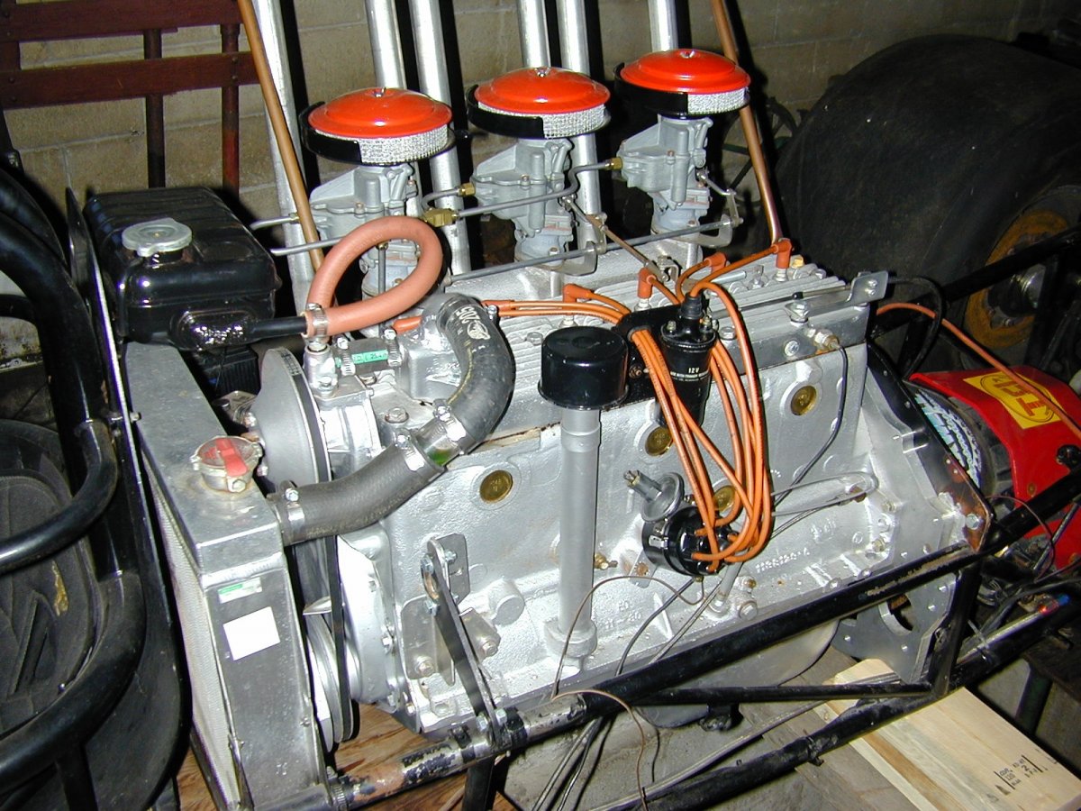

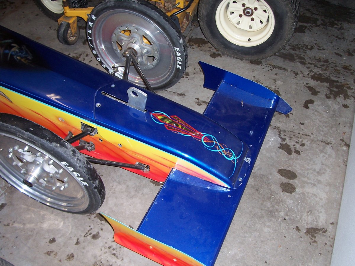

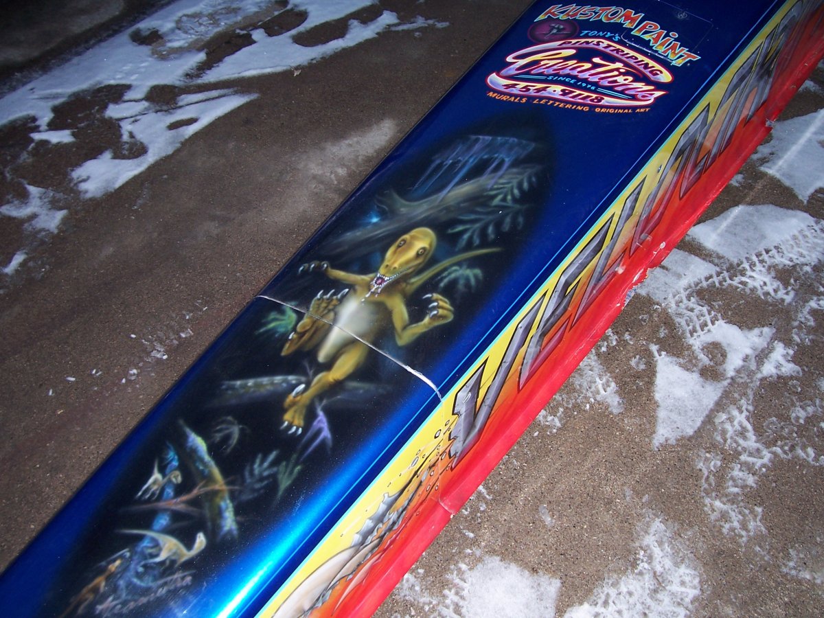

    And our final "rod" with a straight six in it came to us, after they changed the Top Fuel rules and lengthened dragsters. Ours had only it rear wing and Monster hemi removed. So we did what everyone would have done right ? Lol... Built us a flathead 6 Chrysler. After a bit of tuning, we did get it to idle to just over 2000rpm, and when you hammer it, it will hit 7300 rpm immediately. Yes, this is the AoK worlds fastest dinosaur.
    Here you can see when it was first fired
    Oh and yes, it is not running your average pump fuel ! lol
    While it hasn't made it to a NHRA 1/4 mile, it might of made it out on to a road for a little test or two. Yes, it can inflate those back tires and put on a smoke show !
    Were not sure what its future brings, but in phase 2 of the AoK racing intake development, we seemed to
    have this race prep'd 671 blower just sitting around and we definitely would not want it to get dusty. Oh and since we already have a phase 2 engine done, and it is already has the internals set up for a little extra boast, we think it
    might pretty much guarantee that it beats every factory Echo ever made !
