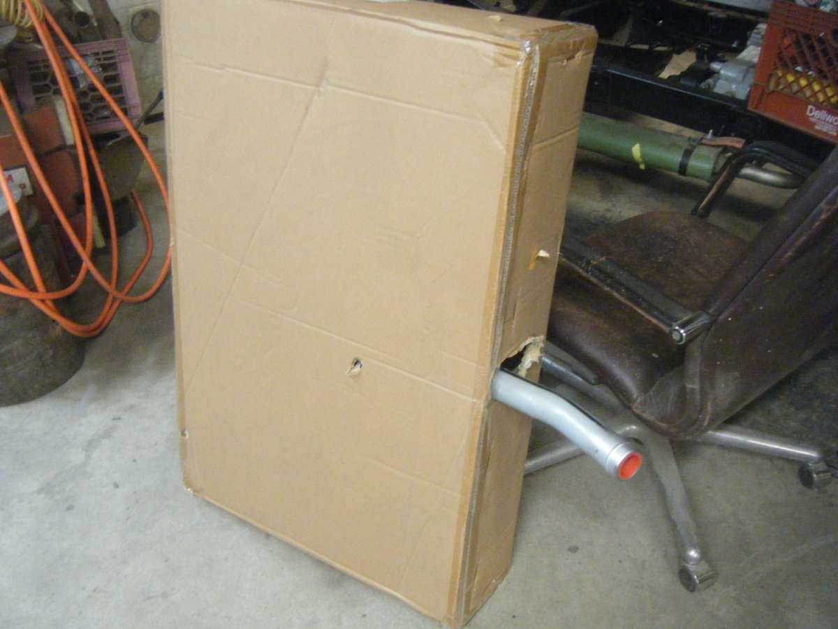

  6. fuel tank came in today for the '54. maybe i will get some more time to put it in next week. DSCF0074.JPG

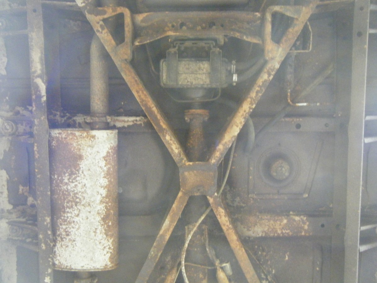

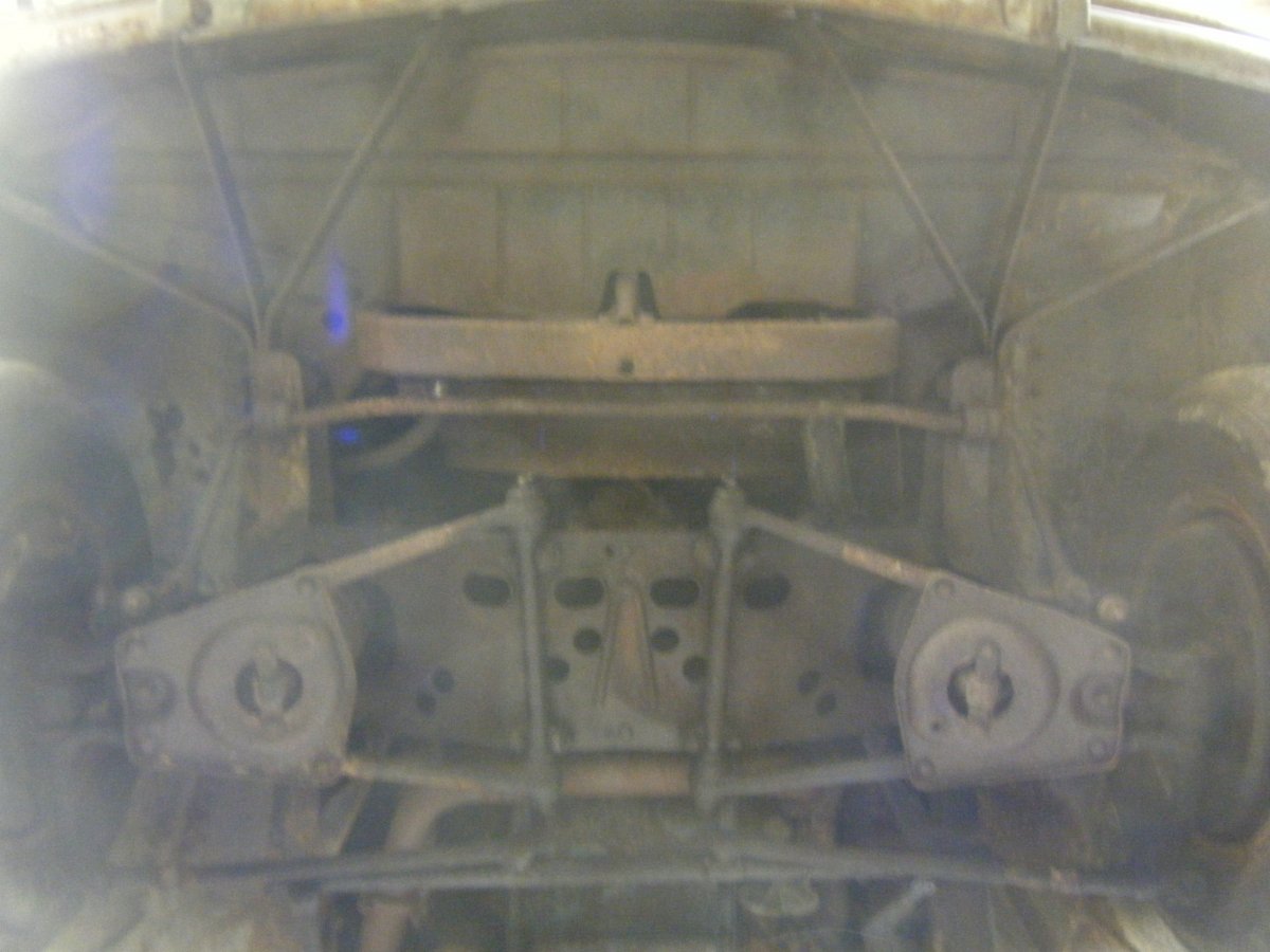

  12. i got a chance to put the 54 up on the lift this morning. rear body crossmember has a couple rot holes near the mounts and there is a hole at the bottom of the "A" pillar where the floor meets, it, and the inner rocker. .................easy fix.
    very solid but surface rusty. DSCF0013.JPG DSCF0014.JPG DSCF0015.JPG DSCF0016.JPG DSCF0017.JPG

  15. Runnin shine

  16. yeah, i am guessing a flat bed guy used the rear crossmember to pull it up on.
    i will straighten it out, and weld the body crossmember and throw some "rust treatment" paint on before i put the tank back in.

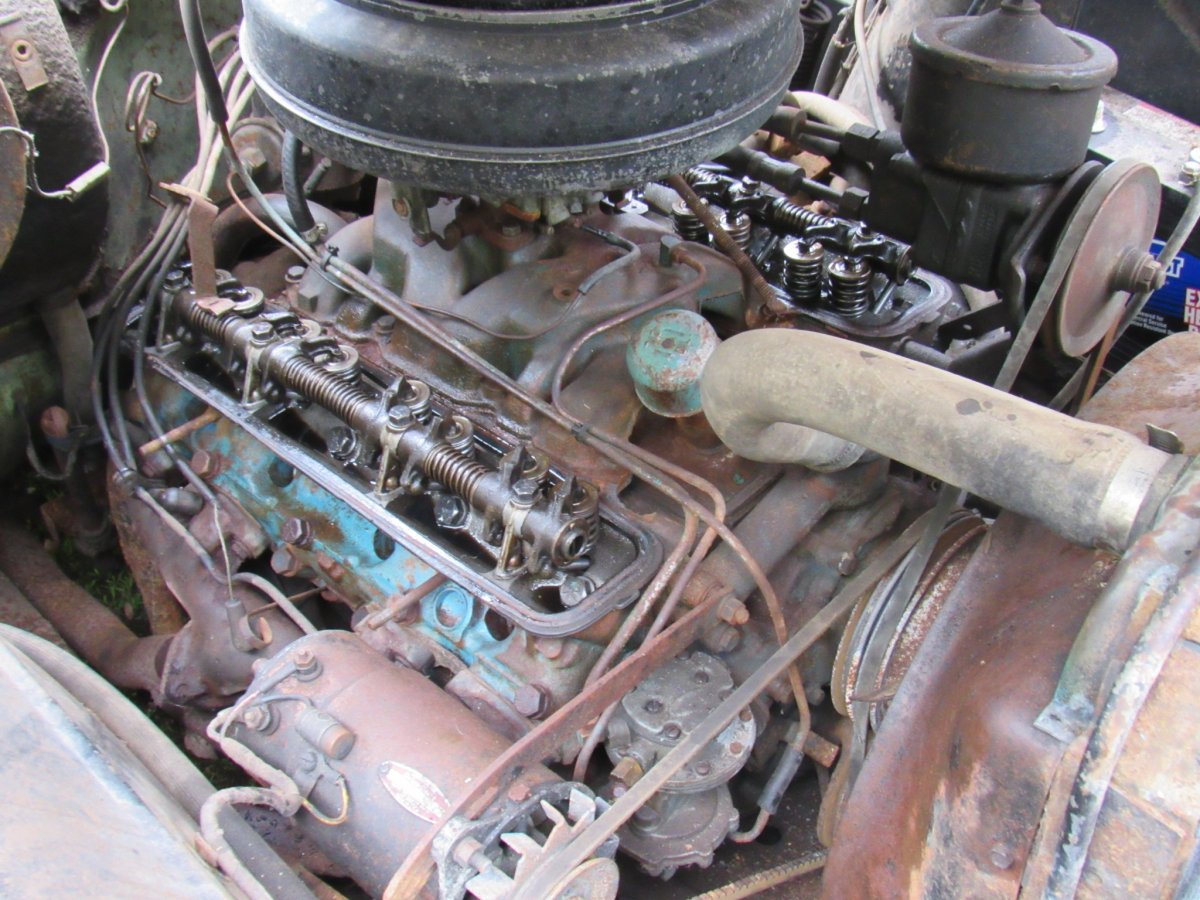

  25. I got up early this morning and decided to oil up the cylinders on the '54 and let it soak. I took the rocker covers off. man does this engine look clean inside. definitely a low mileage engine. end of the day I turned the motor over slowly by hand using the fan. it had one slight stiff spot which coincided with a small click of a valve. I worked it back and forth till it spun smoothly. IMG_4934.JPG IMG_4935.JPG

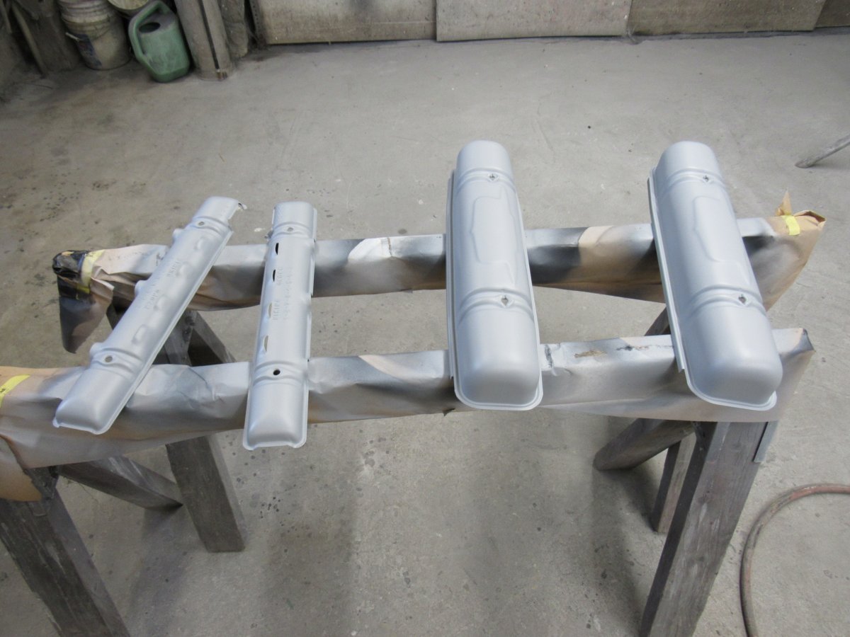

  28. primed and painted the valve covers since I had them out. IMG_5710.JPG IMG_5767.JPG
  29. I put the engine back together, a new set of wires, cleaned the plugs and points, hooked a little fuel tank to the fuel pump, which leaked, so I gravity fed the carb. it started right up, gave a tick or two then ran smooth and quiet.
    motor was so clean, I couldn't help, blowing it off, wiping it down and hitting it with a little paint before I put it together. IMG_8116.JPG IMG_8117.JPG
