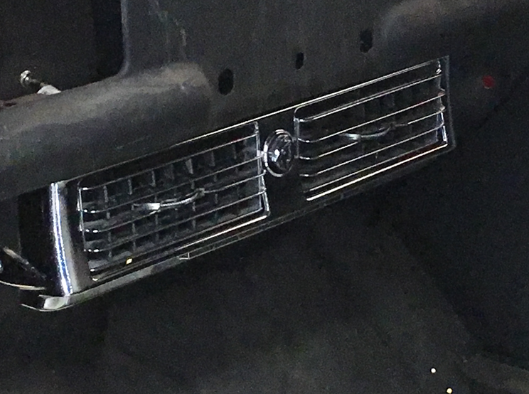

    I went with VA in my 41 PU build. You just have to make sure you get the right evap for the size car you are working on. Guys put small units in big cars then complain about the cooling. On my truck i went with the mini with heat, air and defrost, it should be fine according to the tech. Like mentioned above by @anthony myrick I also do not like the look of the under-dash controls and vents so I am taking a different route. I bought this off the classifieds, it is just the front plate off a mercury accessory under-dash AC. It is just vice gripped in place for mock up. I will split it in the center on either side of the merc dude and add the 4 control knobs, run my AC vents behind the original shutters, build a shallow box to finish the sides and re-chrome. Modern convenience, traditional look.
    anthony myrick likes this.
