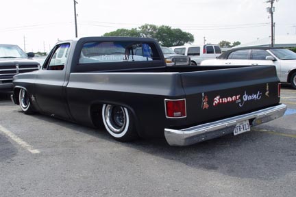

    Yah Blitz black works real well. I have a gallon sitting at the shop. We shot my brothers truck with it.....

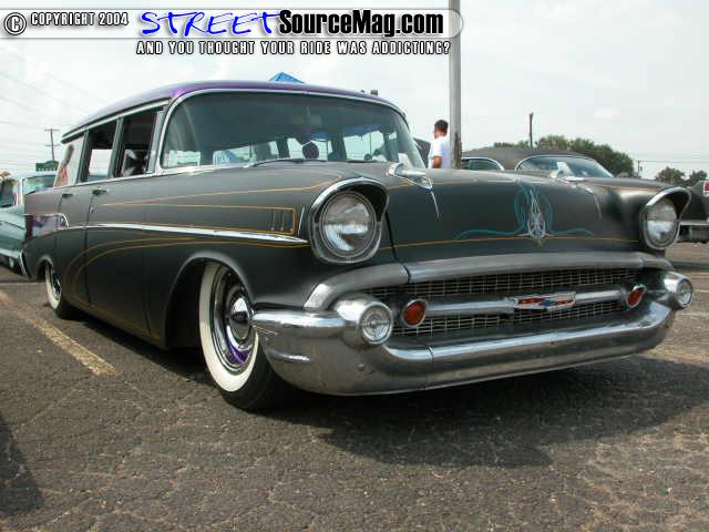

    The Blitz Black works great. It is way more durable than the DP90. Thats what we had on my bros truck before we sprayed the Blitz Black. The DP90 faded really fast. We have done a few of our rides in it and not had a problem what so ever. This wagon has blitz black on it also.....
