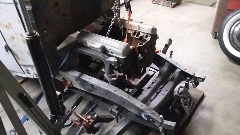

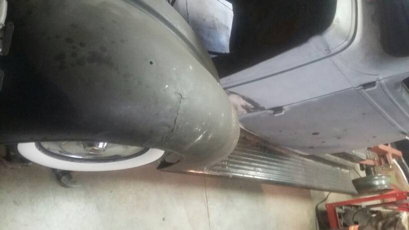

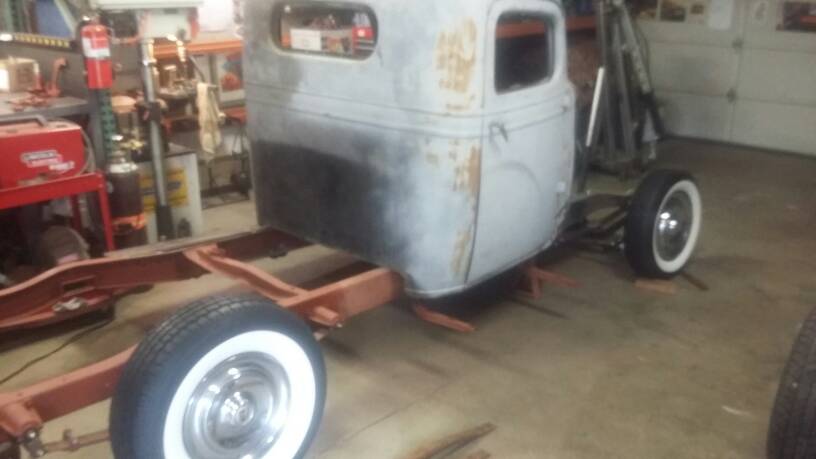

  3. 1463978431308.jpg 1463978440521.jpg 1463978450062.jpg Here is the 38 I am building. Started life as a 3/4 ton long bed. I have shortened the frame to the same wheel base as a 1/2 short bed pickup. Notched chassis, 8.8 explorer posi, 1947-55 1st series axle that is dropped 4", reversed eye main leaves in front, using 40 ford steering box for cross steering. All steel truck rear fenders as well.

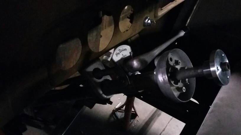

    outside with steering 004.JPG . project
