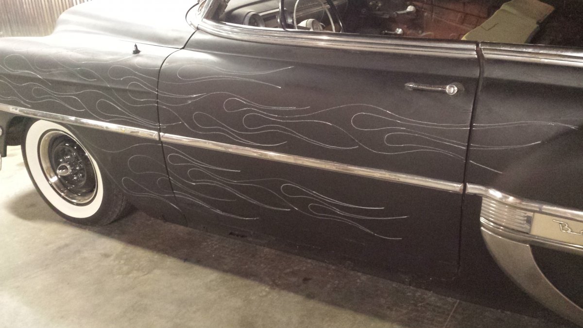

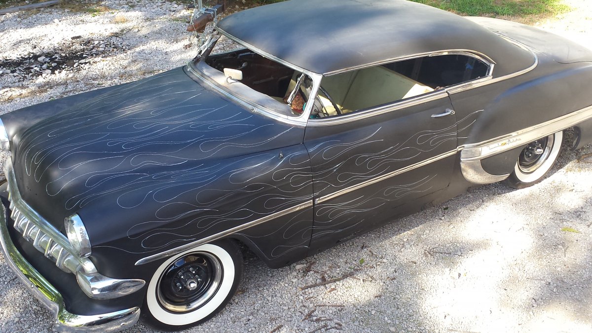

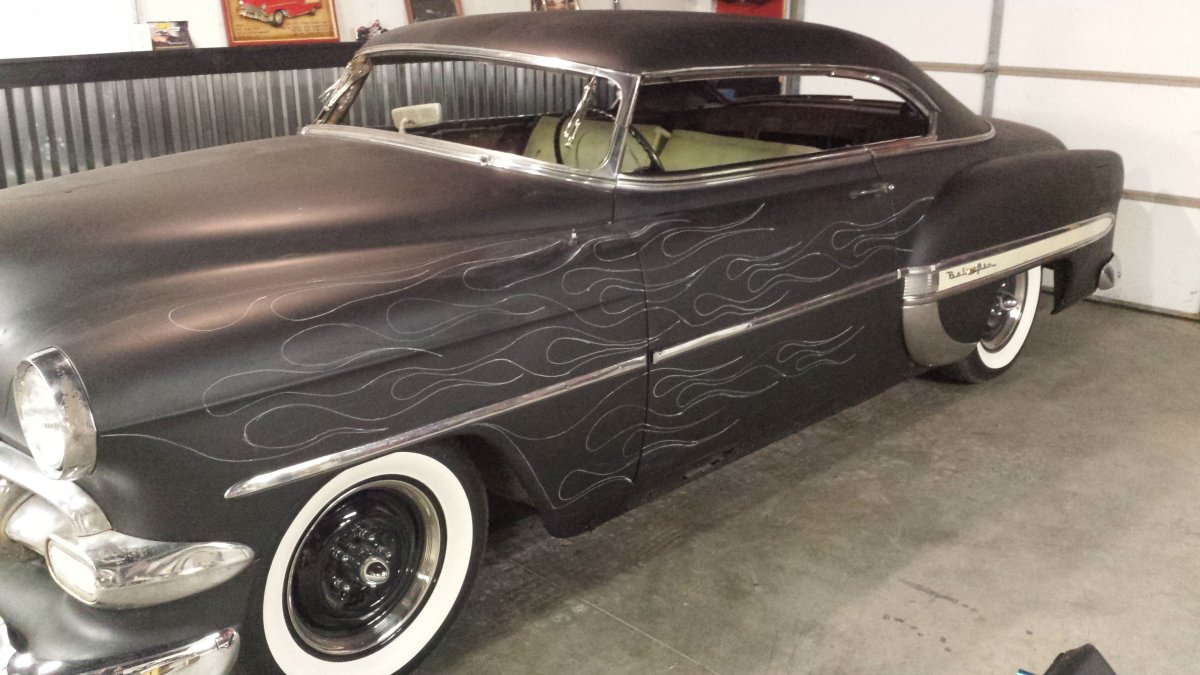

    So my 54' is getting pretty close to finally seeing some road time, but the body will need many many more hours before it gets a finished paint job. I thought I'd add some flames to the current paint to take some attention off the rough body work for now.

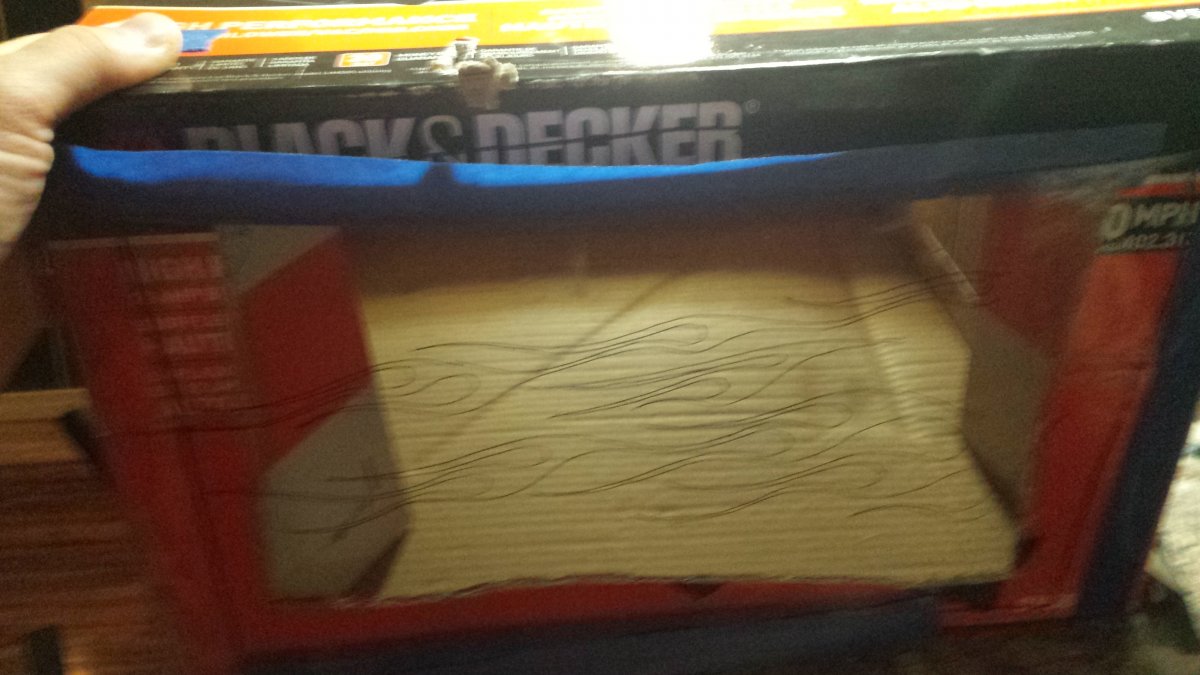

    Well after wasting almost $30 on 3M fine line tape because I just couldn't lay out anything I liked, I found an idea online for painting murals. Basically I made an overhead slide projector out of an old cardboard box, clear piece of vinyl, tape, and my cell phone light. The "projector" has a hole in the box at one end to tape the transparency across. The cell phone light is on the other end of the box and broadcasts the design onto the wall or car in this instance. In a dark room or garage, trace your design onto the surface you want to paint. You can change the design's size that is broadcasted onto the car by moving the "projector" closer or farther away.
    Like I said in the title, I'm not an artist so I thought this was a very handy trick! Hope it can help others! 20160909_182033.jpg

    I just used a piece of clear vinyl. You could use anything that light would pass through. Even a zip lock bag in a pinch, but next time I'm going to make a projector that uses an image on a smart phone and broadcasts it on the car through a magnifying glass lens.....check YouTube for details.

    Thank you, honestly I haven't seen too many Chevs that I really liked the flames on. They just never seem just right to me, but I think it has something to do with the side molding breaking up the flame. It's a delicate balance to make the flames work with the body and those moldings. With that said, I'm really thinking about just having these flames done in a white pinstripe and no fill color in the flames. I think the pinstripe compliments the quarter panel white stripe but doesn't take away from it either. Too much color in the flames and it may be just too over the top and start looking "clown" car.

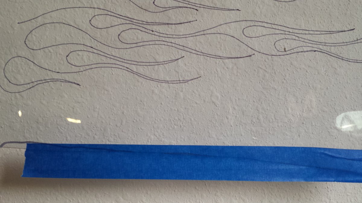

    Check out my photo in the first post of this thread. I took the clear vinyl and laid it onto the screen of my laptop and traced the flames on to the vinyl.
