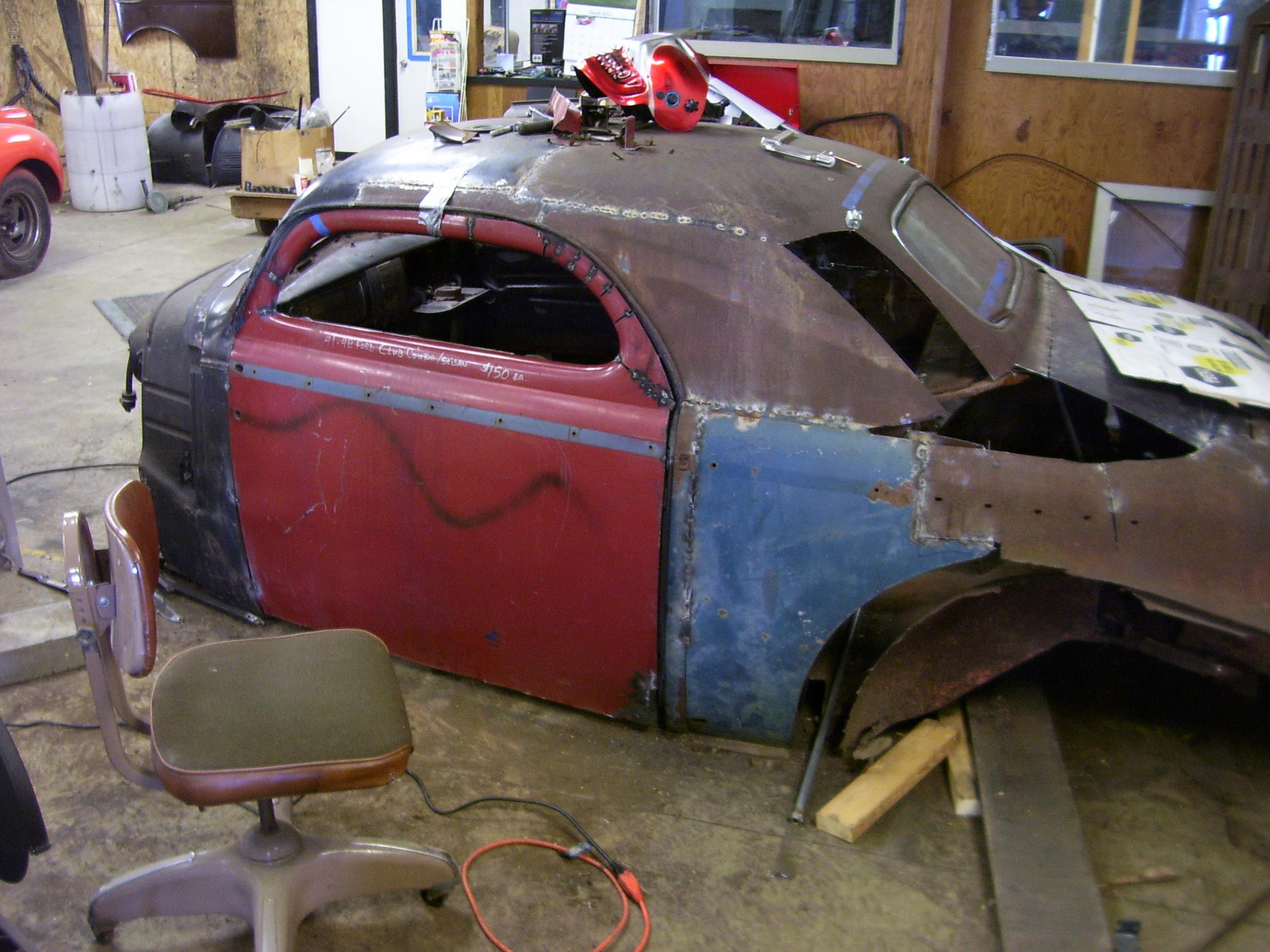

    Got the window frames together
      490.5 KB
      445
      491.4 KB
      460
      492.5 KB
      455

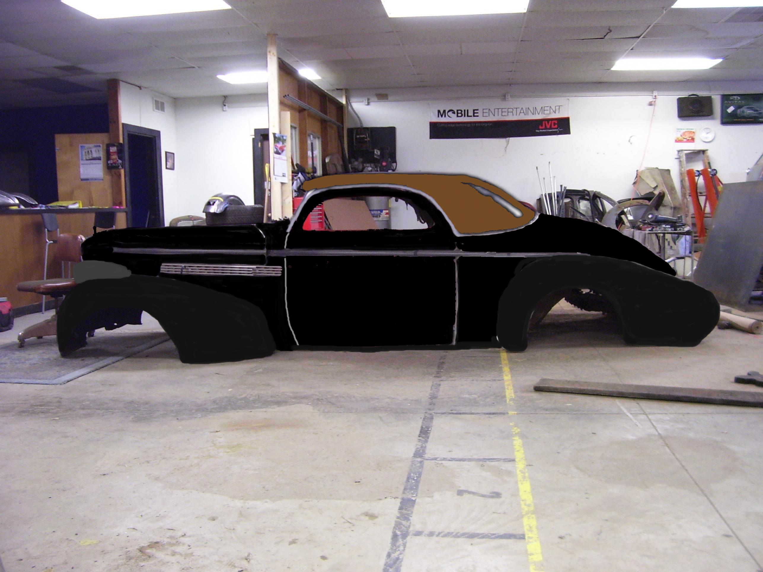

    adding a beltline and filling in the holes

    do you plan on running that beltline up into the doors as well? what an undertaking... makes me want to set my shit on fire and watch it burn :eek:

    Q. can you run the belt line up at the door and let it become the drip rail? that would be wicked custom. then you wouldnt need and more detail on the doors.
    Just an idea
    Godspeed
    MrC.

    I'll play around with that idea but I do think either way that I should bring the beltline into the door so the door looks like it belongs to the car

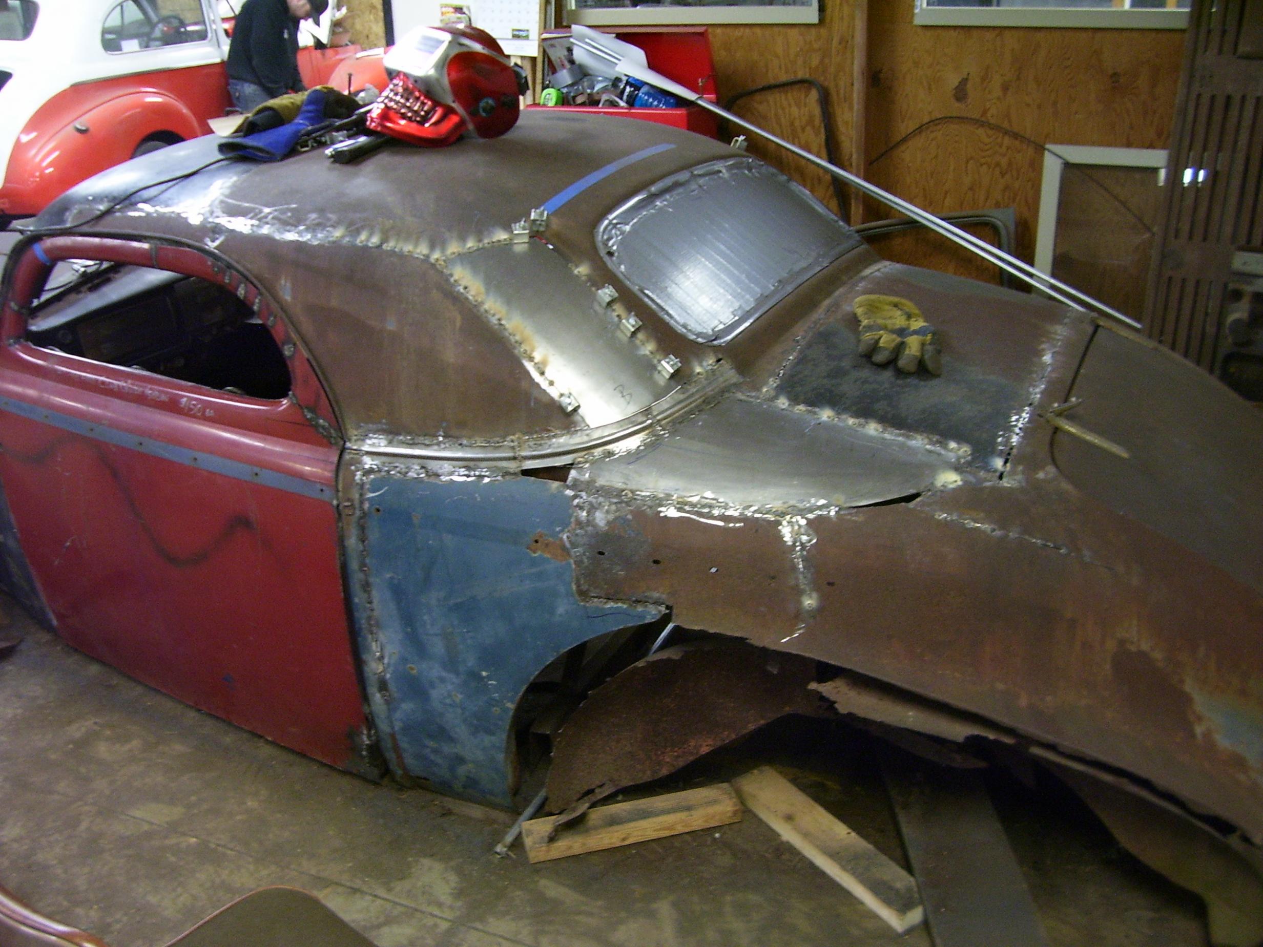

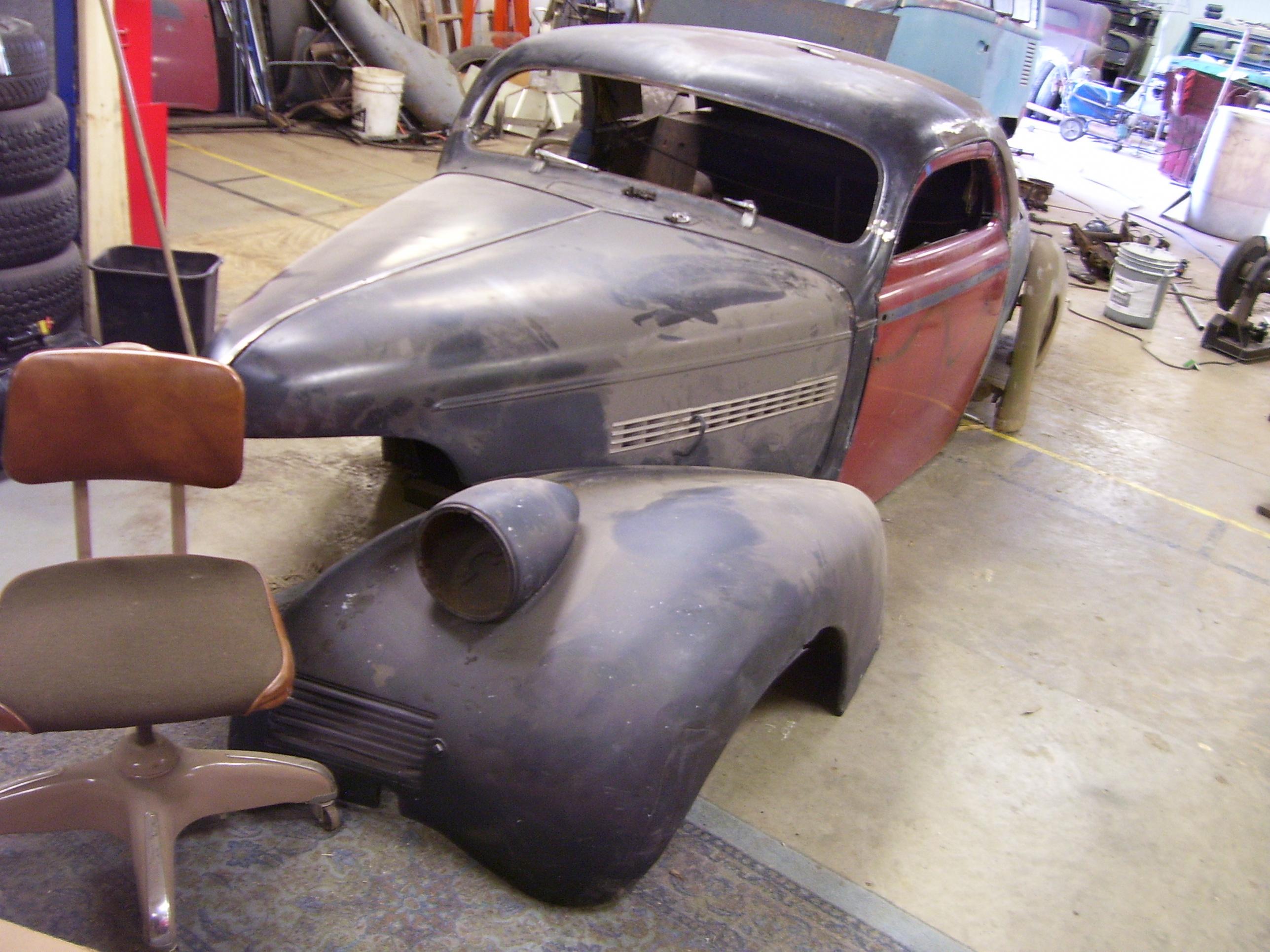

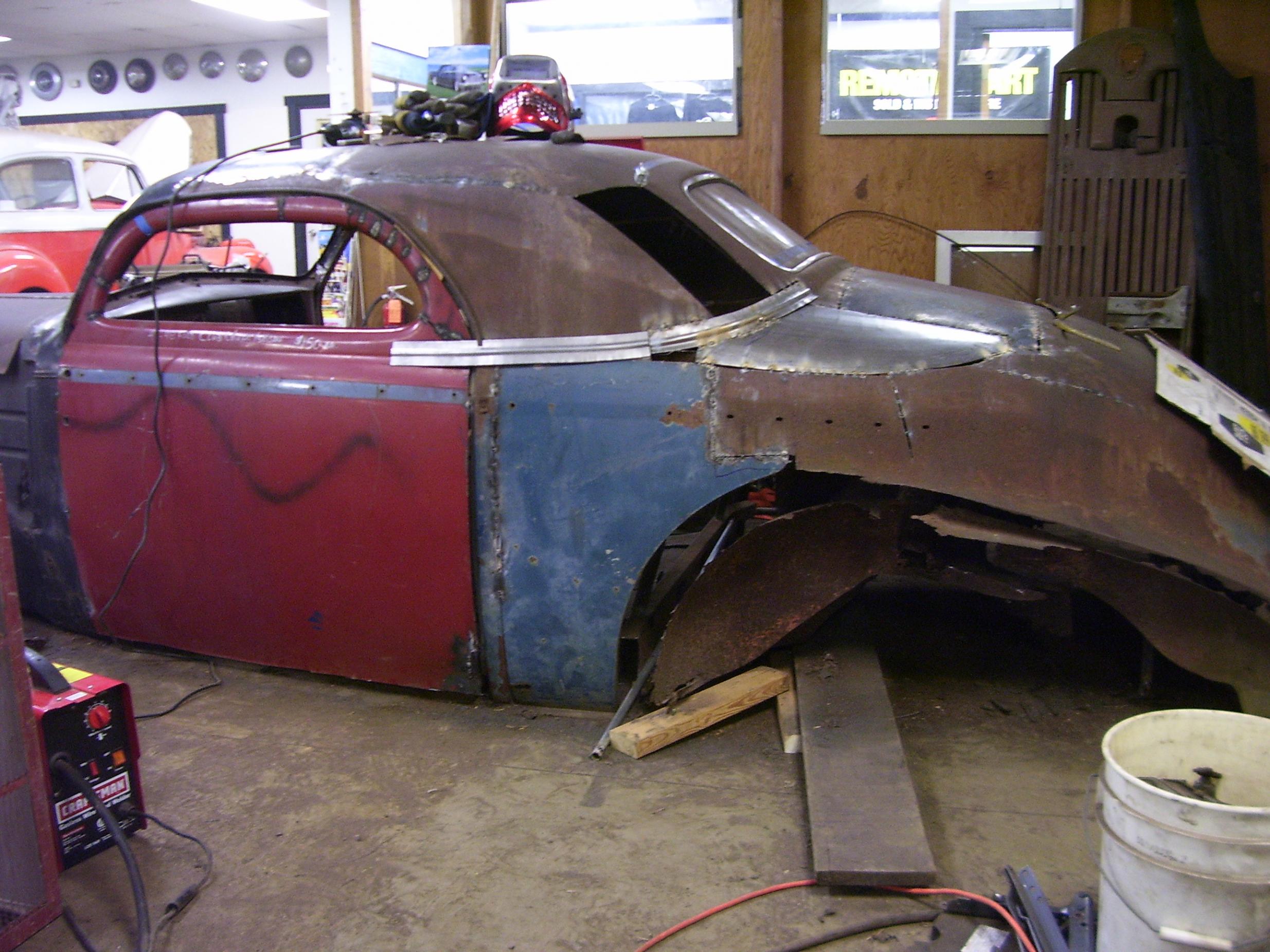

    A few more update photos

    Well I looked at the car and I think that might be a good idea. I'll have to make the beltline larger to make it work but I really like this idea

    The reason I mentioned it was because you could keep the front body line that already continues onto the doors, and add it to the rear of the car and follow the curve of the trunk, then take the belt line and roll it up above the doors you would have 1 body line and 1 roof line, it would give the impression of a removable top ( one piece ) and a natural break for a 2 tone paint job.
    Please forgive my photoshop job its sux, I took the liberty of extending the chrome accents on the front back to the cowl area made it alittle longer.

    I like the crafstmanship and ingenuity... my recomendation would be to loose 1.5 inch or even 2 inches right behing the door/b-pillar on each side and 2 inches in the roof (lengthwise). Then it looks like the door curvature would follow the roof line. Cool though!
