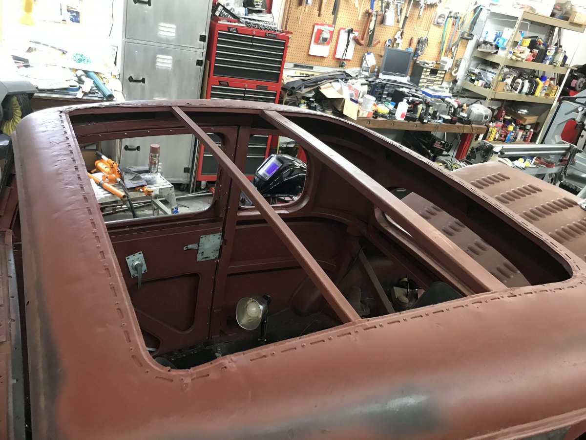

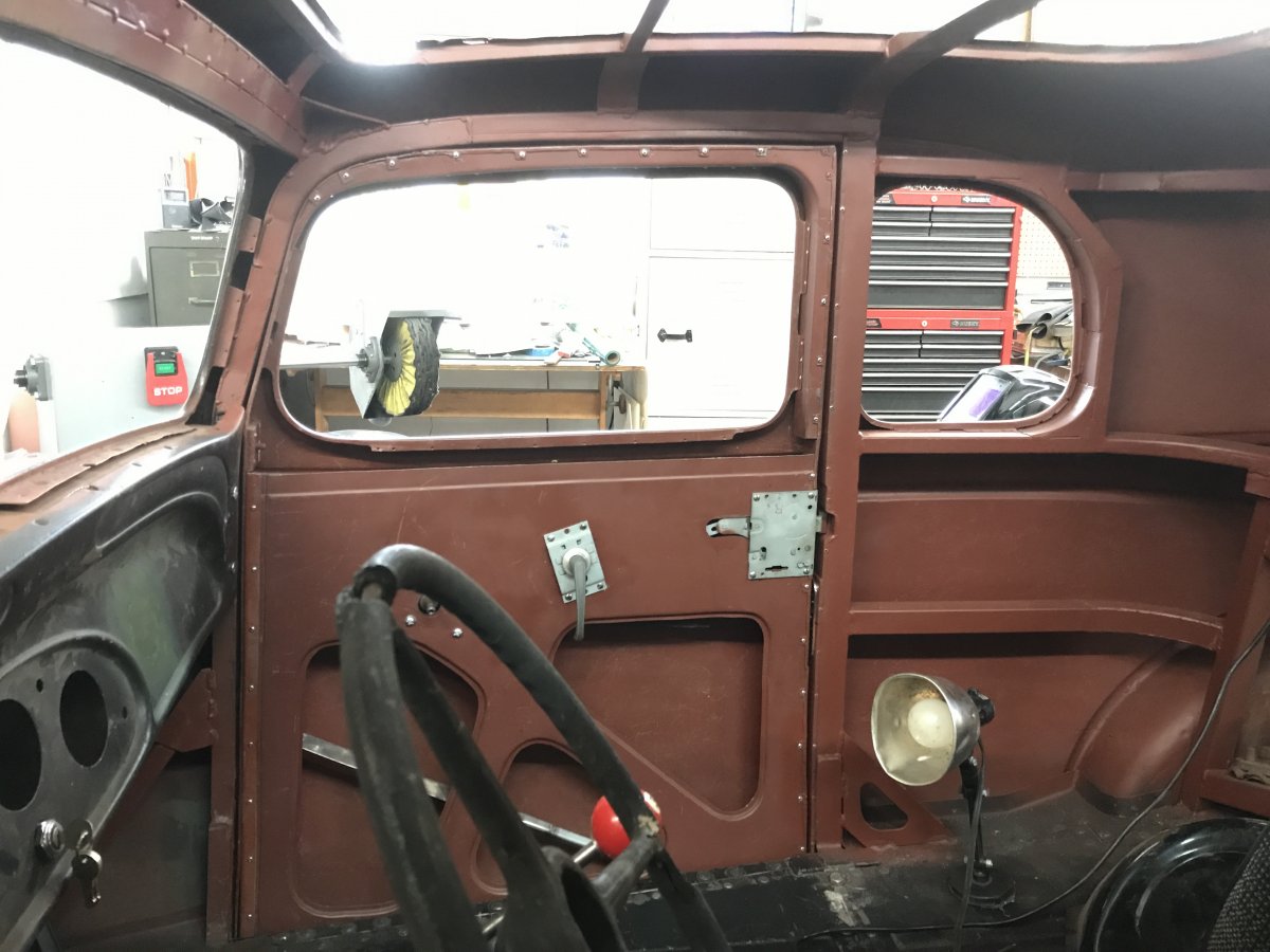

    I took the wood out. I replaced it with steel. Here are two pictures of my 1933 Chevy 5 window coupe.
    The top will be fitted with aluminum

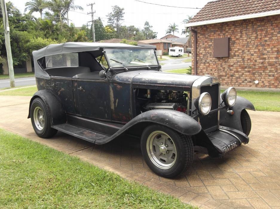

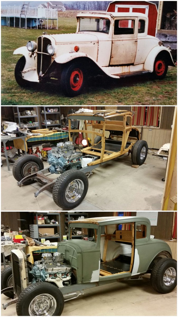

    1. All Things Pontiac
    The wood kit I got for my ‘31 Pontiac was made from white oak and ash, same as GM used originally. I’m told that they are the least likely to warp and twist.

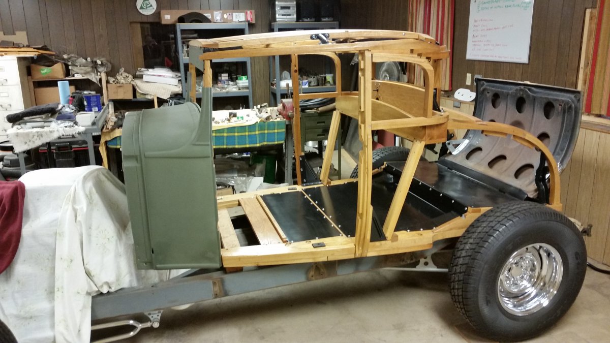

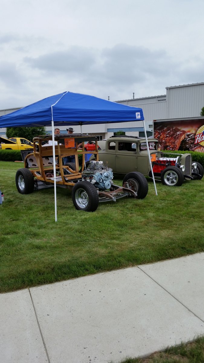

    Pics of my ‘31 Pontiac. Wood kit from Jim Rodman.
    Big mike 1968, GuyW, TFoch and 7 others like this.
  12. Wow, that is some absolutely beautiful work by you and Jim. HRP
    Jim made all of the wood. I coated each piece with System 3 clear epoxy to eliminate expansion and contraction due to changes of humidity levels in the wood. End grain especially wicks moisture like a sponge. I then assembled the wood structure and nailed the sheet metal to it.

    our pic`s 016.jpg our pic`s 017.jpg JelliPups5179 020.jpg For the Roof opening on my 33 C400, I first used 5/8" square steel tube welded to the perimeter, then Formed . 1 & 1/4" Sq. steel Tube where the Original wood above the Doors used to be . then cut the top out of the 5/8" tubing for the weatherstrip to fit down into .
