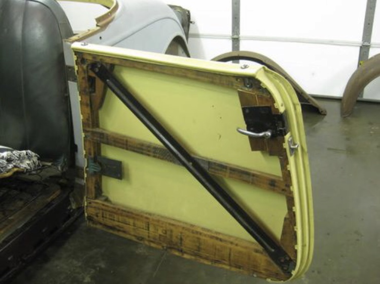

    I know a guy that build a '33 chevy, kept the wood and replaced what was needed. After a few yrs on the road it started settling and bowing the floorboards, to the point his doors wouldn't line up. Sad deal, it was a gorgeous car with very nice paint.
    I'd go with steel where it's structural, and if you want to have some wood for nostalgia sake keep some of the wood in non-critical areas.

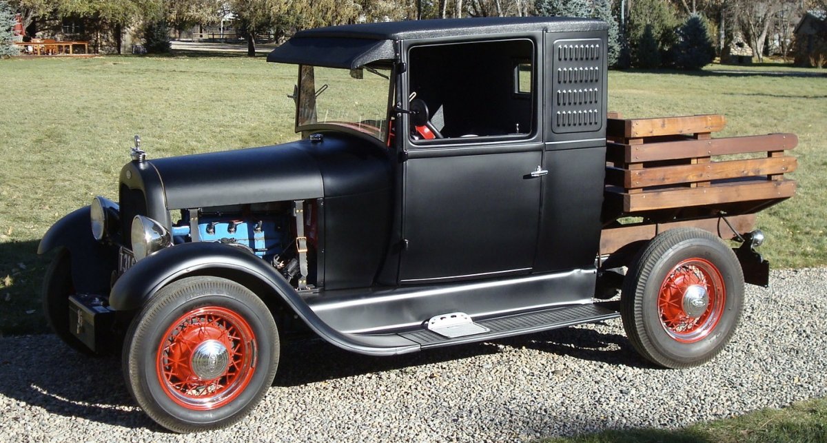

    My '29 Steelback project started with the rear section, I collected the doors and cowl, a wood kit would have been around $2,500. Think the top was an additional cost. I decided to buy a 1931 Ford Slantwindow 4Door body (ALL STEEL) and swap the '29 Cowl & rear section. Good idea, just lost interest in the project. Bob

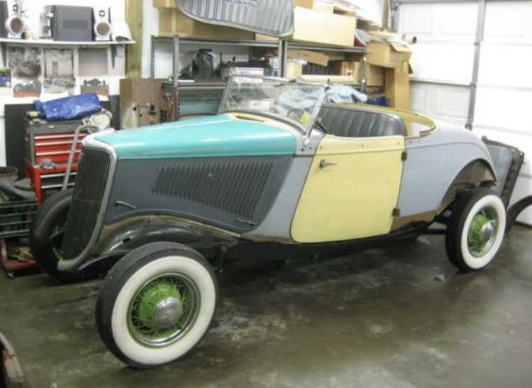

  8. No wood left in my 34 coupe body. I fabricated a lot of the back glass/trunk hinge/ rain tray structure and used a 36 ford coupe roll-down back window......they were all steel.

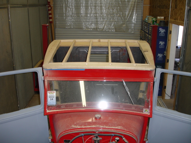

  17. On my current '30 A project the original wood was toast , so I went with a roof wood kit by Classic Wood in Greensboro NC. By doing so , it located my "B" pillars correctly. I've used Brookville subframes and they were not drilled for door post attachment. Made it a whole lot easier to hang the quarters and tulip panel also... Kit was spot-on as far as bolt holes ,bracket holes fitting, etc. Saved me a ton of time ..

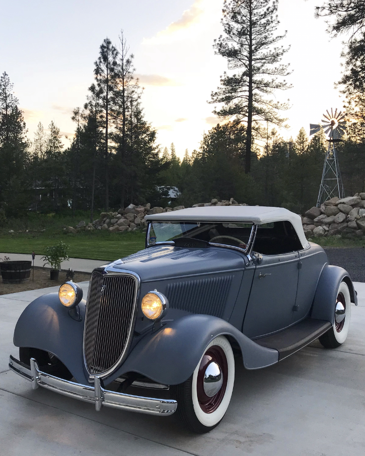

  25. When I bought my 34 roadster one of the most appealing parts to me was the wood was original and beautiful. The owner before me removed all the wood, chemically stripped the body and reinstalled it. It's still in the car.
