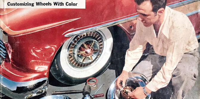

    Jive-Bomber submitted a new blog post:
    Wheels of Color

    It wouldn't stay on chrome plating HPIM3960.JPG - it was clear lacquer with some toner added. He did sell a lot of it in bomb cans with his picture on it ...

  4. I tried using "Color-Chrome" paint on my 60 T-Bird, looked great for awhile but didn't stand up to daily driving very well. Didn't seem to adhere to the chrome and looked pretty sad.
    Mick
    rotten ron, loudbang and drdave like this.
  5. Seems like anytime I paint anything in the shop and get some on chrome, it's a pain to get off. Maybe if I pretended to paint some candy on something else near my hubcaps it would stick and look good. LOL I really like the look and think it would be cool. Wonder how today's candies would do so far as sticking to chrome and holding up to daily driving.

    Yeah, I've always found the only way to make paint stick to chrome is to NOT WANT IT TO.

    Many hubcaps of that era were actually polished stainless and would accept paint fairly well. The big three all had hubcap designs that were accented with paint. Chrysler used a translucent gold, solid blacks and reds for years on their Desoto, Plymouth and Chrysler lines. Great look. Would love to see it executed now with newer style custom paints.

    Painting chrome or stainless requires careful prep similar to bare steel or aluminum.
    If you commit to painting chrome or stainless then sand it with 600. Depending on the color desired a very light coat of etching primer would be a good idea followed with color. The color coats should be kept as thin as possible.

    I have powder coated stainless in my home garage with great results. It's in the prep.
