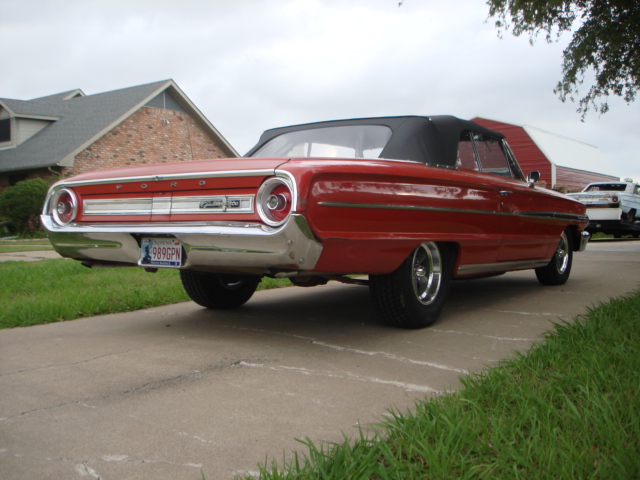

    I have the front on the way and was about to order the rears. Anyone know if a 15 x 8.5 3.75" backspace Torq Thrust D on the back with a 275-60-15 fits? Doing some quick measuring it looks like it will but wondering if anyone has used that size without issue before I place my order.

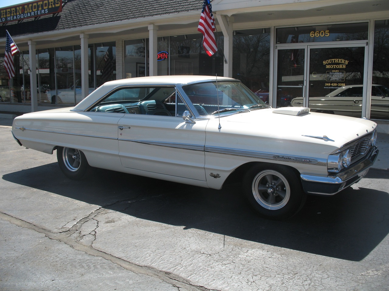

    Looks like I may be able to skate by. I found this car on line and he lists 275-60 on the rear. This is the exact look I am after.

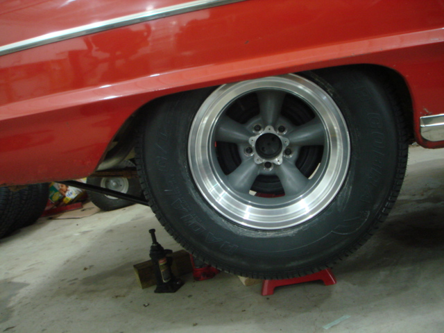

    Took a couple days to sell the other wheels and got the new Torq Trusts and tires 225-70-15 and 255-70-15
    Its the exact look I was after and looks killer on the car but its just too close on the outer wheel houses in the rear. I now have this set up for sale and 5 spoke Hailibrands on order. I wish I had seen the Halibrands first because they make multiple backspace and are running a special so they are not a whole lot more than the TTD's were.
