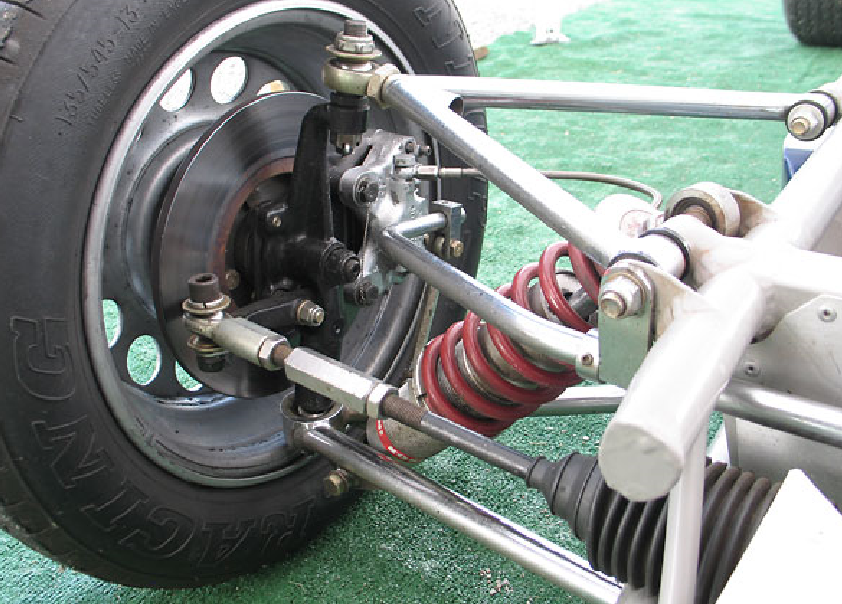

  9. Mimilan
    Joined: Jun 13, 2019
    Posts: 1,230
    Mimilan
    Firstly,
    Do not use the Chinese knuckle/spindle. They will bend or break with an ATV.
    Hunt down a pair of Triumph Herald/Spitfire knuckles. They were the choice of early Formula Ford constructors [McLaren used them on the M1 CanAm racer]
    Here is an example on an early 60's Formula 3
    Note the stub axle can be removed from the forging [making it easier for custom applications]
    That Heim joint only adjusts camber [bent stub axle correction:D]
    To alter caster you need to adjust the balljoints longitudinal.
    Lola did a Cheat/Simple method with stack-able washers on the upper A-Arm brackets.
    If you are using this for competition , the IFS wins hands down.
    But the simplest easiest way to lower your car .....is to machine up some kingpin bosses and make a custom drop tube axle in a jig.
    [A frame 3 link it ,if you want good handling]
