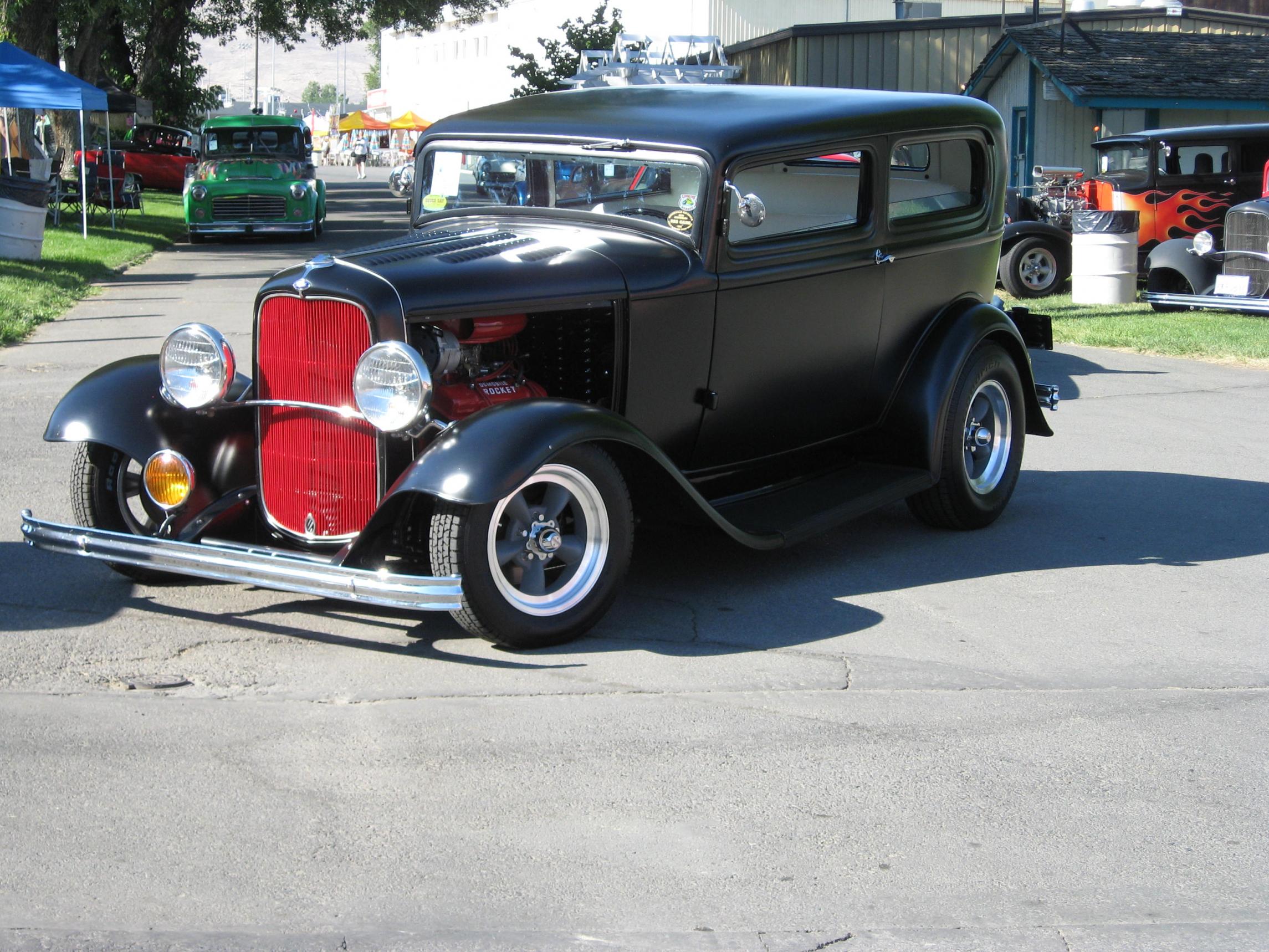

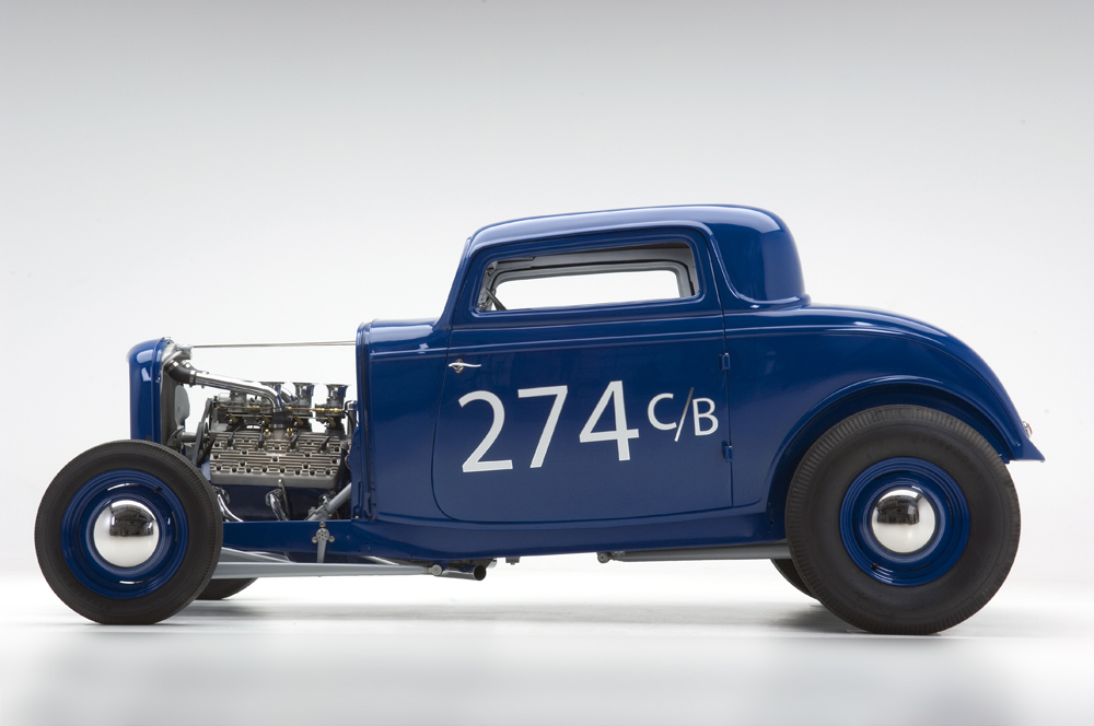

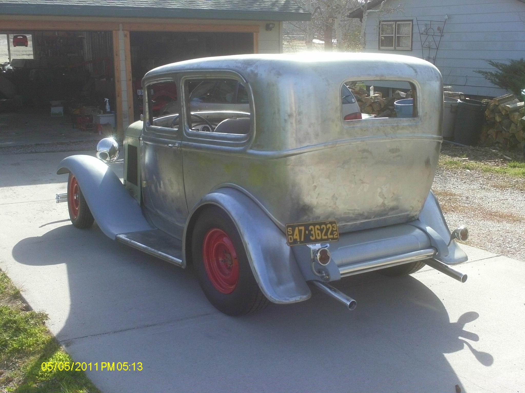

On a fenderless car, the rear wheel arch basicly sets the rear height, well atleast for me, there should be the same amount of reveal around the whole tire regaurdless of diameter. I kind of like a heavy rake (jack rabbit like) it kind of makes the big little tire contrast more prounced. We all have diferent tastes and to quote a saying I have seen posted here a few times "how long is a rope" there is no PERFECT rake. Here are a few pics that I think are a good rake.
