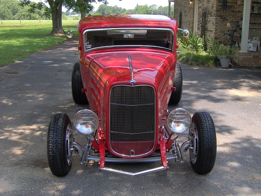

    Two of my favorites. Both totally different....both totally awesome!

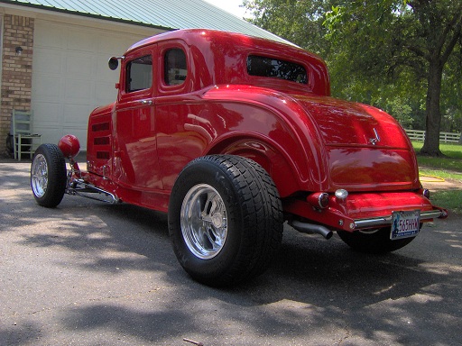

  20. I used a original frame but replaced the front cross member with a model A,,that gives the car a one inch drop,,I used a reversed eye spring and that drops it another inch add to that a 4" dropped axle and it totals up to 6" lower in the front.
    I used a reverse eye transverse spring on the rear without modifying the cross member.
    The tires add to the rake,,the front tires are Coker Classics,560-15 (25.88) diameter & L78-15 (29.30) diameter on the rear,,,,5x15 & 6x15. HRP

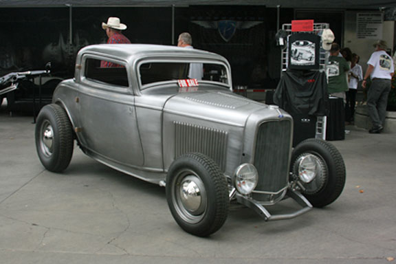

    In degrees, it seems like as little as 4 to 5 degrees would be good. Of course, wheelbase has to be considered. My T's wheelbase is 108" and the rake is about 5 degrees.
    Maybe someone can post some side views of 32's and you could measure a rough estimate.
    The pic above is about 5 degrees.

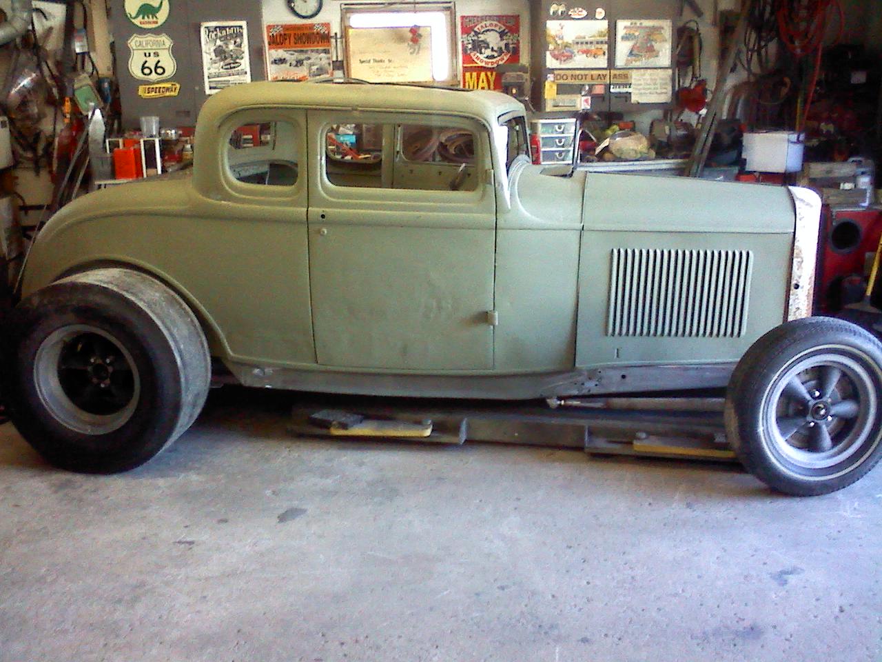

    Here ya go. Strraight side view of mine.
  28. A little lower in the back.

    On this car, accounting for the picture and using the main body line as a point of reference, it seems to be minimal. Like.... 2-3 degrees. But that's going by a pic on a monitor and the slight angle in the side view. That pics not a dead-on side view. But I think you see what I'm getting at.
