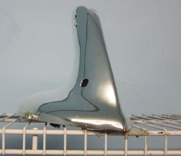

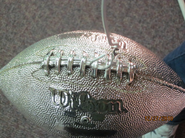

    These pieces were done the the spray chrome
    www.ichromefx.com

    There was segment on Leno's Garage that showed the process.
    They did some pot metal and it looked good.As usual prep is the word.
