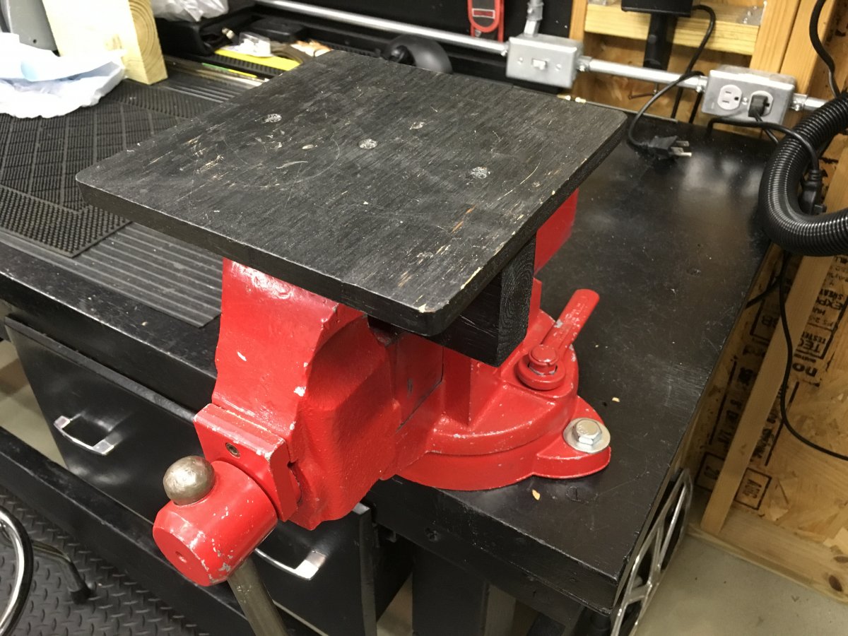

    Take a scrap of plywood and screw it onto a section of 2 x 4. Place In vise as in picture. Gives you a little extra height so you can see better and also you don’t have to bend over when working on small jobs.

    Get a door mat with little rubber post sticking up similar to mat on left side of vise. When you are taking apart jobs with small parts, small screws, springs the parts get caught in the mat rather then rolling off work bench onto the floor. Door mat also will contain some fluids so work bench stays cleaner. You can clean mats with hose or just throw away. If you know any one in the bar/tavern business bar mats work even better.

    Make the same piece out of some quartyer inch or thicker plate and you will have a small welding table/fixture.
