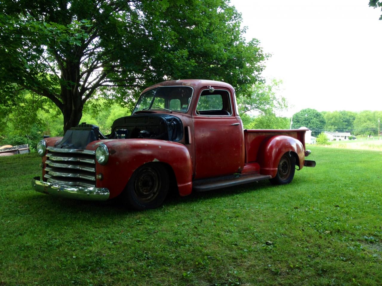

    I'm running 205 60 14 on the front and 255 60 15 on the back right now but will go to 215 75 15 all around when it goes back together as I'm going from the 80's hot rod truck look to a low but fairly level custom look this time.
    I think this tire is a 215 15.
    With the 205 14 on the front
    195 or 205 14 on the front and N 50 14 on the rear in this photo.

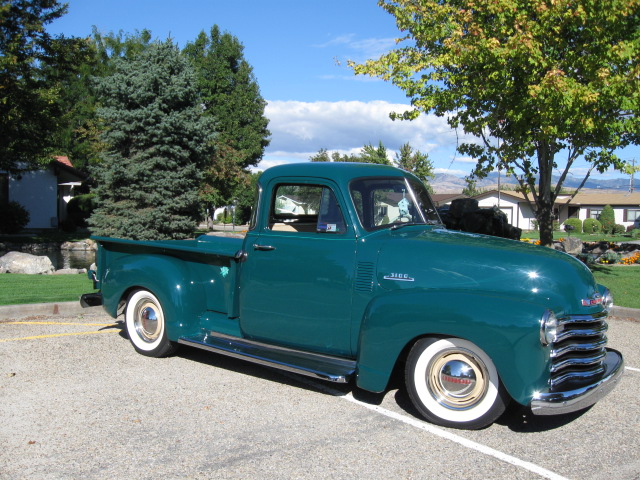

    These are 215/75R-15's on later 15" truck rims.

    The rims are mid to late 60's 6-hole truck wheels, (same pattern as the stock AD wheels) 4" backspace which is a bit much for the front (puts the tire too close to the tie rod ends) so I run 1" spacers on the front. They are perfect for the back since I've got a '68 truck rear end in there with 3:08 gears and it's a tad wider than the stock rear end.
