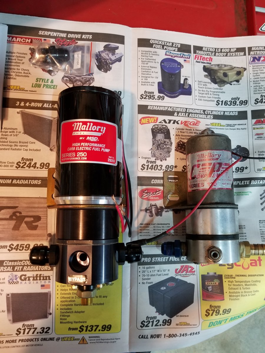

  1. I've had real good luck with Mallory pumps, they are of the gyrater style, easily taken apart and cleaned if need be, just a rubber O-ring that seals the two halves of the body.

    Mallory is out of business .Owned by Holley..

  10. Did you miss every link I posted said Mallory or the big fat sticker that says MALLORY right on the pump I just bought ??? If your contribution to this post is trying to correct someone at least try and get that right.

    Mallory
    By MSD
    right there on the label .
    Yep , I see it !!
    Thanks
