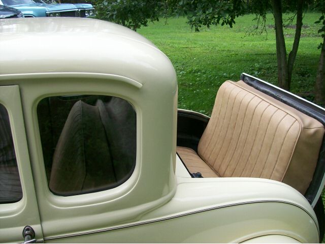

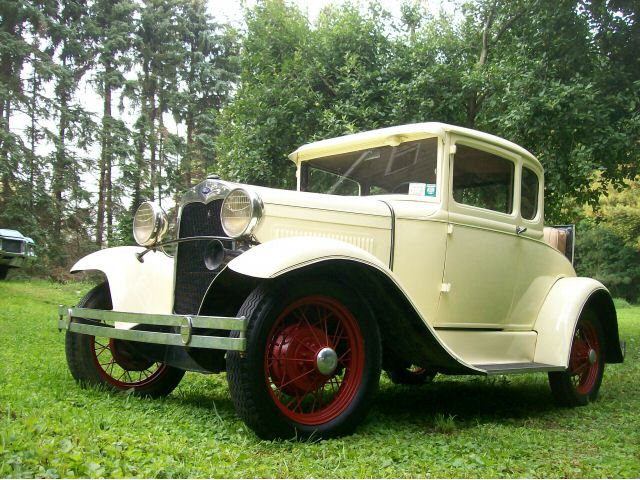

    Hi fellow brothers and sisters. I'm on the crossroads here. I'm bidding on a 31 ford 5 window that looks like it was pulled out of cold storage for the last 70+ years. Stock Stock Stock, re furbished about 10 years ago, cream yellow, and according to the owner who I've spoken with several times, It drives like a cream, still has mechanical brakes, has new water pump, new battery, starts right up, gets driven about 3 times per week to dinner, etc.. by the owner and it was re painted no bondo, etc.. 10 years ago, it's in Northern New York, I think Western? ABout 60 miles south of Buffalo. I'm interested in the car, But if I win it, I'd like to make it more drivable on everyday trips. I was thinking the following for this Stock 31.
    350/350, new Radiator, 12 volts new wiring front to back, interior stock looking gauges new rear end, and new Mustang 2 style front. Keep the rims and tires if possible, keep it looking super stock, except for maybe a wee bit wider wheels fill those fenders a bit more. What do you think? it's on that evil site right now, only 2 days left. But the price is super low I think, Less than 9K
    Of course this will mean another crazy adventure of me flying up with a bag of tools and driving her back, SLOW!!!!! and only in the daytime!!!! I'm not falling for that (she's working fine") trick, LOL!!
    Thanks for your help folks..

    Seems strange they filled the top with steel, but left the mechanical brakes. You get it cheap enough you could build a neat little hotrod without touching the body. Just build a frame and swap it out.

    Ahh good thing, didn't realize that, the top shouldn't be filled that way should it? Thanks Dyce

    You'd perhaps be surprised how 'drivable' and how much fun an 'enhanced' Model A can be. Check out the monthly 'banger posts here, and also on Fordbarn and Ahooga mb's for hints on keeping one looking original and driving nicely. An aside, it already looks like a street rod with the cream paint. All A's originally had black fenders, along with a broad array of upper body and molding colors. the cream paint could be a factor in depressing the purchase price a little -- not original, and not really a rod with the 19" wheels. (I know, "it's your car you can do with it what you want") Also, you can get 3.54 gears in a Model A rear axle, but with an overdrive it seems to like the original 3.78s. You'll also want to go thru the brakes thoroughly, to eliminate any slop and free play from the mechanical system. Lots of Model A guys (me included) prefer the original mechanicals over a cobbled-up, poorly maintained hydraulic system that was done who-know-when with questionable parts. My coupe with mechanicals can (and had to, just last week) lock up all four at 40mph when needed.

    The roof should have a cloth insert, plus the radiator shell is a 1930 and not a 1931.......
    Mechanical brakes work fine if adjusted properly. Ford Motor Co. didn't offer hydraulic brakes until 1939 and the '32-'38 cars were larger,heavier and ran V8's...The brakes will work as well as your brain will allow. The way some guys drive, 4 wheel discs aren't adequate enough.......P.S. That's not a stock '31 Model A color.

    Anyone that would paint a stone stock Model A that color is hiding something. Fly up and inspect the turd first, plane tickets are cleaper that a car project that sucks money out of you every day you own it.

    As far as rodding it...the top is already filled and it's not a stock color, so I say have at it. I'd also take those two conditions into consideration as to just how clean and original the car is. A guy who wants a stock car won't want it, so you might get it at a good price.

    Just to add, I'd look for evidence of rust, being in NY
    This might be why the top was filled.

    Left front fender is bent, drooping down in front. see it in the second pic. On a MINT car the fenders and aprons should be Black, not body color. tha holds through 1932.
    It is a '30 radiator shell.
    Car has lot of wrong parts for a high dollar so called
    Mint" car. (Or is that just your description?)
    From where it is located it could be mostly Bondo too.
    Check it out in person.
