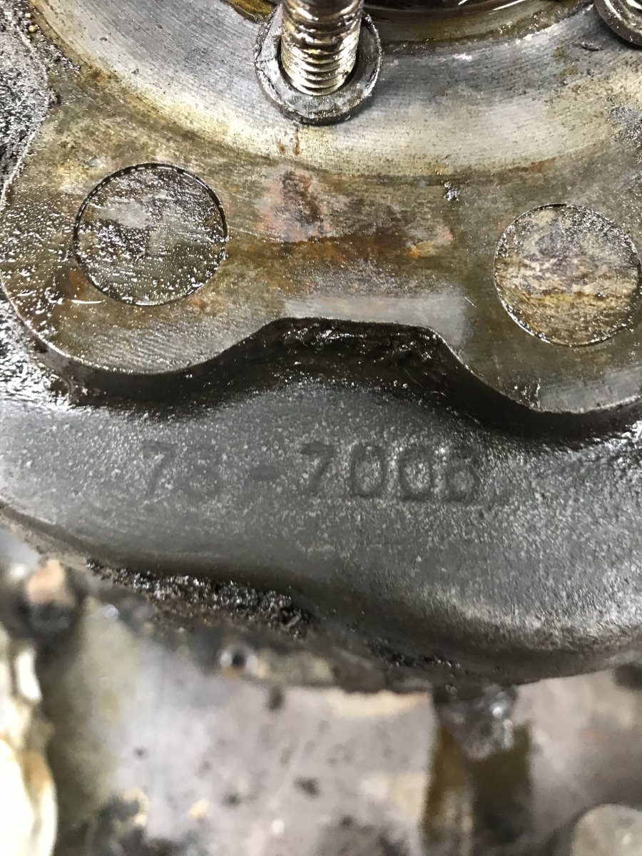

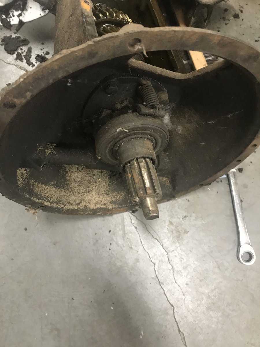

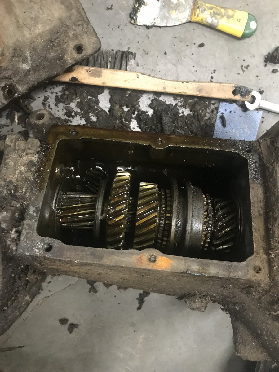

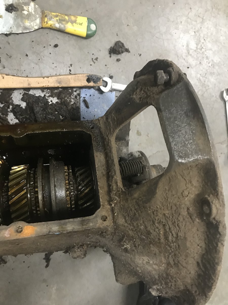

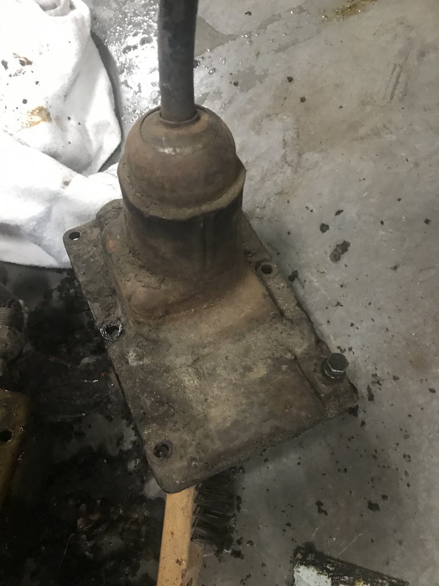

Need some help to identify the year of this transmission. The only numbers I can find are on the last picture. I’m hoping to use this behind my 241 hemi for my 32 coupe. Please let me know what I have here, I am not a transmission expert but found it close near by and the price was right.

So, it’s got the ‘39 and later gear set with the good 2/3 assembly. It’s also has the “78” case, this will take all clutches. There is a VIN number over the opening in the case, you cleaned it up some. That will tell you the year of the case. VIN lookup here, http://www.vanpeltsales.com/FH_web/flathead_serialnumbers.htm There are some numbers on the shift cover also, clean them up. How wide is the 2/3 shift fork, inside of the forks. Got a pic of the rear of the transmission, mount and such? Cliff Ramsdell

Everything you ever wanted to know about early Ford 3 speed transmissions is right here on our website. Breaks it down into various categories. The photos of the shifter housing that the OP shows don’t make it clear if the shifter tower is the 36-38 type, or a 39 housing. He can figure all this out from the links: http://www.vanpeltsales.com/FH_web/flathead_transID_3speed.htm
