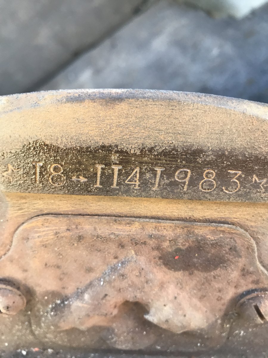

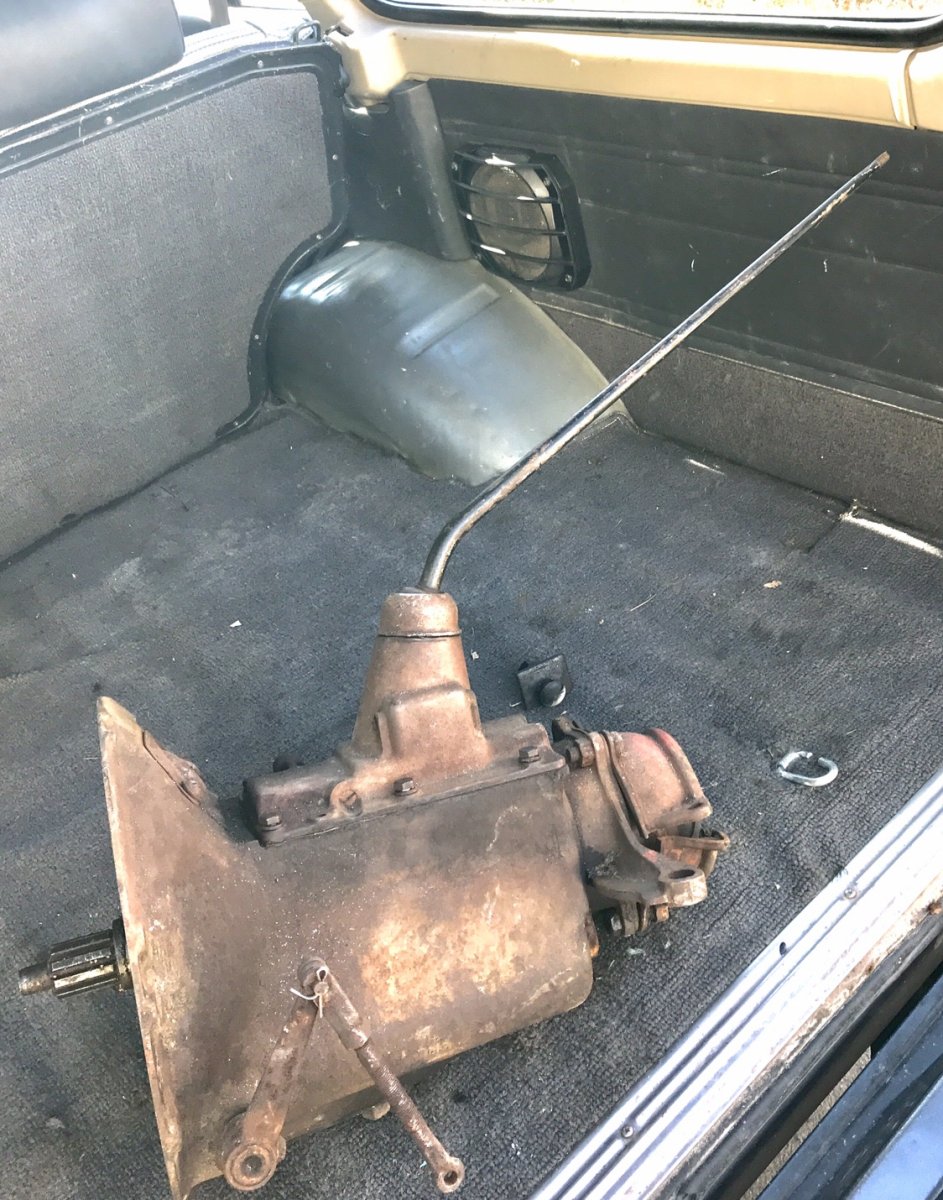

    562D5C5E-E58F-4BEE-8CA4-1B4DB9E602AF.jpeg 4888F81B-F09B-4A3B-95D7-5B6B0CFE9DF8.jpeg Hey people! I bought a top loader for my 26 roadster project. I was told that it’s a 39 or earlier “maybe”,can someone please help me remove the “maybe”..thanks

    According to Van Pelt Sales that is a 34.

    Well, I would pull the cover off and look inside at the gearset.

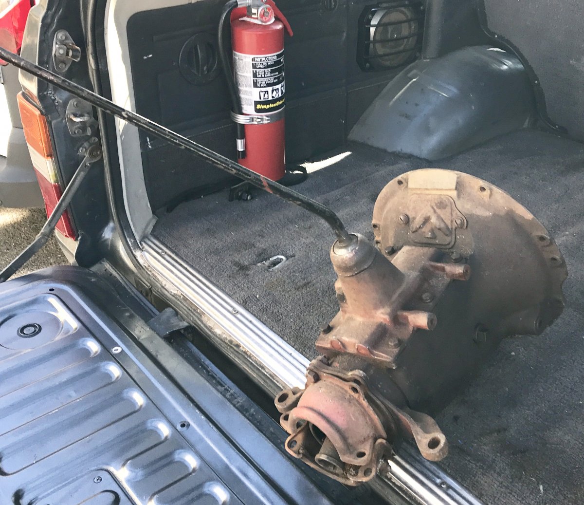

    The VIN, as pointed out says ‘34. The shift cover is a 32 cover, it’s the only year that had the two boss’s for the parking brake assembly.
    The rear mount is a ‘37 and later, cant tell the year, measure between the mount holes to determine the year.
    A pic of the other side will show what clutch shaft you have along with the lever, if applicable.
    The transmission looks like a buildup of what was around. I have used the early straight cut gears, ‘32-‘35, with no issues in my AV8 just don’t drive it like a race car.
    Open it up, snap some pics and post them along with a shot of the other side so we can see the clutch shaft.

    Thanks Cliff,it sounds like it’s a Frankenstein transmission but it’s all I have.I did check the gears inside and they look great.

    So, the gear set is a 32-35 set, straight cut 1st and reverse.
    Send a pick of the other side where the clutch shaft goes into the case to see if you have a 32-39 or 40 and later shaft.

    Looks like a '32 clutch arm also.
    Should be just fine in your '26 car just don't beat the death out of it.
