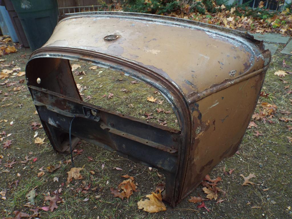

    I think it’s just a style/design question. As per the photo, the cowl is a stand-alone unit, located behind the hood, and in front of the front doors. I have collected a handful of model T and A cowls. 32 Ford had a cowl. After that, they started to disappear, as stylist started to blend in the design elements. It could be argued that most manufacturers had moved on from the the “cowl” by the mid nineteen thirties.

    This is what you're wondering about. I took the liberty of cropping the images and combining into one.
    This cowl is one piece...now...but it's made of more than one piece. The firewall is probably spot welded to the body panel(s), there might or might not be a seam at the reveal line, below where the top meets the sides.
    So....are you asking when they started making cowls like this? or when they stopped? or when what specific design feature changed?
    I'm confused, too, still.

    I'm not quite sure what you mean by "that way". The major change was when the fenders became one piece, and met the door, so the cowl "disappeared". Is that what you mean? If so, it started happening around 1940 or so, depending on the car make. Hoods got longer, and covered more of the cowl, and fenders changed shape considerably as the grilles began to get wider, and the hoods got wider. By 1949, cowls were completely gone on most cars, although they stuck around on pickup trucks through the mid 50s. Big conventional cab trucks still have cowls, look at a new Pete 389.
  23. Are you thinking RHD because of that hole in the firewall ? Thats to high for a steering column, probably from a manifold heater.
