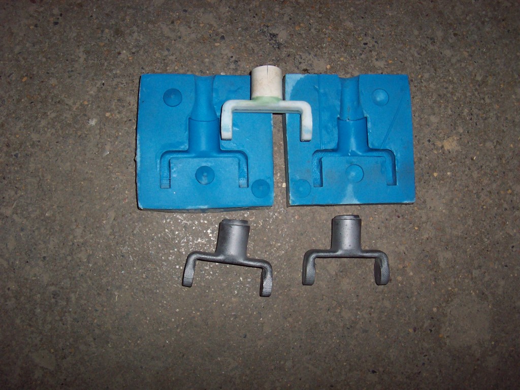

    I hired a company to 3D print patterns for cast parts. I provided the digital measurements to them. 1911 Excelsior Autocycle Twin frame brackets.
