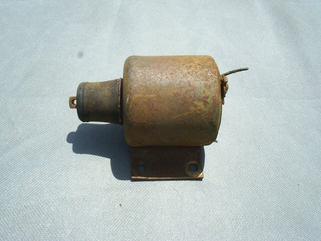

    This popper came off the trunk lid of my 51 Merc.The doors have the same kind.My merc was built in the mid 50's.
