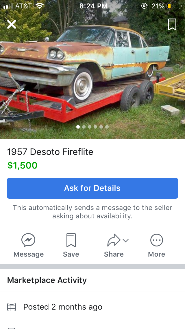

  26. Here are 3 near me for sale
    Might help ya with pricing
    9CB2BF3F-692D-4057-8033-CAA112DA2997.png 3B667B04-CC3D-4AD1-8B2E-848583C51A31.png DAF833C3-2C9E-4EF6-80CD-6F516DAFF007.png
