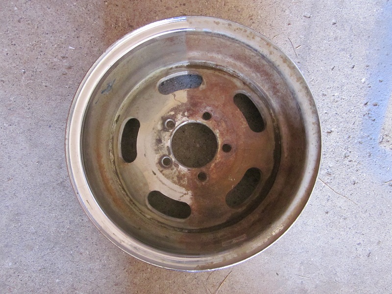

    I don't think there anything special, but the worse one has been ground on . Eastwood has an aluminum cast spray but the profile really isn't right for an aluminum slot look I don't think.
    The other wheel doesn't look as bad, but the one on the left was missing large areas of chrome.

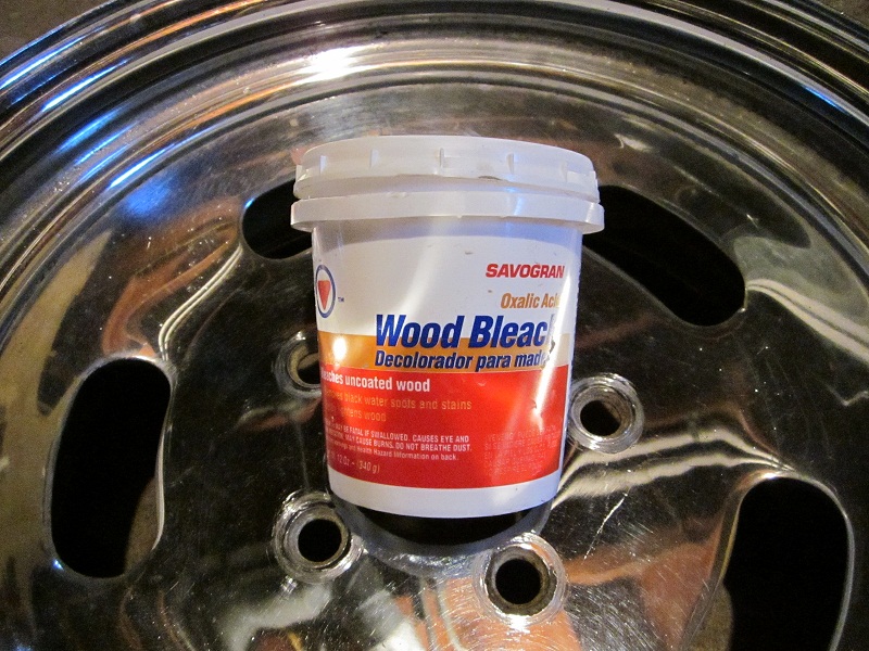

    Too late now, but I've had very good luck resurrecting the chrome with an Oxylic Acid dip. Third shot is of the backside, just to show how dramatic the effect is.
    There are quite a few center caps available, most center holes are 3.25.
    If you don't want to powdercoat, an antique bronze or cast blast type paint might look good.
    I have a set of new skinnys being built (4.5 width), I'm trying the silver powdercoat just to see how it looks, might try an antique bronze next set.

    I'm not familiar with this "Oxylic Acid". Do you use it straight or dilute it? Thanks!
  17. Phillips
    Joined: Oct 26, 2010
    Posts: 1,505
    Phillips
    Sold at the hardware store as "wood bleach". Very common trick to bring back plated BMX frames. There is probably a recommended ratio, but I just dump about a half cup in warm water in one of the large rubbermaid containers, big enough for two wheels. Let it soak for about 24 hours, clean of with a soft WHITE (kitchen) Scotchbrite. Anything more coarse will scratch the chrome and look like crap. Soak again if the results were not satisfactory. I then neutralize with a baking soda and water rinse.
