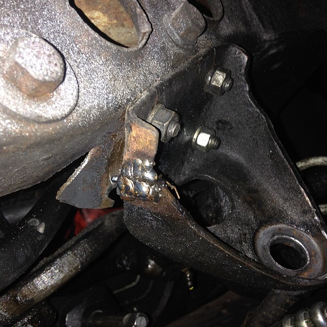

    I heard a bang under my car as I was driving it and the end of the power steering ram had broken in two, when I looked at the mount it too is not just broken but totally sheared upwards with great force. I had noticed a couple of years ago that were stress cracks there which I welded up, I hadn't looked underneath since then except when I replaced the power steering ram a few months ago. I have no idea what could have caused this. I'm going to replace the steering box with a 500 power steering box and be done with it.
    If anyone has this happen to them I'd like their input, thank you.

    Same thing happened to me about 10 years ago on my '60... Must be a design flaw of some kind, but I'm not smart enough to know what it is.

    Never gave a problem afterwards. Fred told me it was a common ailment on GM ram cylinder p.s. setups.
    Flawed casting and weak point in the frame he explained to me.

    The '61 has factory power steering also stress cracked the frame. After the cracks where stopped and welded, plates (to double the areas) were welded to the frame horn. Paper thin frame at the tip of horn along with all the holes made it a design flaw.

    Thanks for the replies fellas, I've had several 59-64 Chevys, but all except my 1962 Impala SS were manual.

    I think the 500 bolts on, but I don't suppose it would hurt to reinforce it.
