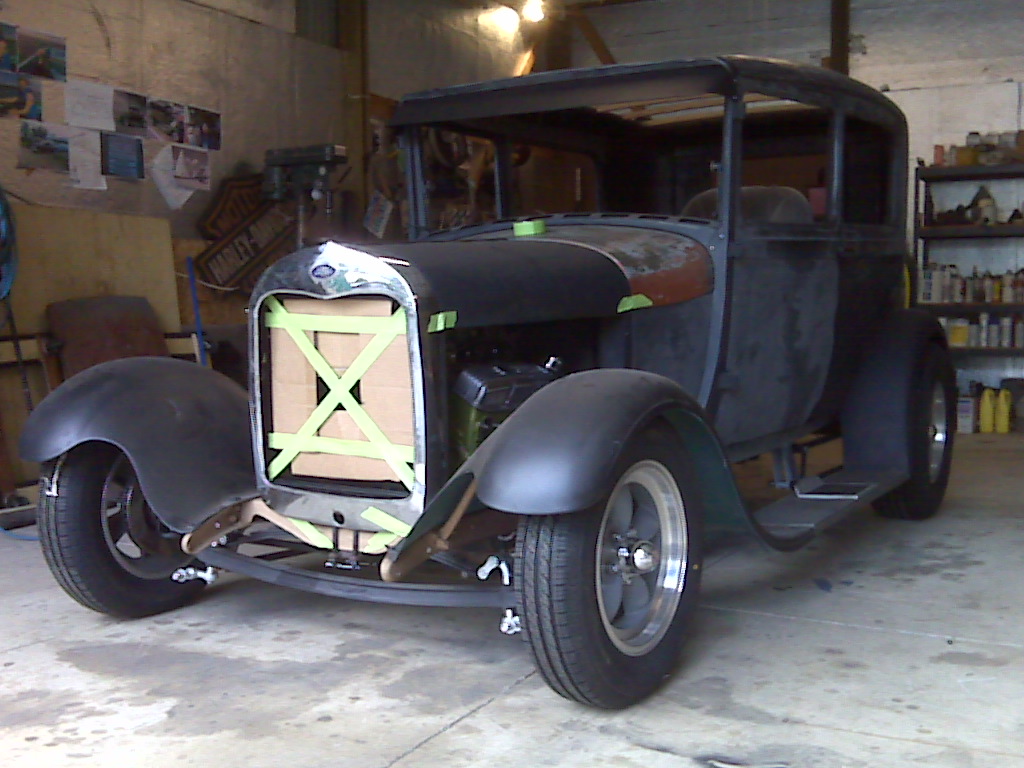

    cooper 185 80R 15..24.5" tall, nice tire..on my A

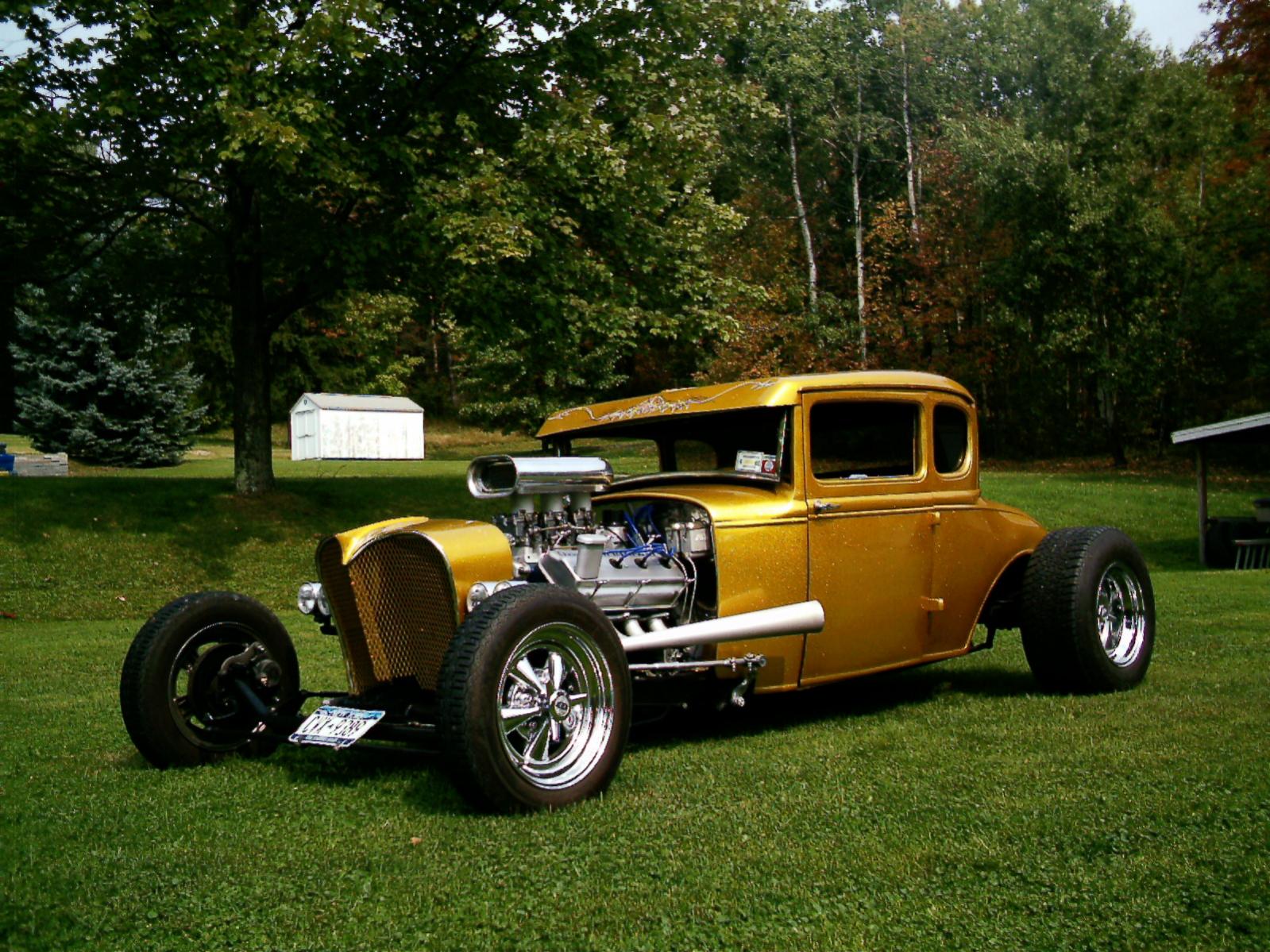

    i used tires from gearworksmfg and they worked perfectly on my model A truck and model A coupe - heavy blown chev and heavy 392 hemi - super tires, relatively inexpensive - fit the 4-4 1/2 inch wheel perfectly!..check out the pics...jb
