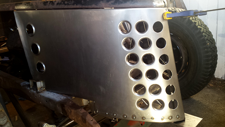

  10. For your purposes, 1.5" or 1.75" would be good.
    These are plain 1.5" holes (no dimples) in the grille insert and 2.5" dimpled holes in the visor.
    Hope this helps.

    Thanks a bunch, guys! It's looking like 1.5" and 2" are the hot sizes. Your answers and input have been VERY valuable to me.
    I just splurged a little and ordered these two sizes, so now this thread can sit around for the next guy who has the same question.
